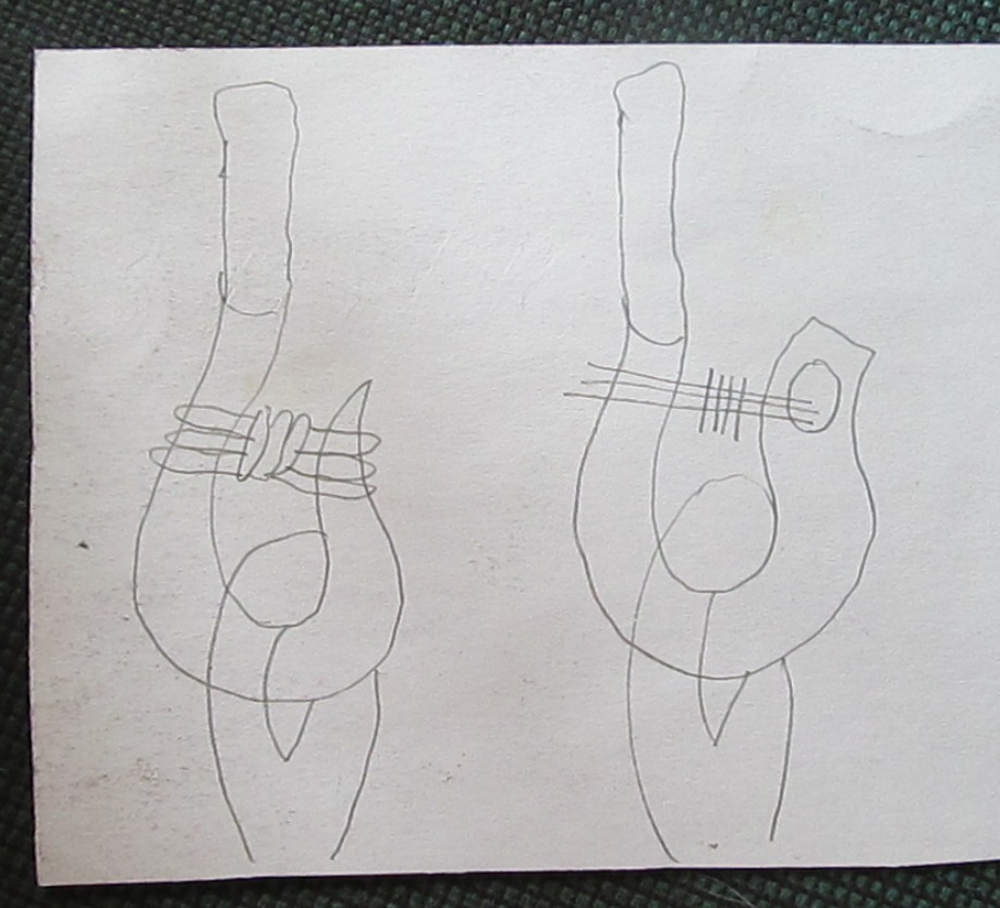

One question because I am wondering, that the two blocks at the top of the main mast were connected with a hook.
Would it be not to risky, that the block would get loose (hook move out of the ring) during sailing - because there is no easy possibility to climb up the mast by a seaman to refit the block with the hook..... just a thought
I think the risk is minimal, because the peak halliard is always under tension. Moreover, the hooks may be locked like this:
