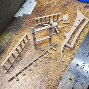

So I redrew a pin then printed a few. I took a few pictures with my SLR camera and will work on those tomorrow. But I grabber a couple of pics with this Galaxy tablet. Show here. I started with 25mm, then down to 20, 15, 10 5 and even 4mm. In keeping with scale tge 4 and 5mm pins are very small and the pins themselves, to scale are about as thick as a human hair. I do't know how you would ever wrap rigging around such a tiny pin. These pics do not show the smallest pins - I'll show them here tomorrow.20250213_192815.jpg20250213_192905.jpg
When I printed them, the problem was not in the printing itself, but in the fact that if the thickness of the part is 0.1-0.2 mm, it can deform and bend during the final processing (while raw) and break (after exposure), so you need to intentionally slightly increase some parts for reinforcement and for banal visualization, since very small details will not be visible on the model.
I wanted to come back to this. Parts can shrink and deform both during printing and post-processing. In my experience, most of the shrinkage occurs during printing and, if dimensional accuracy is critical, you need to play with the xyz scale settings in your slicer once you know, from a test print, what's happening. Be aware that shrinkage is not necessarily uniform, it depends on factors such as the object shape and design, orientation on the print plate, nature and extent of supports, even resin temperature, so you may need to make different adjustments for each axis. And of course this can have you chasing your tail.
I have found that it is best to process thin section prints immediately after the print sequence has completed. Leaving ultra-thin things to sit on the plate for a couple of hours, perhaps as a way of letting the wet resin drain off, can lead to distortion. Even the breeze from the printer fan can cause thin sections of wet resin to deform.
Parts can also deform during cleanup. I do my IPA wash sequence while the parts are still attached to the plate. Small parts are bound to get damaged if they are rattling around in the cage. It also cleans up the plate for later use.
I mix resins to try to get the properties I most need for a part. Typically, I mix standard resin with ABS-like to get more rigidity but still with enough flex. I find standard resin is usually too brittle and elegoo ABS is too bendy, but a blend gives a nice result. Ultra-fine parts are always going to be very fragile though. For window bars or lattices, adding 'glass' can help.

I find that calibration for each resin helps. These boxes were printed at 2X and as you can see, they're dimensionally stable. They have been washed and cured.

Printed a few in different sizes. size was adjusted in my slicer by changing the scale. The slicer allows me to change scale while maintaining proportionality in all 3 axis if I so choose. I printed 25, 20, 15, 10 5, and 4mm's. One picture shows the belaying pins as printed on the build plate, the other pictures removed from the plate and photographed. Note: while I did print at least 10 each, not many of the 4mm and 5mm pins survived the scraping off the build plate. I can change the exposure times to make them more robust (rigid) but this run is only a test to see what happens. I think that when needed to print the very small sizes (5mm or less) it might be better to print the entire pin rail with pins installed as one piece. And I cannot imagine needed to actually rig to the smaller pins on a model while using the smallest pins to actually secure the ropes. Let me know what you think.Belay-Pins-A.jpgBelay-Pins-B.jpgPinsPlate-1edited.JPG
