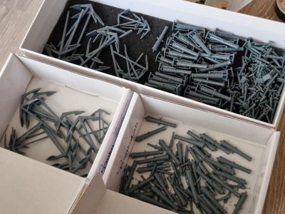

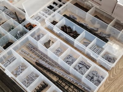

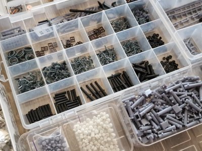

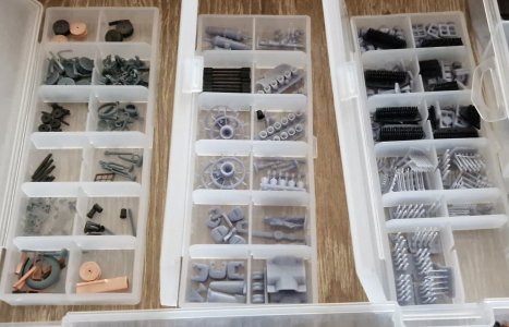

I understand. But I got both printers for free. Whenever we buy a new one at work, I keep the old one. Now I have two. And I'm saying that you can safely buy a used one and it won't be that expensive. But for copper plating, I need a lot of blanks, so having a printer is a must for me. And if you're painting the parts, then naturally buying a printer isn't always wise if you can find parts cheaply somewhere.
While it's summer and I have access to a permanently open balcony, I decided to print as many parts as possible, as printing requires good ventilation. I haven't printed everything yet, but the lion's share is ready.
I printed a lot of parts on Victory, and they will be painted a deep matte black (and some in matte brown). So, I'm not against painting plastic parts, but only at scales of 1:100 and above. I've prepared all the parts for copper plating for both Alert hulls, and some have already been completed.
This article is a more complete summary of the entire process, from modeling the parts to printing, (painting), and copper plating.
All the results from Victory will be in the corresponding thread when I finish with Alert. I'm talking about copper plating the plastic parts in the Alert thread. I've finally completed all the experiments and found the best conditions to ensure I'm happy with the results.

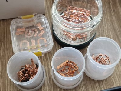

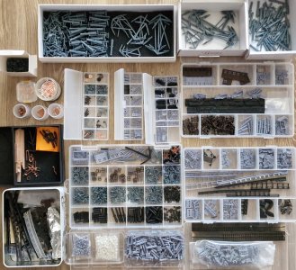

And this is the number of parts printed so far for both models. (That's not all; some are still hidden somewhere, and some (the defective ones) were scrapped. I dread to imagine how many parts were printed, taking into account trials, printing experiments, and errors, but I'd guess it was thousands...
Yes, a printer isn't cheap, but it saves time on creating repeatable parts exponentially. Especially if you're building not just one but several models.
But the most important thing for me is the ability to create metal parts (copper-coated plastic) of complex shapes in large quantities with perfect repeatability. What else do you need...

I've copper-plated about 200 parts so far, and I admit it took a fair amount of time testing and experimenting, but... considering I finally found a way to achieve repeatable results, I can manufacture very complex parts in any quantity tens of times faster than traditional soldering or casting methods... and what's more important in life than results, and ESPECIALLY what could be more important than time?
