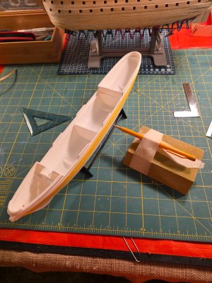

2. Opening the box.
Instead of printed plans the Juan Sebastian Elcano kit comes with a CD-rom that includes 28 short videos on how to construct the model. The kit would be useful if my laptop had a CD disk drive (does anyone use CD drives anymore?) I have watched the first 22 of the 28 videos on Youtube at Artesiana Latina's channel and it is "show but don't tell" minimal narration so they work for at least English, French, and German. Otherwise just elevator music.
The sails will need to be completely replaced, as the sails that come with the kit are all lined with a gold pattern that doe not show on the any pictures of the A/L kit. Luckily, I have plenty of raw sail canvas left over from my hull-only build of the HMS Victory.
The package was neatly packed and all parts are accounted for. It would have been nice if A/L included at least one scale drawing of the ship as built, but this is an "Easy" build, so they were most likely trying to keep costs down. They did include as a "gift" two vials of acrylic paint in green for the hull and red for some furnishings, but I will go off plan and follow the color scheme of The Moshulu model hull and fittings.
Following the videos, I will start by making the stand and assembling the hull first, then the decks and furnishings.
QUESTION FOR SOS: Would it be easier to paint the plastic hull with The Moshulu colors before adding the top decks, masts and rigging, of if I should just prime the hull and finish painting the hull towards the end of the build? I will scribe the hull lines / water lines according to the original Moshulu plans or the Greenwich Museum model.

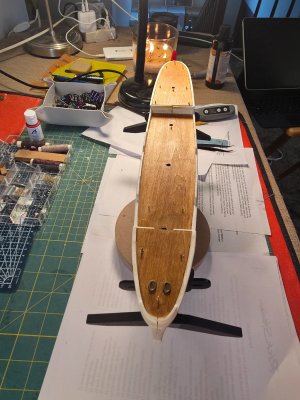

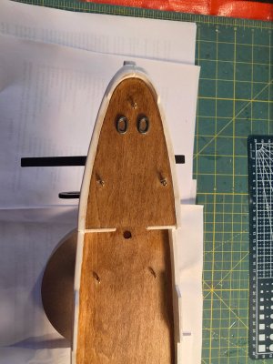

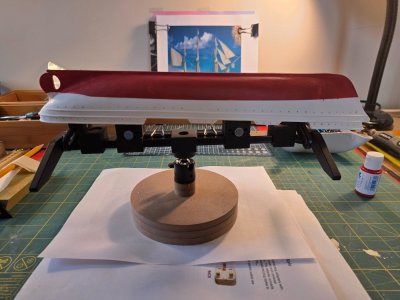

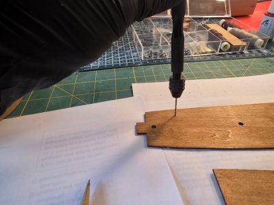

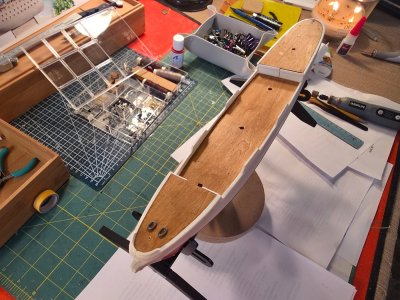

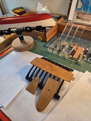

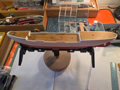

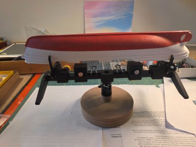

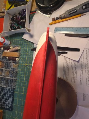

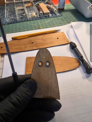

Build Log Day 5: Juan Sebastian Elcano
Fairly easy build...the plastic ABS hull makes for no planking and easy to paint. The Artesiana Latina videos are clear even though there is no narration and barely no drawings of the vessel as built. Painting will use acrylics instead of water-based stain, but I'm going to stain the upper decks.
I chose to paint the hull bright red instead of green, using the acrylic paint that came with the kit. Primed the hull white. Scribed the water line. I may present this ship as the Chilean Esmeralda instead of the Spanish JS Elcano or not.
The AL videos call for a clear acrylic on the top decks. I chose to use a teak water-based stain to show more grain. I know that the grain will appear disproportionate to the scale of the build. The decks (and masts) are basically the only wooden parts in this build so why not, with the build being extremely entry level there is not a lot of realism to this build anyway.
Will clean up the hull and put second coat of white and red after the sails go up in A/L video #7!
Next up: Deck structures and furnishings.
