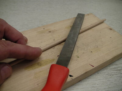

Most often, the wood is used from the construction kit. First, check whether the round timber is straight, especially beech wood, it is sometimes bend. Taper the mast upwards with a file or small plane.
SANY1101.JPGKeep the tool at an angle so as not to grind in any hollows. Turn the mast a little at a time and gradually start sanding a little further up. Check the thickness of the mast again and again and finally grind it finely with sandpaper.
Yards can also be clamped in a drill with excess length and thinned with a roll of sandpaper rolled around the wood from the center outward. The clamped end from the drill press is sawed off later. This is manual work, of course, but carefully applied and by constantly remeasuring, you can get good results. It is very easy to take a mistake with the material removal and the masts or yards are quickly too thin.

I think my biggest problem with the masts is their sheer size. The scale of the Alert is 1/25. The main portion of the Foremast (terminology?) is 505mm long and the Mainmast is 515mm. The taper is from 9.7mm to 6 mm. So there is quite a bit of material to remove. My tapering effort constantly produced scalloped areas which led to more uneven areas which by more sanding = kindling.
View attachment 218802Keep the tool at an angle so as not to grind in any hollows. Turn the mast a little at a time and gradually start sanding a little further up. Check the thickness of the mast again and again and finally grind it finely with sandpaper.

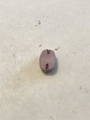

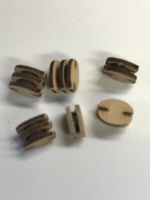

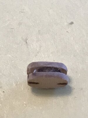

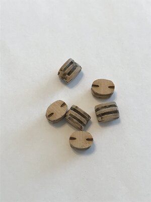

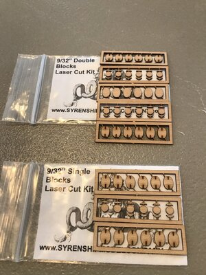

A small experiment:
A little fiddling around to get my mind off mast tapering.
Found these on line and thought I‘d give them a try.
DYI Blocks. About 7mm. (Syren Ship Models)
The macro image makes them look odd, but with a bit of sanding I think they will work out.
Jan

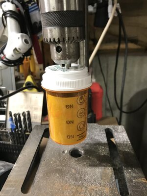

Innovation and midnight ideas:
Sometimes the brain seems to go on overdrive and odd ideas pop up.
How can all those DIY blocks be sanded, rounded and be finished.
1) A plastic pill bottle
2) Glue a piece of 150 grit sandpaper to the sides and bottom
3) Add a shaft from an old Dremel cut off disk to the pill bottle cap
4) Add DIY Blocks
5) Chuck it into a Drill Press
6) Spin it at 700 rpm (lowest pulley combination on drill press)
7) Cross fingers and see what happens
Jan

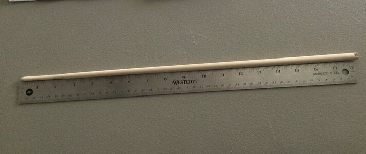

Hi Thomas,
I tried your method of finishing a mast.
The result.
Jan
Hi Jan!
The mast can not be judged accurately in the photo, but it looks good. If the measurement result of the circumference are correct and there are no hollows, everything is good.
Best regards
thomas
Oops, My mistake, I meant to post this photo also. I used a straight edge to check for “hollows”. The first photo was to show the my points of measurement for the mast taper.
The tip looks odd, but if you look a photo #1 which shows the plan. You can see that there are two flat spots required at the end of the 7mm taper and then the next forward portion is shaped into a 6mm square followed by the tip being 5mm round.
Jan

Hi Heinrich,
The results of the spinning experiment.
It took a LOOOOOOONG time. I think together a better result I'll have to add some sort of sandpaper paddle inside the pill bottle. With the present set up the pieces were not tossed up against the sandpaper liner inside the pill bottle enough together a good finish. It was worth a try but now will be a project for later.
Jan
