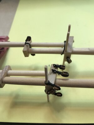

The Masts Continued.

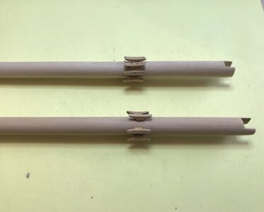

Managed to do some more work on the masts. I tried some of the different techniques suggested for shaping the masts and finally settled on using my drill press and two 3M sanding blocks. That method worked well for me.
So today I've started on the various attachments to the masts. I needed to add six cleats to the Main mast and eight cleats to the Foremast. Interesting little job. The cleats were to be made up from two pieces (a top and bottom). With my usual dexterity I destroyed more than I completed. So it was off to find an alternative. A little bit of research on the net and I found one.
A much better looking product than my attempts. The deck of the Alert has quite a slant (rake??) so the cleats will (more or less, that's my plan) be parallel to the deck once the masts are placed (stepped?).
I've also started "Stropping" (Haven't learned all of the Sailor talk yet) the blocks and placing them in the proper spots on the masts. I'm not really satisfied with my effort so far, so it's more research as to how to do that properly and how with my eight thumbs and two fingers I can accomplish it. I'm trying to use the cordage that came with the kit and avoid the horrible twisted wire method from my first ever build.
I've tried different methods of holding the blocks while trying to "whip" the ends to make and eye or attach one to an eyebolt. I've order a "third hand" gadget and hope that will help with this process. Blocks, cleats and other deck items are much more visible @1/25 scale. I've done a lot more "do overs" to avoid "the it looks good from here mentality".
Jan

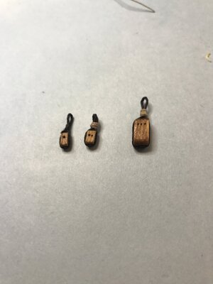

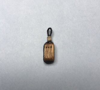

The results of my block stropping experiment.
I used over size thread for both the block stropping and the whipping/ seizing to show what can be done with the tie-fast tool. Using smaller diameter thread looks a lot better.The 4mm block on the left has 1.0mm and 0.25mm thread, the 5mm block in the middle has 1.0mm and 0.5mm, while the 9mm block has 1.5mm and 0.75mm thread.
I did the 4mm and 5mm blocks the same-way as the 9mm block. It takes a bit of patience and a little pre-planning. I think the tool will work great for doing blocks as well as seizing shroud lines. There is a more detailed explanation of my bumbling attempt on the "A way of seizing" thread post #26.
Jan
