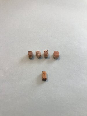

10mm Triple Blocks , need help finding some.
The kit has 10mm trible blocks but not one of them is square or has the holes in a straight line.
The blocks on the left are from the kit. The blocks on the right I kit bashed from set of Syren single and a set of their double DIY blocks. Th ones on the right are just a bit over 7mm. I've spent couple of hours this afternoon looking for 10mm triple blocks, alas I've not been able to find any. Does anyone have a source, I only need four to rig the downstay for the main mast.

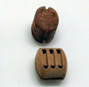

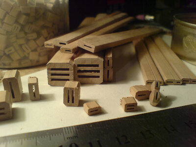

I agree with Paul. Why not make your own? You need only 4, and it is not difficult to make. Here is the idea
Jim, how do you round the edges? I have seen sanding tumblers - but couldn't they just be sanded by hand at this scale?
I was just picturing starting with a solid chunks of wood and using files to shape the block and add the channel(s) for ropes and such...drill out the holes...
Hello, Paul! In the above photo, the edges pre-rounded by tablesaw, and then by hand. Once you cut the block from the strip, it is finished by hand using files. You are correct, a simple blocks can be made from solid wood: shaping and drilling the holes.

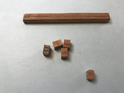

Took some time this morning to cobble together bits and pieces to see if I could actually make my own blocks.
I used odds and ends of stock from previous builds to make a three tier "sandwich", cut out the rough block form (10mm X 6.5mm X 6.5mm)
The block roughed in.
I consider my first experiment a success and will now order some proper material to make the blocks I need.

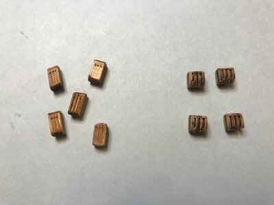

Blocks:
Still experimenting, trying to figure out the best best method to make my own blocks. I'm currently waiting for Boxwood and Cherry pieces to arrive.
These don't look bad, made from my initial kit bash of odd pieces of wood. But aren't what I have in mind.
My effort on top and the kit block on the bottom.
I assume from the examples shown, that there are couple methods. Either carve them out of a single piece of material or laminate pieces to to get the general shape. Then its sand, sand ,sand and more to shape them. I'll probably try both methods.

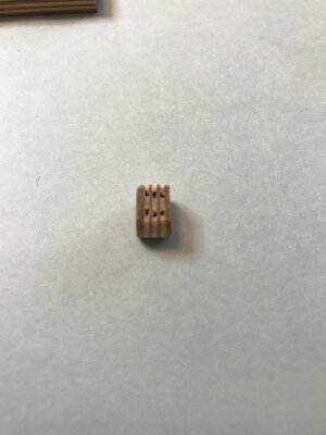

To get the 3 holes did you drill them out ?

Hi Rowboat.
I laminated some odds and ends left over from previous builds. I alternated 10 X .5 mm strips and placed three 2 X .5mm on them to get the triple block. That process would work just as well for single or double blocks. The attached pic shows what I did, I didn't spent much time on this initial experiment, I was more interested in whether I could make my own blocks.
My next set will be done much more carefully.
