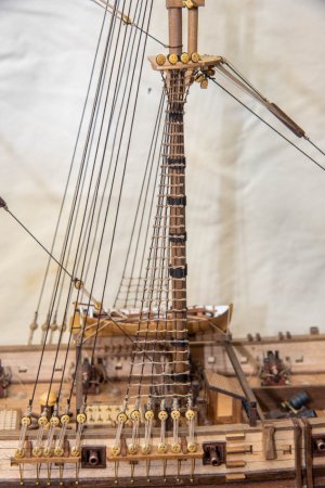

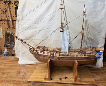

Hi everyone. After about a years hiatus from building my ship I started back up about a month ago. For me this is a winter project as I have other projects going on from spring through autumn. I also missed & did not record a lot of steps in my log. Sorry about that sometimes I become a little lazy when I shouldn't.
Anyway, in the last month I installed the mast & have most of the standing rigging up. now I'm working on the shrouds & ratlines. Instead of using the kit supplied rope I went with Syren Ship Model Co. rope which does not have the fuzziness. For the ratlines I think I may have gone a little too large (.45mm) & didn't notice until I had a few of them in place. For this 1:85 scale model I spaced them at 5mm apart.DLM_7216.jpgDLM_7223.jpg

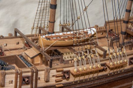

Other then the rigging I upgraded a few other items including the life boat which is the Vanguard Models 18ft. cutter.DLM_7235.jpg
