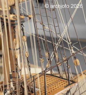

Rigging the Main Topgallant Yard – Vergue de grand perroquet
One level higher up the mainmast, the running rigging of the corvette continues to take shape.

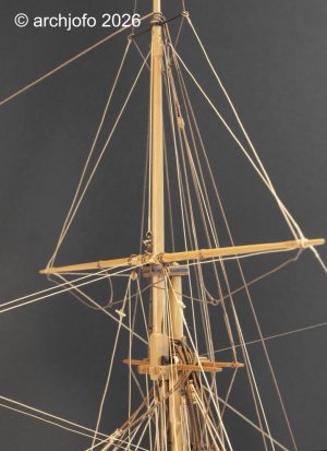

The main topgallant yard, already fully equipped with all rigging elements, has been temporarily secured with the parrel. After reeving the lifts through the thimbles between the topgallant shrouds, and the braces through the double blocks below the mizzen topgallant crosstrees, the yard could be roughly aligned. As long as the running rigging is not yet belayed, I always weigh these lines down with wooden clothespins, which makes the alignment process much easier. It looks a bit wild, but it is incredibly helpful.

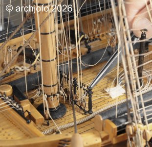

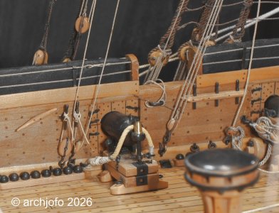

After reeving the tye through the sheave hole in the hound of the main topgallant mast, the block for the main topgallant haliard could be seized. To make this process easier, I clamped the assembly in place, as shown in the picture below:

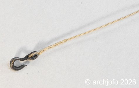

Based on earlier research, the standing part of the main topgallant haliard received a hook, which was hooked into an eyebolt on the outside of the bulwark on the starboard side. The running part of the haliard was led through a lead block and belayed on the port side, inside the bulwark, to a belaying pin next to the main topsail haliard.

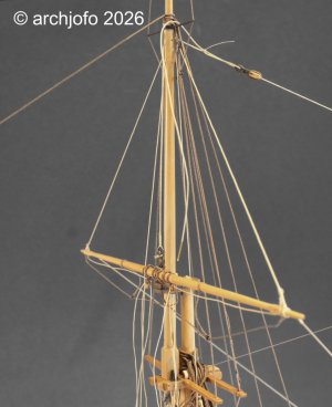

I then continued with the running rigging of the main topgallant yard. I connected the main topgallant sheets to the main topsail clewlines by means of toggles and subsequently belayed them at the bulwark.
The topping lifts were belayed to the cleats on the main topmast shrouds.

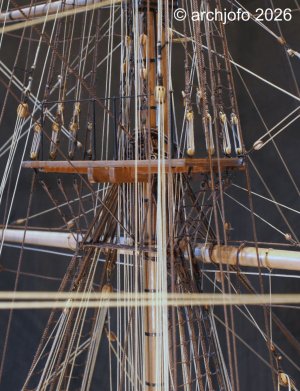

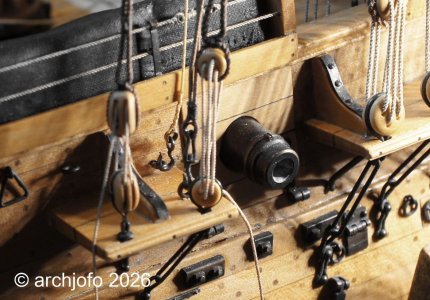

These bowlines were belayed at the pin rail aft of the foremast. Threading them through the turning blocks requires a steady hand, as shown in the next picture.
By now, rigging demands quite a bit of patience and resilience against frustration. Somewhere – whether it is the standing rigging or the braces – a line is touched unintentionally, creating pressure or tension that is detrimental to the overall arrangement. When new lines are added, something else may loosen again. Constant readjustment cannot be completely avoided, even with the greatest care.
Guiding the running rigging from top to bottom to the belaying points without collisions or entanglement with other lines also requires extremely careful work. Often one only notices after belaying that a line has taken the wrong path or is blocking another element – and the game begins anew.

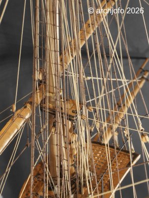

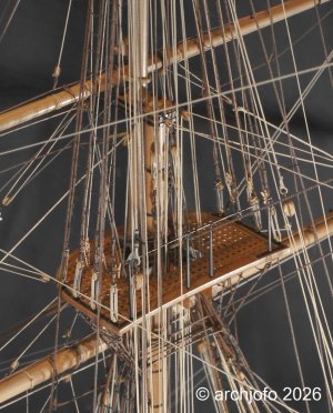

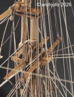

The following picture shows the maintop, where the bowlines of the main topsail and main topgallant sail run down the mast between the after trestle trees to the pin rail.

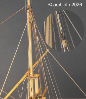

The bowlines of the main topsail are led downward through the single blocks at the aft side of the cap of the main mast, as can be seen in the next two pictures.

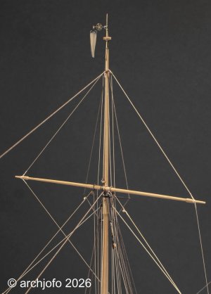

Rigging the Main Royal Yard – Vergue de grand cacatois
I have now reached the uppermost level of the mainmast of my French corvette.

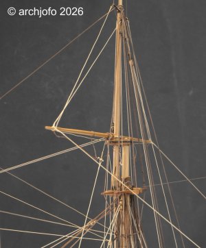

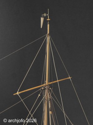

Similarly to the fore royal yard, the main royal yard was mounted and temporarily aligned in its final position before its running rigging was belayed line by line. The main royal halyard was reeved through the sheave hole (sheave-hole) in the royal mast, led through a foot block hooked near the waterway, and belayed on the starboard bulwark—directly opposite the portside belaying point of the main topgallant halyard.
The main royal lifts, sheets, and clewlines were belayed to cleats provided for this purpose on the main topmast shrouds, just as they were for the fore royal yard. It is worth noting that at these heights, the thinnest ropes of the entire model (with the exception of the flag halyards) are used; for example, the clewlines have a diameter of just 0.25 mm.
With the main royal yard in place, I can now conclude the rigging work on the main mast and will turn my attention to the mizzenmast next.
