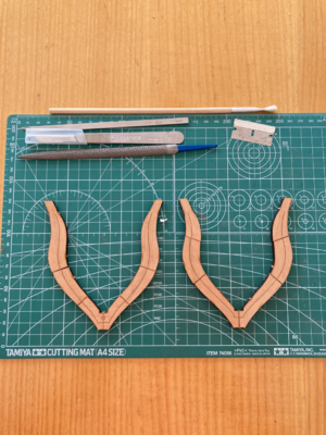

The two blank faces of each layer are glued together, leaving the bevelling lines visible - outside bevel on the left (frame numbers face forward) and inside on the right. This is how the frames look before gluing.
I didn’t remove char from the inner and other edges of this frame as they will both need to be bevelled later.
I then checked all the pieces against the plan for a final time before assembly. Gluing was a bit fiddly, but everything went together in the end.

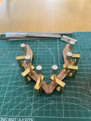

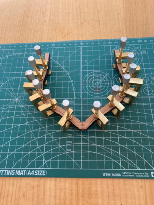

I am using fish glue on the frames. I apply it straight from the bottle (no heat required) with a small brush. It grips quite quickly so that the pieces stay where positioned but allows time for adjustments if required. I put the pieces of the frames together working from the floor timbers to the futtocks to the top timbers. I glue and clamp the left and right pieces of each type of component (mirror images of each other) alternating between the upper and lower layers.
Thankfully, no disasters yet and the layers at the tips of the frames are flush (or very close to).
I understand that the glue can be loosened with water if needs be, but haven’t tried this yet. Supposedly, it can be used for other materials such as cork, leather and metal (!?). It also fills small gaps in joints as it is 45% solids.

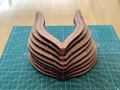

I imagine all models have repetitive phases and I am certainly in one of them. Fortunately, the work isn’t too difficult and I can see the results as my stack has frames is getting higher.
There is a gap between some frame components - e.g between the floor timber and the futtock on the top frame on frame 1 - but I have tried very lightly scraping some joints and the gap seems to almost disappear leaving only a glue line.
It probably takes about one and a half to two hours to get each frame to the stage where it is glued up and ready for bevelling.
I have a day job, so I don’t have much time, except for a few hours in the evening. The routine is to glue up a frame and then start scraping and sanding components for the next frame. I have a small stockpile of frames ready for gluing but I try to do some frame preparation (which take the most time) most days.
