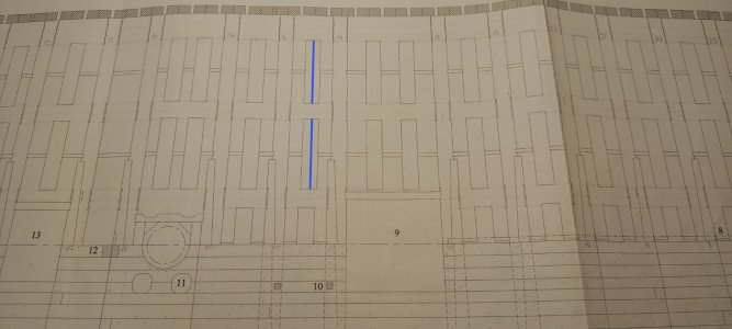

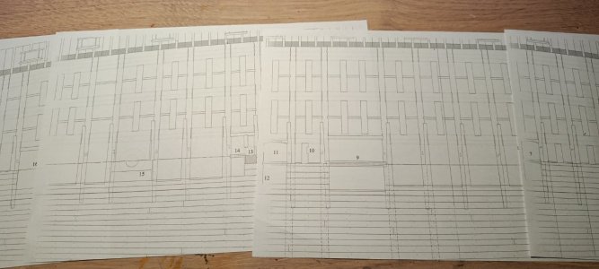

Thanks for your input, Frank.
I know what you mean. On the 74-gun ship, these battens are continuous—meaning just one long batten each. I was able to identify this type of batten from the plans and other build logs for the *Artésien*. They were installed individually. I’m not sure why they did it that way, as I suspect it results in a loss of structural integrity. Here is another excerpt from the plans. You don't see any dashed lines for these battens here—lines that would indicate they consist of a single piece. This same method was also used on the L'Anemone. Perhaps continuous battens were only used on larger ships, given that the *Artésien* isn't a 74-gun ship.
Regards
Andreas

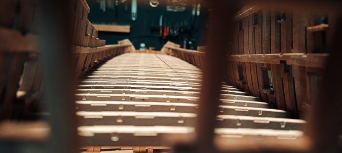

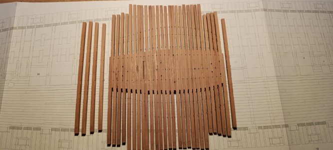

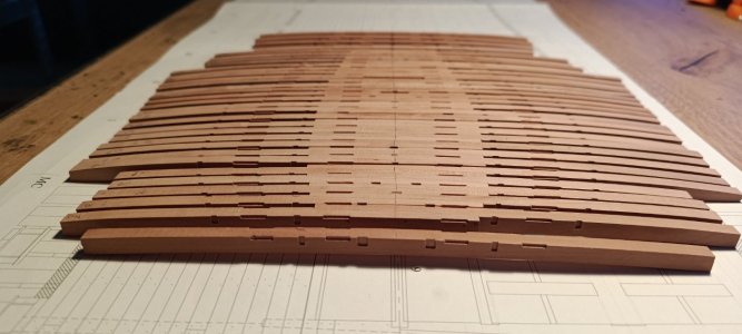

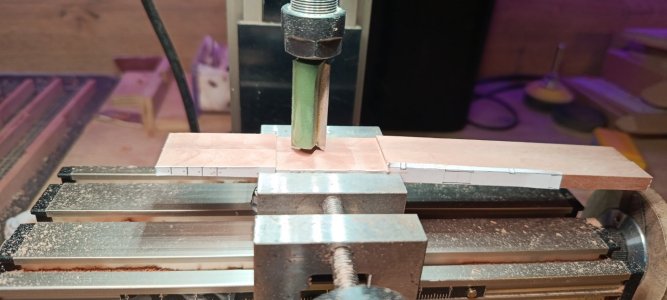

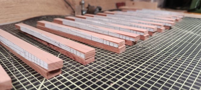

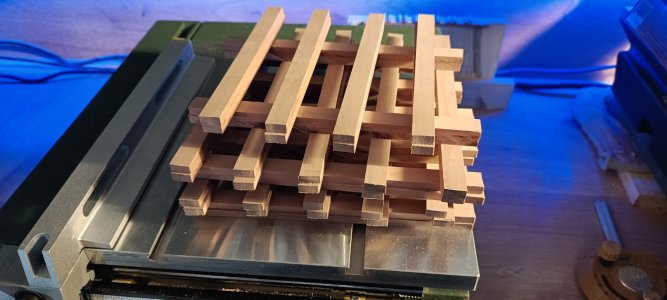

Hello everyone!
The double fish-jointed planks have been laid. The battens between the deck beams are still missing; however, the fish-jointed planks need to be prepared accordingly to accommodate them. Here is an excerpt from the plans, followed by the result:
Regards
Andreas

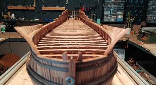

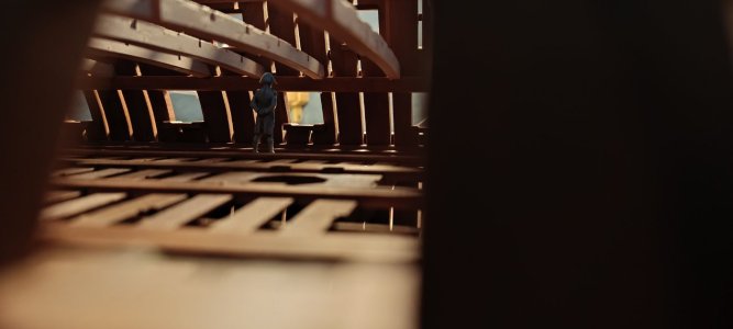

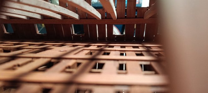

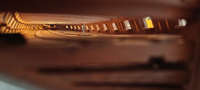

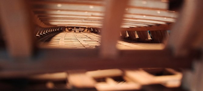

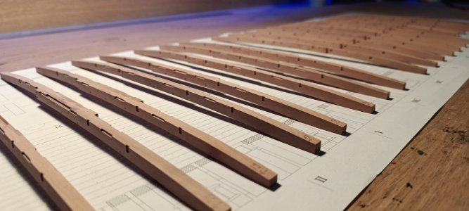

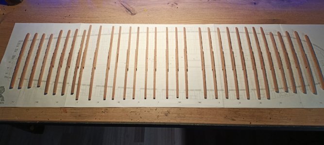

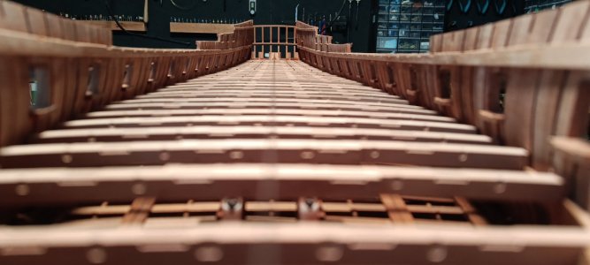

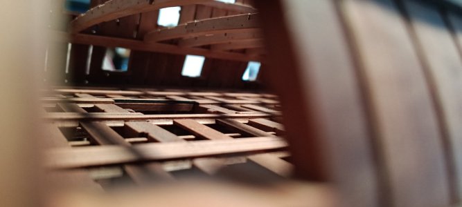

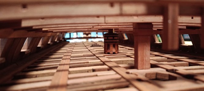

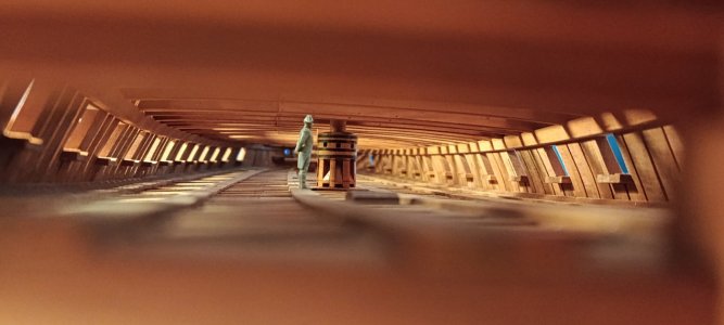

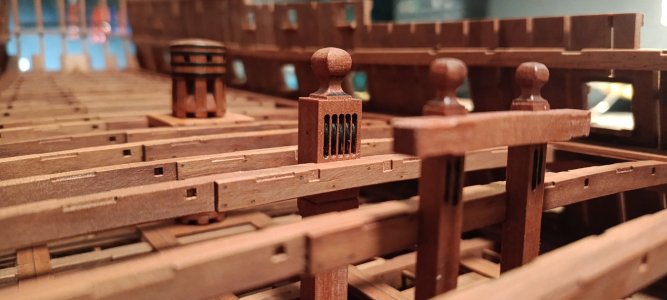

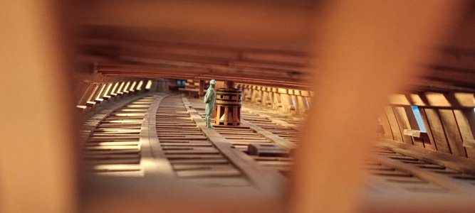

Hello everyone!
Life itself and a garden project have kept me away from the workshop for just under a month.
I’ve now resumed work on the next deck—specifically its beam structure—which I fabricated just as I did for the gun deck and have now test-fitted in place.
Here is a brief photo tour:
Regards
Andreas

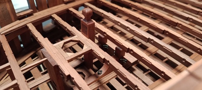

Hello everyone!
Many thanks, Karl, for your kind praise—I really appreciate it!

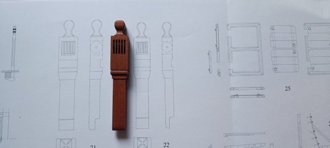

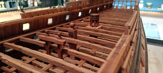

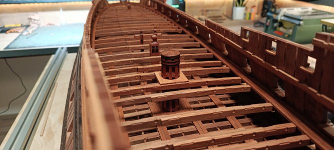

After the beams were glued in place, the two side cleats (no longer visible) and the central support cleat were fabricated and installed, along with the tiller traveler. The two waterways, the waterway margin plank, the cleats for the bowsprit heel, and the foremast partners are also visible here.
Regards
Andreas

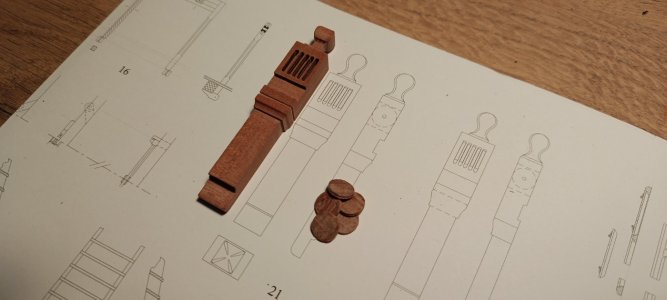

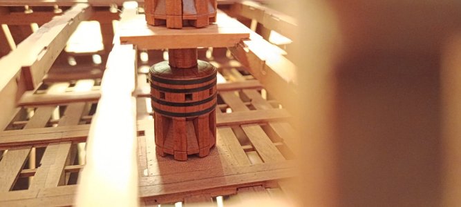

Hello everyone!
Many thanks for the kind words and the many likes!
More equipment has been fabricated:

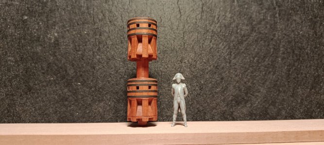

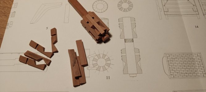

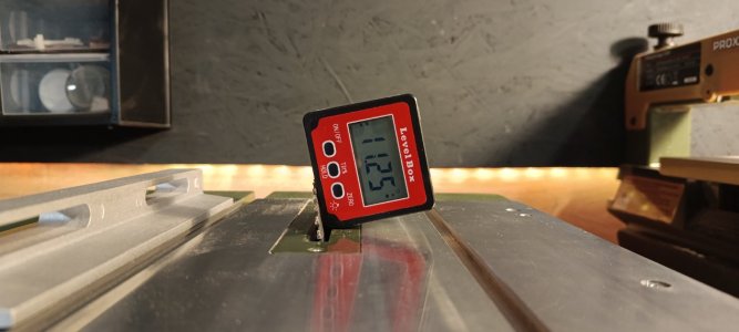

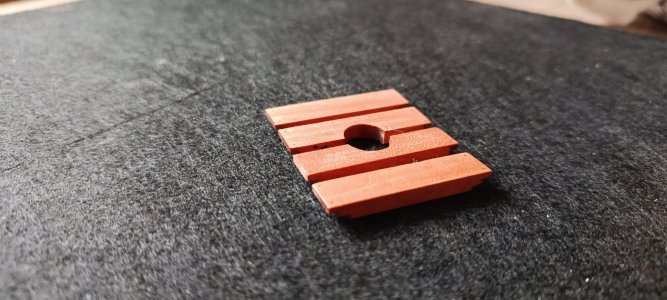

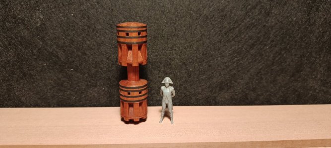

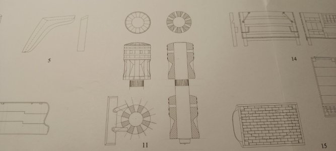

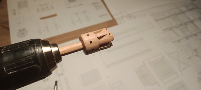

I made another attempt at the Main-Capstan. The challenge lay in the fact that the individual parts are set at different angles relative to one another, even though their outer dimensions are identical (see the plan drawing). I had overlooked this small detail previously and had made 16 pieces with identical angles. An attempt to attach the bands using 0.2 mm brass strip failed—or rather, I wasn't satisfied with the result—so I simulated them using thin tape instead. The result is far better than the first Capstan. Here are a few photos:
Regards
Andreas

Work on the beam fillings and scarfed planks has been completed. All that remains are the battens between the deck beams—more on that in the next update. Additionally, the entire ship has now been treated with bitumen.
Regards
Andreas

Hello Andreas.
Exquisite construction work and the wood itself is particularly beautiful after your treatment.
I assume first treated by oil and now an extra treatment with bitumen? Did you apply the bitumen undiluted or maybe in combination with wax? I admire the result very much.
Good afternoon, Andreas. High quality of the workmanship. You deserve a high rating. I watched the stages of the sailboat construction with great interest. With best wishes, Valentin.
Thank you all for your kind words; I’m very pleased to hear them.
Herman, you’re right. First, the wood is brushed with a conditioning oil. Once that has dried, a mixture of bitumen and oil is applied. I don’t have an exact mixing ratio—I just go by feel and how it looks.
