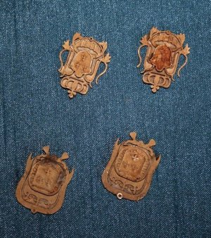

The photo below clearly shows the exposed brass etched away on the Bolt Washer test sample. However, both of the other samples of the Gun Port Hinges still have not been etched away. It would take another 6 minutes for them to complete, and upon closer inspection, they could have gone longer.
The mad science project in action.
I was very pleased with the results of the Bolt Washers. Even the square hole, measuring about 0.4mm, came out clean. Being super picky, you can see the left have of the washers' edges are just a tad rough, something another 30 seconds might fix.
The Gun Port Hinges could have gone another 2 minutes to result in cleaner edges. Something I can tweak for production runs. I'll see what 5 minutes with a micro file will do to clean these up.

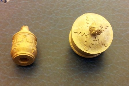

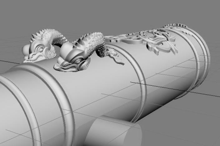

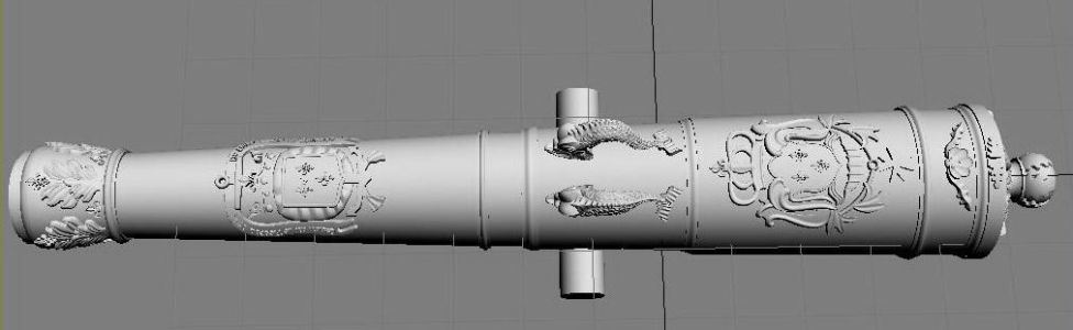

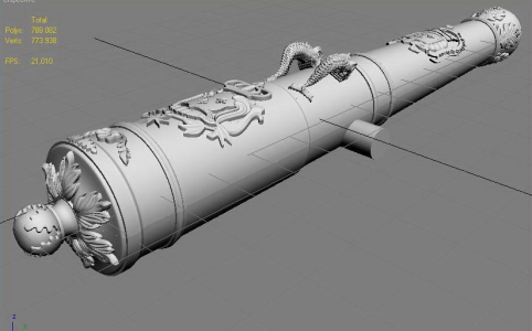

Before I get back to planking, I just wanted to ask if anyone knows where I can find either a drawing or actual artwork for the Le Fleuron bronze 32lb guns? If I can get a hold of them, I'll try and etch them out of brass and solder them to the guns prior to blackening.
The pieces I'm looking for are below. Jim or any Admin, please let me know if there is a better place in the forums to post this ask.
Cannoni09.jpg.4c3755837e5fc74710d96fc120e5d037.jpgcannoni021.jpg.18eb4d6b179dcb5a40198e1120d0cfac.jpg
If I can't find the artwork, I'll try and trace it in Adobe Illustrator, but I'd rather not, as the designs on both ends of the cannons will be difficult.
Thanks in advance!

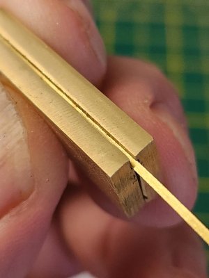

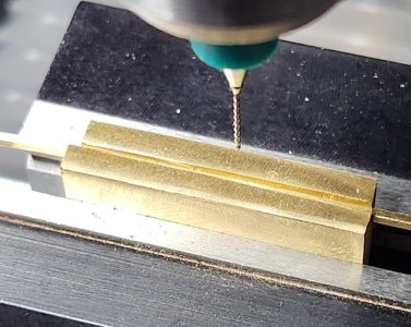

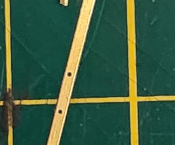

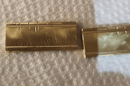

So one last post, before I get back to planking. Since I will be able to make my washers for the gun tackle/breech line clench bolts, I decided to find a quick solution for drilling the 0.3mm in a 0.8mm square bolt. There was NO WAY I could center punch to mark a drill bit starting point on such a small piece, even though I tried. :rolleyes: So I decided to make a jig to hold the square piece perpendicular to the drill bit.
Using some scrap brass strips, I milled a 0.9mm rebate the length of the strip. I cut it in half, making mating sides to hold the square wire. I cut a depth of 0.2mm. So 0.8mm - (0.3 mm + 0.3 mm), left me with a gap of 0.3mm, (actually just a hair over) the size of the hole I needed to drill, and the size of the clench pin to be inserted later.
Photos should be self-explanatory.
Very happy with the outcome and much less frustrating.....but, in the photo above, you can see I was using one of those fragile PCB drill bits that broke during my 3rd hole. I do have other high-quality bits, but I need to find a way to connect them to my mill. I have a good idea, but I will hold off until I get bored with planking again to solve.
View attachment 521082View attachment 521086View attachment 521081View attachment 521084
