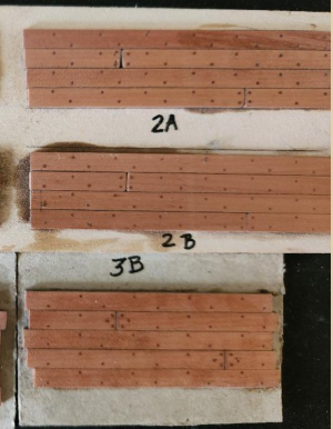

I like those 'B' results *below). The treenails are subtle and thin caulking.
Jim, Peter, and Grant, thank you for the input. I was leaning this way, as well, but was not sure if they were too subtle. Fortunately, they are the easiest to apply. Thanks agains.
First, I'd probably pick the easiest. Most people wouldn't notice the difference, maybe not even Paul. Second, I prefer the more subtle look on treenails. When I look at real ships, they're hardly noticeable.

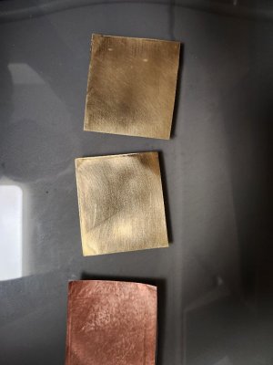

Below, left to right: Yellow Brass, Red Brass, Copper. It is my understanding Red Brass is Yellow Brass, with a slightly higher Copper content.
All three will tarnish, but again for me the choice was weighted to either brass wire, due to my functional requirement. Had I been able to use the Copper wire, I definitely would do so, as I think you will be able to see a bit of difference when viewing the bolt application across the entire wale. I will be using Copper for the inside fasteners of all gun port lids.

So as we do, when we get stuck, we take a small step of testing the plank fasteners' appearance, treenails, and bolts. French 74s of the period typically had a combination of treenails and iron bolts, offset and alternated, below the waterline. I will not be following this standard, installing treenails only below the waterline.
Photos of some test samples are below. Plank and treenail tests have different combinations of treatments. Planks include sanding sealer, Tung Oil, Bitumen wash with white spirits, and Bitumen/bees wax. Treenails are all of the same pearwood as the planks, but have three different treatments, including 1) no treatment, 2) flat black paint, and 3) graphite treated low viscosity PA glue applied during installation.
Although the samples are all relatively close in appearance, there are some subtle differences. I've yet to decide which I prefer. Input is always welcome.
So we all know the importance of using GREEN mats. I think I've uncovered some false advertisement in marketing. Mine are supposed to be "self-healing". I'm waiting for the drill holes to heal themselves! ROTF :rolleyes:

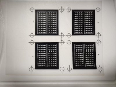

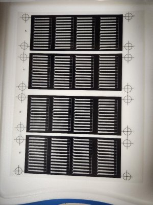

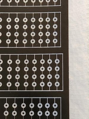

Artwork
IMPORTANT: Only Vector graphics can be used in the artwork. It is the only way to produce crisp borders. The pieces I need and decided to use in this test are gun port hinges, as reasonably scaled hinges could not be found online. And secondly, washers for the hooked bolts used for attaching gun breach lines and gun tackles.
I used Adobe Illustrator on a 7-day trial, which has now expired. The Washers are drawn, starting with ONE washer, cloned, grouped, and cloned again, until I end up with an appropriately sized template for testing. Even being careful, there are some variations. Since etching will be performed on both sides of the brass sheet simultaneously, you need two identical images. So I took one of the images, cloned it, and then flipped it horizontally, added registration marks to ensure they are aligned exactly. This is absolutely the most important part of ensuring a good result and is not to be rushed. If they are not, the etching quality suffers, and there is no range of quality here. It is either acceptable or not. Brass thickness for the washers is 0.2mm.
A couple of additional notes. The artwork is printed on "waterproof transparency film", which is used for inkjet printers. Only one side is printable. Very clean borders were achieved this way.

Note: The connectors that tie the pieces together need to be at least 0.2mm. If you look closely, the image below is very slightly extended/stretched vertically, resulting in the bolt holes being slightly oblong in the same direction. More on that later.
Ok, so I now have artwork.

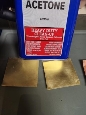

Metal Preparation
Same as preparation for blackening.
Sanding, 320grit, 400grit. I test by dripping water on the metal. If it spreads naturally across the surface of the brass and does not bead up, it's good to go.
Then cleaned with Acetone and put aside to dry.

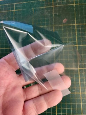

This film has three layers: the middle layer, which is the actual photosensitive layer, and two outer protective layers.

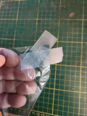

The trickiest part of this entire test was peeling away one of the protective layers. All my research said this must be done in a dimly lit environment as not to overexpose the film, done with gloves, and for me, with arthritic fingers. I learned that as long as it's not in direct sunlight, it would take 30 minutes for the film I used to become affected.
A method that helped separate the layers was to place a piece of tape in one corner of the film, offset from each other, and gently pull apart.

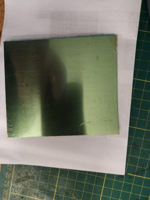

Then the photo resist film (blue tint) is placed onto the brass sheet with a little water on it and work middle out to smoothly adhere the film. I used a credit card as a squeegee. Repeat on the other side of the brass as both sides will be etched simultaneously.

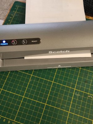

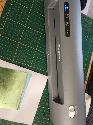

The last step in this Part 1 is adhering the photosensitive film to the brass stock. The next series of photos was taken just now, as I realized I forgot to take photos of this step. In the first photo, you can see little air pockets, which I would have squeegeed out if it were a real production step. With that said, it provided a great learning opportunity to see what would happen if they weren't taken out.
The brass sheet is then put between a folded piece of regular printer paper and then run through a laminator. You don't need to use real "carrier folders", normally used to protect the film from the heat of the laminator. Also, I've seen other tutorials that demonstrated the use of a clothes iron, which I imagine would work fine. One person used a heat gun, but I would not try this as it lacks the pressure needed to adhere the film to the metal.
You can see even without taking the time to squeegee out any bubbles, the laminating process pretty much did the job, although I would not skip this step in a production run.

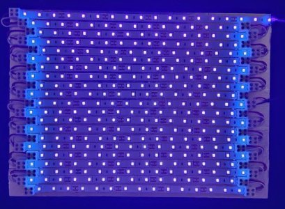

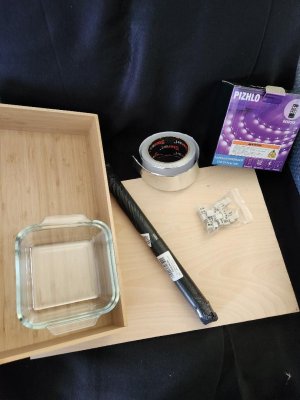

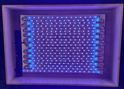

The next step, building the UV Light Box used to expose the film. It is a DIY effort. Now I know when it comes to building things, my skills don't come close to the mad scientist skills possessed by my friend Stephan, I just hope my efforts produce something that works.
Materials
Ignore the glass dishes and photo roll (black tube). Also, not shown is the UV LED strips' hardware (in the box) and electrical connecting wires that run the series.
  • Bamboo box, only 3.5 inches deep, but I can always increase the distance of the lights from the prints manually.
  • Aluminum tape
  • 1/8in x 8.5in x 11in plywood

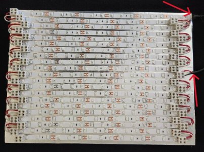

  • UV LED strips, with remote control dimming and timing, which I thought would come in handy, and at $16, I could not pass up.
  • LED strip connectors (I chose these to eliminate any need to solder)

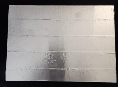

First things first. Use the aluminum tape to cover the plywood, which provides some UV reflective value.
I then mapped out the LED strips and staggered each row to provide a little room when making connections. Since there were two power connectors were provided I decided to use each one to power only 1/2 the bank of LEDs, ensuring sufficient power to all LEDs.
Testing, 1, 2, 3. Oh, wait, I mean POWER UP! It's important to understand not to look directly into real UV light, as it most certainly can damage eyesight.
thumbnail (4).jpg.

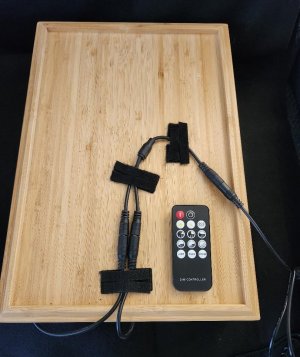

In the box. The LED board is held in place using two large Velcro strips. I wanted the ability to remove if I had to work on it in the future. I almost grabbed the Hot Glue Gun...RedfaceROTF
Outside box, with power and controls.

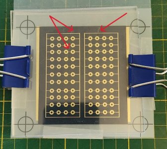

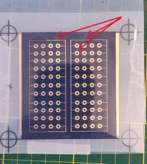

Ok, now that the light box is ready, it's time to prep the test samples, bolt washers first. I take the two identical test pieces of artwork, tape the first one, printed side UP, to the desktop. Then its partner and place it on top of the first one, printed side DOWN. Then, using three small pieces of tape, tape the two pieces on three sides, only after I've ensured the registration marks are aligned. The fourth side remains open, forming a pocket. The brass test sheet is inserted into the pocket.
Note: The arrows below point out anomalies in the ink coverage on the artwork. This can happen during the printing process or, more likely in my case, when I inserted the brass sheet into the pocket, scraped the ink. In either case, these can be covered up with a black Sharpie, EZPZ.

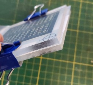

To ensure all three elements remain in place, I create a sandwich with two pieces of Plexiglass being the "bread".

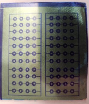

I did that for both samples and ended up pleased with the results of both. The exposed film seemed to take on a muted purple color after being cured, bolt washers below.
Tight, crisp lines. I'm :D.

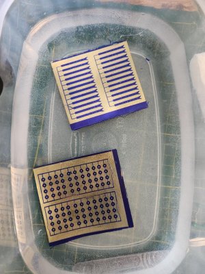

The Wash
Note: The final steps involve caustic chemical agents. I wear gloves, protective eyewear, and even an apron. While both of the agents I use, Sodium Hydroxide (Lye) and Ferric Chloride, are on the low end of the caustic spectrum, both will cause skin burns or serious eye damage. It's always slow and steady. I chose these two chemicals BECAUSE they are the milder choices. Other tutorials prefer other more caustic agents. The difference in the choices is straightforward. The more caustic the chemical agent, the faster the metal is etched, and the more harmful they are if mishandled. I can wait 1.5 hours for the final etching, compared to 15 minutes.
Ok, the "Wash" is the step that washes away the unexposed, uncured areas of the photo film. The first step is to remove the outside protective film that is still in place on BOTH sides of the brass sheet. BOTH sides, Einstein!!!! More on this later. :rolleyes:
Once the film is removed, a wash bath is created by combining Sodium Hydroxide and Demineralized/Distilled H2O. While many people online state the ratio does not have to be exact, once again, working with chemicals, I always start conservatively on the "mild" side, always with the option of strengthening the solution if it isn't as effective as expected.
My wash ratio was 5 grams of Sodium Hydroxide to 150 ml of distilled H2O. This worked fine. So after thoroughly mixing, I submerged both samples into the wash and let them sit for a minute. Then, with an old, soft, small paintbrush, I gently stroked the bass sheets for about 30 seconds. Looking carefully, you can see the film slowly being washed away, leaving the purple cured film.
After doing for both samples, both sides, they are removed from the wash and put into a container of distilled clear water, which stops the wash process.

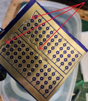

My results were mixed, but valuable.
So, again, for the final etching step, every area where you can see brass, that metal will be etched away, the blue will remain and after a final wash, leave us with tiny identical parts, hopefully. At first glance, everything looks great, but....

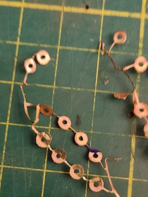

The sprue connectors that the arrows point out have delaminated from the metal. I'm ok with this. The reason I'm conducting this test is to identify and resolve any issues before the real production runs.
So, I believe that there are a few reasons the cured film would delaminate from the brass.
  • The metal was not cleaned sufficiently, and dirt or debris prevented the film from adhering completely
  • The sprue connector was too thin to provide the same adhesion
  • The temperature of the lamination process was not hot enough to achieve the same
It could be all three. No worries here. It is not a deal breaker. Now, if 80% of the sprues did not adhere, I would have a big problem, but this one is manageable.

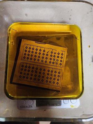

Etching
Etching is the removal of the unprotected metal, leaving you with the areas that are protected by the cured photo film. The etching agent I used is Ferric Chloride, 40% solution, which I used straight out of the bottle. This is not some crazy caustic, like Fluoroantimonic acid. Still, I'm very careful. Again, I chose this agent to preserve safety over expedience.
Below you can see the "bolt washer" test plate in the Ferric Chloride solution, diluted. I later realized I needed to use it at full strength and adjusted. (Sorry, no photo). Ok, so the final results for the "bolt washers" test were compromised by my wandering mind. I referred to this earlier in the post, with the "Einstein" comment. When preparing the brass test sheet for washing, I forgot to remove one side of the protective film. It was still in place during the final etching, affecting the removal of metal. Instead of the etching taking place on both sides at the same time, resulting in the removal of metal uniformly, one side was protected from the etching agent, resulting in over-etching in some areas and not in others.

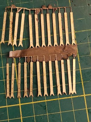

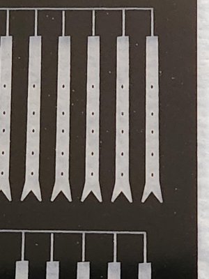

Gun port hinges.
Pros
  • All parts were fabricated, that's it.
Cons
  • Uneven etching
  • Side etching, resulting in rough edges, that will need to be worked (sanded, filed) to make smooth.
With these observations, it's important to note, the photo is magnified and the end result, with a little work, is acceptable, in my view on the ship with human eyesight.

Secondly, I will take these parts I made and work a little bit with a file and sandpaper and see how they present in their application on the ship (test hull).
Thanks for looking in. Don't be discouraged, I'm not
Cheers
Hi Ken,
This is really fun to do.
For the crisp finish of the parts you really need the photo etsch.
For course parts you can also use the laser printer. Just print the item you need on the laser printer. Clean the brass with acetone and use an Iron to Iron the image from the paper to the brass on both sides of the brass.
Simple but effective.
Looking forward to your 2nd part.
Hey Maarten, Yes, I just needed to find out for myself. With time, cost, and quality of parts all having an impact on our hobby, I felt the need to explore and understand more. Thanks for stopping by.
