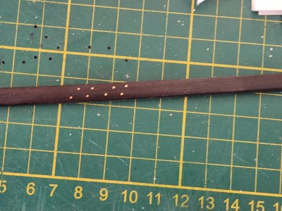

So we all know the importance of using GREEN mats. I think I've uncovered some false advertisement in marketing. Mine are supposed to be "self-healing". I'm waiting for the drill holes to heal themselves! ROTF :rolleyes:
thumbnail (17).jpgthumbnail (18).jpgFor the Wales bolts, I wanted to use copper or something similar. The photo below shows half-hard square copper wire as well as half-hard square red brass wire. From the usual viewing distance, you really can't tell the difference. Under magnification, the differences are slight. The key difference is that, even though both are "half-hard," the red brass was noticeably harder and therefore easier to work with during installation. So the decision has been made.

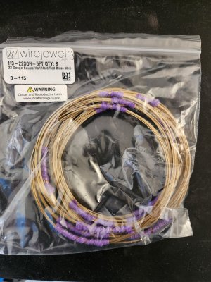

View attachment 513704View attachment 513705For the Wales bolts, I wanted to use copper or something similar. The photo below shows half-hard square copper wire as well as half-hard square red brass wire. From the usual viewing distance, you really can't tell the difference. Under magnification, the differences are slight. The key difference is that, even though both are "half-hard," the red brass was noticeably harder and therefore easier to work with during installation. So the decision has been made.

@WojtasS, the wire is 22 gauge. Sorry, but my calipers slipped right when I snapped the photo and show 0.71 when the wire is 0.65mm or right around 1.2 inches in 1:48 scale.
I'm not sure where in Europe this wire can be found, but in the U.S., you can find this and many other types of wire at the site linked below.
I hope this answers your question and helps. Let me know if you need anything else.
