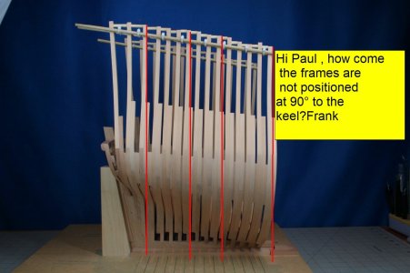

Anyway, here's way too many pictures of the butt end of a ship model:
Yes, I know I'm not the first guy on the planet to fair a few frames ROTF - but I'm strangely delighted by this particular outcome considering the dark places I traveled through to get here.

Hi Paul , how come the frames are not positioned at 90° to the keel?Frank
Hi Frank. This is an excellent observation! Mr. Lemineur believes the frames tip forward 1.2 degrees. Many people have challenged this conclusion but since his plans show this unusual feature and I am trying to faithfully follow those drawings I have reproduced his design.
This feature makes it very difficult for me and I wish the plans were not drawn in this way - but they are.
Again, my admiration that you have noticed this unexpected design feature.
Bye Paul , Thanks for answering me, in the monograph the frames are perpendicular to the keel but , it is too strange this that position, if anything it is the keel that should be positioned differently from the baseline.Frank
As you already made a ramp of 1.2 dgr under you keel, the frames are not tilted ……;) Rotate that part of the drawings 1.2 dgr counterclockwise and they are standing correct ……:) in opposite of the waterline. It’s common to build the frame perpendiculair to the waterline and the constructor determines how much trim they want to give the ship/keel.

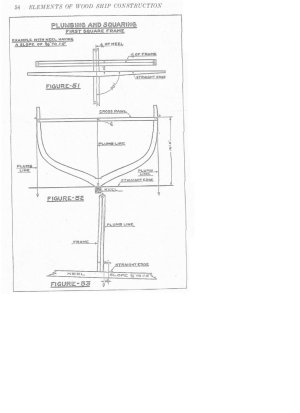

This is all about the ‘trim’ of a ship.
Here’s a interesting article: MaritimePage
The main conclusion:
The term “trim” refers to the fore-and-aft balance of a ship It is the difference between the draft forward and aft. When a vessel is properly trimmed, her stern sits lower in the water than her bow, which gives her more speed and maneuverability. The word “trim” can also be used to refer to the act of adjusting a ship’s ballast to achieve this ideal balance.
Maarten @Maarten also wrote about thatin post #15:
the draft on the rear is more than at the bow
Hi Peter, I respect Your intervention but I stand by my interpretation ,the “TRIM” has no relevance to axial construction.Frank
