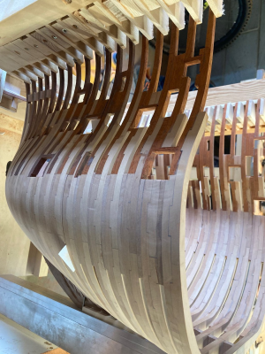

I asked one of my modeling buddies about cutting gun ports in wood and he thought this might be useful. Though it is quite expensive it requires less pressure than, say, an xacto knife. The chisel and the double edge blade are shown used with broaching in plastic, so I am wondering about broaching in wood.
Thanks, Rob. That's a really interesting looking tool. Who knew that handheld ultrasonic cutting was even a thing? I join you in wondering just how effective a smooth blade would be cutting hardwoods - but at that price I won't be finding out. I'm halfway done now and getting good results the low-tech way, so I'll just muddle along.

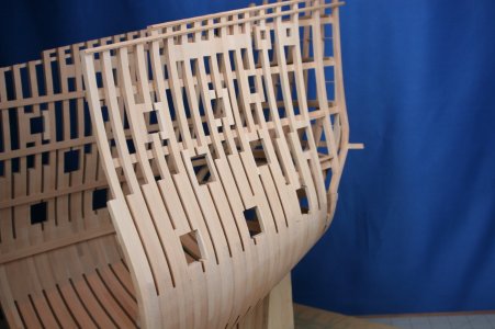

Good morning, just for your information, gun ports have a very specific position in terms of size and location on the hull, and not all gun ports are the same size. Frank
Thank you very much, Frank. I have carefully measured the plans and think I will be able to get the locations and sizes very close. I appreciate that you took the time to confirm this with me!

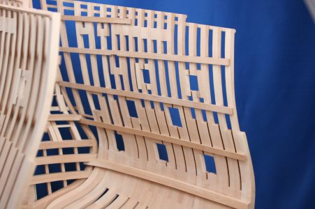

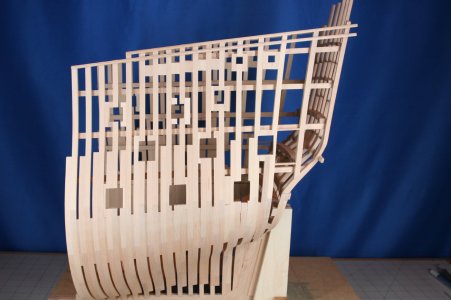

Well, that was a lot more work than I anticipated...
The rough-in of the gunports (and lights) is now complete:

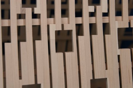

Inexplicably I made all six of the first deck gunports too wide. In trying to reconstruct how that happened it seems that the initial measurement was wrong as every port is too wide by an identical amount. It is also true that the monograph specifies one width, and the drawings show a different width. Unfortunately, I must not have caught that difference during the research stage.
In any case my solution was to insert a thin fillet - the planking will make this repair largely disappear.

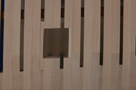

A first deck gun port:
A second deck gun port:
