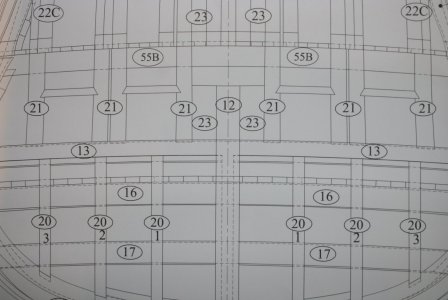

Paul I only have the Bonhomme Richard drawings to compare to it, so I don't know if it helps but it has these fillers in there with a straight vertical round cutout in them.
Back view:
Plan view of lower gun deck
side cross section:
plan view of the main gun deck

That makes a lot of sense, Rob. Thanks for taking the time to share these images.

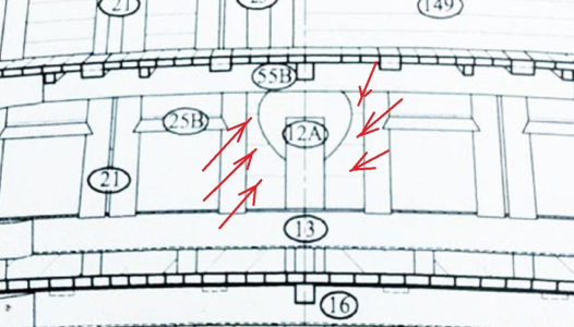

I agree. The entire space (Helm-port) was filled with wooden inserts.
It's just that this drawing in the book is very poorly drawn. There really were wooden horizontal inserts. They are visible under very high magnification.
This was the case on all ships.
This is also described in Boudriot Jean. The Seventy-Four Gun Ship. Vol. 1
View attachment 545309View attachment 545307
This is very helpful, Iutar. I am at work right now but when I'm home I'll take a closer look. Is that Plate 5? If memory serves, my drawing is somewhat different (?). The production model clearly shows the fillers - but how do they relate to the top of the stern post?

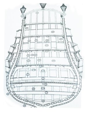

Thank you again @iutar for posting this drawing from your 74-gun monograph:
Here is the (same) drawing from my SP monograph:
As you can see the detail of the opening for the head of the rudder is conspicuously absent. I confess that this recent finding has not restored any confidence I should have in the accuracy of JCL's work.
Regardless, I will proceed according to standard practices and include the fillers.
Dear Paul! My drawing is not from the book about the 74-gun ship, my drawing is from your monograph on the SP! Here it is, larger.
Ah! I see it now! You are showing plate 18 and I am showing plate 5. How interesting that they are different depictions of the framing (yours at station 31 and mine the stern facade). My humble thanks as I learn how to handle these drawings.

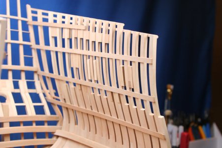

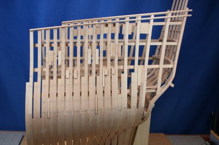

I would love to report on the magnificent progress I have made since my last posting - but mostly I have been installing 'fillers' that are a necessary addition to the framing to accommodate the gun ports. While necessary, I have found this phase of the build to the remarkably unsatisfying.

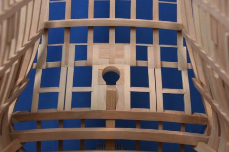

I have also roughed in the helm port and fillers associated with this portion of the framing:
This last bit will require some additional fine tuning (fairing / sanding) but that will need to wait for the fabrication of the rudder...
It's great that applying these 'fillers' builds up the tension until the 'moment suprême': setting the saw in the frames. It's bound to happen sometime... ;):rolleyes: But till now your work looks very nice, Paul.
