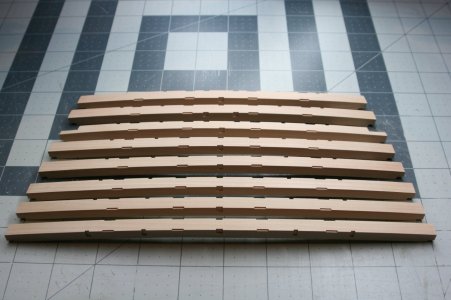

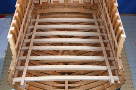

Picture 5 looks just like the cutaway drawings in the SP monograph - everything so clean and orderly. I’m not sure whether they are also called breast-hooks (straddling the stern post), but I love the ornamental end-cuts you did here, that are tapered according to the placement and geometry of the part. Leetle, leetle details, layered one over the other, always carry the day.Hello Friends,
Some time ago I began wondering what sort of finish I should put on this stern section model. I looked at a lot of other builds and did all kinds of trials with all manner of materials. I happen to have real Bitumen of Judea (banned in the US) from when I was tinting ropes for my version of the Vasa and noted how some of the models I am aesthetically drawn to incorporate that to create an aged look. Michele Padoan and several of the Russian/Ukranian/Polish masters use this. I believe Sergey (@serikoff) will be finishing his current project in that aged style. There is a lot to like in this approach, and it is always what I envisioned for the Saint Philippe.
Well, I didn't end up doing any of that. I ended up using a concoction 'invented' by fellow forum member Russ (@RussF). In equal proportions I mixed pure tung oil, a gloss marine varnish, and a solvent (I used turps, but others worked just as well).
Here is why I went with this mixture: pear wood reacts beautifully to oils. I used polymerized linseed oil on my Vasa (my avatar). Tung oil is even more impressive but takes FOREVER to set (does it ever really set?). By mixing tung oil with varnish the set time was dramatically reduced. But those two things alone create a mix that is sort of thick. The solvent corrects that problem. As mixed you can literally see the concoction soaking into the wood.
BUT!!! Unlike straight (well, cut with a solvent but nothing else) linseed or tung oil this mixture only penetrates a short way. I have samples with straight linseed oil that soaked through 8 mm of pear wood! I do not view this as an advantage. All finishes impede bond strength. You literally cannot scrape or sand away enough wood to get past straight linseed or tung oil. But this concoction only penetrates a short way. If I need to scrape it away in the future I can get down to relatively raw wood (I suppose there is still some oil in it, but it looks very much like untreated pear wood). I love this possibility.
Enough talking. The following images show where I am at today... I did tape off the deck clamps, larger gun ports, and some locations where light beams will be placed in the lower part of the hold. I also did not apply finish to the exterior planking or the stern post (and probably won't until I am much further along with that part of the build).
One small downside to this concoction is that it cannot be reapplied (for example, 24 hours later). Unlike a pure oil finish, reapplication just sits on top of the cured surface (it no longer soaks into the wood). Indeed, it ends up being shiny and I am not a fan of shiny of a ship model.
Oh, by the way, I have also done some recent trials by dissolving Bitumen of Judea into microcrystalline wax. That paste can then be applied to what you see above if I want to add some aging after all. We'll see...
Sorry about the lengthy narrative...
You have a keen eye, Marc. There are some departures from the monograph but if I understand what I am looking at (no more than 80% of the time do I understand - perhaps less) I assure you every effort has been made... In this case I didn't understand until I began making the part then geometry forced the correct solution.Picture 5 looks just like the cutaway drawings in the SP monograph - everything so clean and orderly. I’m not sure whether they are also called breast-hooks (straddling the stern post), but I love the ornamental end-cuts you did here, that are tapered according to the placement and geometry of the part. Leetle, leetle details, layered one over the other, always carry the day.
