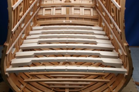

Since I now had the beams fitted I could fabricate the beam knees. I ended up making cardstock patterns and roughly cut out paired knees. Obviously, these will need to be further refined before installation.
I then laid out the various cutouts on the beams themselves:
Since I'll be doing quite a lot of milling, I fabricated a jig to make that work reproducible and efficient:

Making cardstock patterns, using a jig for milling for productive and efficient work, making nice overview pictures ……. You made some very nice progress with this build, Paul. With a beautiful outcome on those beam with nicely aligned notches.
The jig is a great way to cut mortises perpendicular to the curve of the beams!

Thanks, Brad. I'm not sure how the professionals cut the mortices on the beams - but this is my current best solution....
Simple, yet effective — bravo, mon ami! I’ve always said the best tools are the ones that work and give results, not the ones that merely shine on the shelf as collectibles.
If I had more confidence I would probably use these tools more frequently. I will say my little clamping jig made the set-up for each cut very simple.

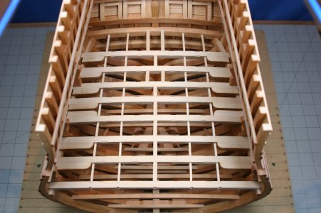

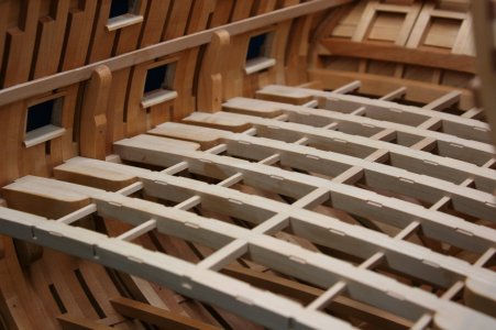

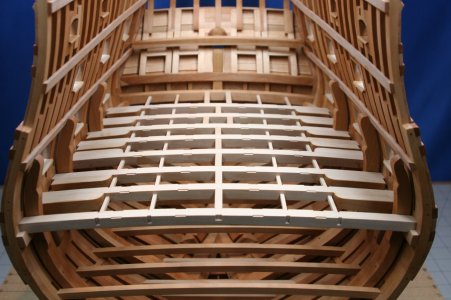

Having test fit the lower deck beams I was able to begin installing them along with the (now fitted) beam knees. During this installation I was able to re-install the rider frames.
You will see a space between the vertical portion of the beam knees and the hull. The knees would ordinarily be fitted to the planking on the inside of the frames, but that planking is absent on my model (thus the space). Nevertheless, I still added mounting bolts to the knees which is sort of nonsense given the space but...

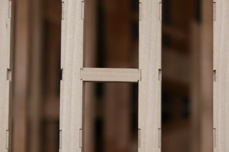

Next, I added the carlings (oddly, these longitudinal elements are placed at the vertical center of the beams rather than flush with the top of the beams) along with the dovetailed coamings and centerline spacers. These latter elements are only roughly fitted at this point - the joinery will need to be improved before final installation - but that can't happen until the ledges are fitted (also with dovetails). This will all make more sense when I show the installed ledges (probably in a week or two barring the unforeseen).
The French design makes deck fabrication tedious - my respect to people who are building full size ships and are choosing to include these details. The thought of doing this work for the remaining four decks is daunting - even on my stern section model.
I appreciate that you have taken the time away from your own work to visit.
Those dovetail joints are incredible!!
I see the bolts going into the (imaginary planking). Gives new meaning to "hanging" knees:D! They look great and it was a good choice to include them!

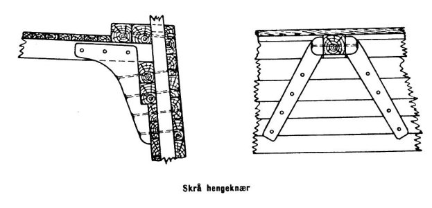

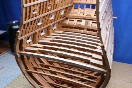

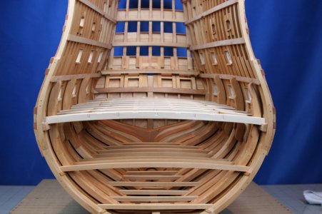

Question: Did the plans show bolts on the knees (parallel to the keel) which connected them solidly to the beams?
I placed them on my Bonhomme Richard build (photo and sketch below).

Your work is simply stunning. Somehow, I never get alerts to your post, even though I unwatch and rewatch every time I visit. I will continue to check your log, in the hopes of new post/photos!
Good morning Paul. Brilliant as always. Man you have thought of everything and willing to have the patience to include them. E.g. the spacing on the vertical knees where the inner planking would be. Respect. I don’t know how you achieve such perfect notches and dovetails but they make wonderful viewing.
