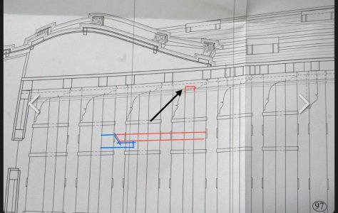

I read through Waldemar’s contributions to your build log, and I do believe that his interpretation of the drawing is correct; that the ends of the ledges would be let into the horizontal knees.
I also think he is correct to state that these unnecessarily heavy components would likely have been omitted in the superstructure, as the French were, by this time in 1693, keenly aware of overloading with top-hamper.

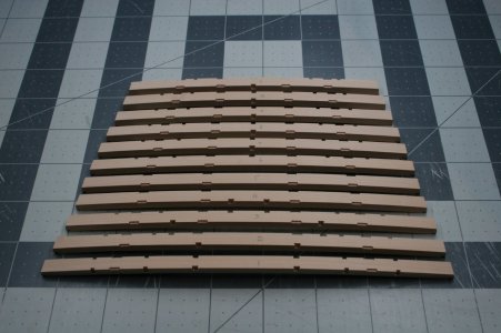

Just for you guys :) - here are the freshly installed knees:
As you can see, the knees on the second deck have decorative ends:
Including on the vertical elements:
Carlings and ledges will follow...
Thanks for stopping by!
