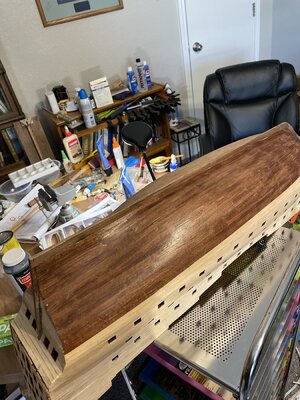

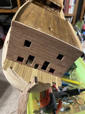

Thanks, Tony. First coat of polyurethane is on the port side. Waiting for putty to dry on the starboard side.
Oops, I found a couple of places I missed with the putty. I’ll sand lightly, fill with red oak putty, sand again, wait 24 hours, and poly again. I love the look, though.
Later, I’ll apply second coat of polyurethane.

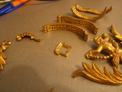

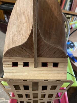

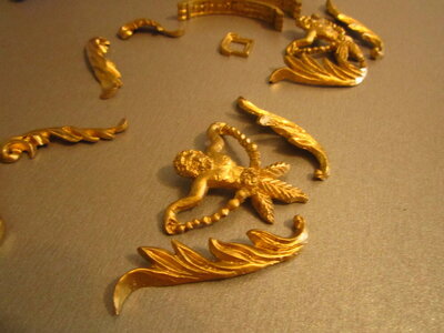

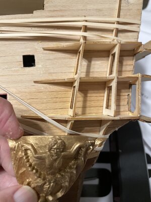

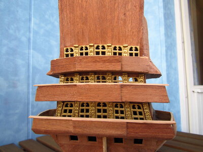

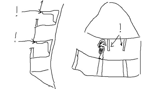

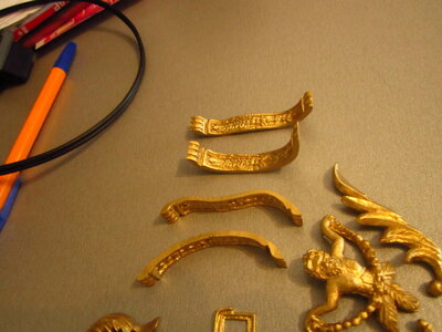

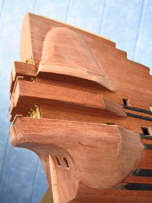

I'll try to help you.First I'll ask you if the decor is made of resin or metal?If made of resin, the task is simplified.I just cut out the whole decor separately from the general piece.I hope this is clearly visible in the photo.Next, I advise you to fill the upper and lower parts with scraps of slats on glue.Where there will be an open balcony, I cut off these lintels.But only after gluing in place.then it is necessary to sheathe the flooring of the upper and lower tiers of balconies.I don't know if you'll understand me through a Google translator.I will also advise you to put consoles under the flooring of balconies to support platforms.Approximately opposite the decorative men on the edges of the balcony railings..Make them also some kind of curly , beautiful

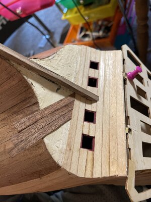

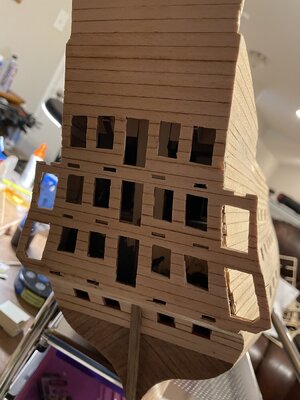

Hi Vic
I indeed had quite a struggle to install the balcony
I had to shorten the vertical parts and do a lot of adjustments to make it fit nicely.
