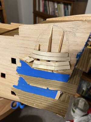

Yours looks good. I may wind up redoing the whole thing. Who knows. I also looked at the curved supports that go between the aft chaser guns. Maybe I’ll just have the one end stick out on the bottom. It’s weird looking, but I don’t know if I have the heart and guts to cut and bend all that metal and leave it looking mangled.This is what I did. Got tired of fighting it. The castings will eventually be reduced as much as possible and will be inlaid if I have to. There will also be some modification to the "bell" as I go along to get the castings to fit. I originally didn't like a whole lot of the ornamentation hanging off in space. I realize Mr. Deep will poo poo it, but, what the heck. I've seen many variations of this thing on line. So, this is my version. Aren't instructions just supposed to be a "guide"? Plus, I'm really not sure if anyone knows what this thing originally looked like?

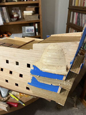

That’s a thought, alright. I don’t have any and I wanted to try doing it the way the instructions show.would epoxy putty do the trick rather than using wood? It is sandable and can be molded before it hardens. Just a thought...
I have had reasonable success in the past with that stuff. The one I used was even paintable.That’s a thought, alright. I don’t have any and I wanted to try doing it the way the instructions show.
Looking good VicPort side done. I’ll wait till the putty dries and then sand it. I think this will do. View attachment 268553
I dry-fitted a decorative pillar with the shape of a woman next to the rear of the bell before building the bell. Do you have enough room on the right for her with your bell? I'm finding I have to take a whole bunch of things into account before construction of some of these elements. The ornaments are especially giving me fits.This is what I did. Got tired of fighting it. The castings will eventually be reduced as much as possible and will be inlaid if I have to. There will also be some modification to the "bell" as I go along to get the castings to fit. I originally didn't like a whole lot of the ornamentation hanging off in space. I realize Mr. Deep will poo poo it, but, what the heck. I've seen many variations of this thing on line. So, this is my version. Aren't instructions just supposed to be a "guide"? Plus, I'm really not sure if anyone knows what this thing originally looked like?
I was planning on "shaving" down the right side to make her fit and repaint, touch up. Or shape the figure a little bit. Plus, looks like it needs to be shortened. Kind of going by the seat of my pants.I dry-fitted a decorative pillar with the shape of a woman next to the rear of the bell before building the bell. Do you have enough room on the right for her with your bell? I'm finding I have to take a whole bunch of things into account before construction of some of these elements. The ornaments are especially giving me fits.
