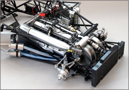

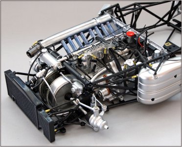

On Dean's advice, @Dean62, I tinted most of the bolt heads. I sprayed the intake airbox and the intake pipes. Not that they've discolored due to the heat, but it looks a little different. I gave the outer radiator lines a very light wash so the black is just a bit gone.
The exhaust manifold has discolored considerably due to the many rides during which the journalists thoroughly tested the engine:
The two pre-mufflers for the exhaust cool the fumes nicely.

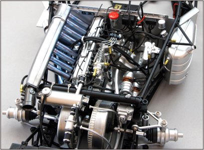

The exhaust manifolds are just visible:
Not everything will be visible later, but it was fun to do, just like with the exhaust on my last Duc.

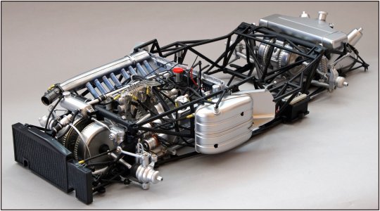

This is the current standing at the end of group 2:
More parts will be added to and on the engine later.
