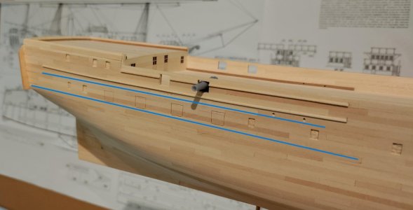

All of the waterways are aboard - pics of that later. More pressing is the external colour scheme.
This is the real L'Orenoque btw. Yellow arrows are rub rails and I have marked their locations on the hull:D:D:D:D:D in preparation for attaching them

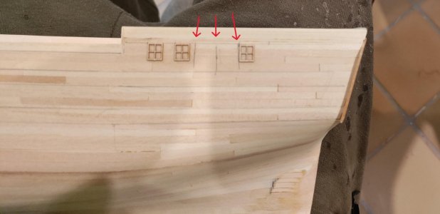

Green arrows - I'm going with the same size windows as I used in the poop deck façade - Hey! I gave them 3/16" extra headroom so why not bigger windows!
Orange - that is where the black paint goes - including the rub rail
Blue - that is going to be "wood" colored - can't wait to see it!
Now the tricky part - Red - I'm thinking about painting those two bands red
So from top down - black, red, wood, red, black, and some nice shiny copper below the waterline!!!!
Thoughts?

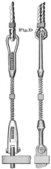

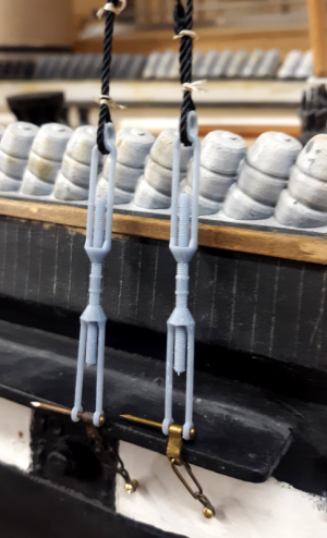

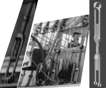

I have been looking at my L'Orenoque plans and comparing them to the kit plans, in this instance - was the real ship rigged with rigging screws of some kind? rather than the deadeyes the kit shows? And some one please look at the attachments for the mizzen lower shrouds - looks like chain plates attached to the hull with no channel to me. You?
View attachment 532302View attachment 532301
Welcom to the world of different plans and different interpretations, Church. I had the same with my Bluenose. You have to choose the outcome that you like the best, according to the design of the kit and it’s parts.
Otherwise, you'll have to adjust the design and make material choices.
I didn't consider that a big problem, and actually quite a challenge. I already see above some directional ideas from you passing by with the input of others. That's one of the advantages of a build-log.
On Constellation, I constantly looked at the portraits of her thinking that the artist was just lazy when it came to painting the dead-eyes and lanyards; but in every portrait? In photos starting in 1879, no dead-eyes and lanyards. Obviously I couldn't claim the photographer was just lazy. Then, looking at her 1856 portrait trying to determine the where and how many of rub-rails she had on her hull got me to looking at photos for a better view and I realized the ship had rigging screws from the beginning up to about 1900 when she got deadeyes and lanyards. On the right of the pic is the 3D model I developed of it.
I found one reference to the things on page 608 of a manual, though (I forget which one)
I looked into having them made (lost-resin casting) but the 60-or-so I need in brass, bronze, or even aluminum would cost over $1k. So I 3D printed them
As you've learned Chuck, you often find what you're looking for on another boat, and looking at Civil War period photos, where any part of them can be seen, you find rigging screws, such as this image of Farragut on the Hartford
Rigging screw in French is vis de gréement

Peter! Thank you for sharing your experience! Yes! Without this log, and those of others, I'd have built the fictional L'Orenoque like the floating hotel the designer imagined. The collaboration that happen on this forum is the perfect expression of the saying "a problem shared is a problem halved!"
Blessings.
Chuck
I have mid 1830's for screw shackles along with wire rope, so it's probably correct for your 1840's build ,Sphinx runs deadeyes in 1829 whereas L'Aigle runs shackles although that is much later. So , are you going to build a dancefloor on the Orenoque ?
Martin! Rigging shackles it is! Of course my L'Orenoque will have a dance floor!!! Why do you think I went to all the trouble to close that gaping hole in the deck, plank her like I was laying a parquet floor, and abandon the idea of building an apartment block smack in the middle of it all? ROTF ROTF ROTF
Jerry! Up to your old tricks, I seeROTF As usual, your expertise is amazing! Thank you for the photos! They will come in very handy as I try to make something to indicate a rigging screw. At 1:100 scale, I won't be able to show much detail, but I hope to end up at a place where someone looking at the model will see a rigging screw.

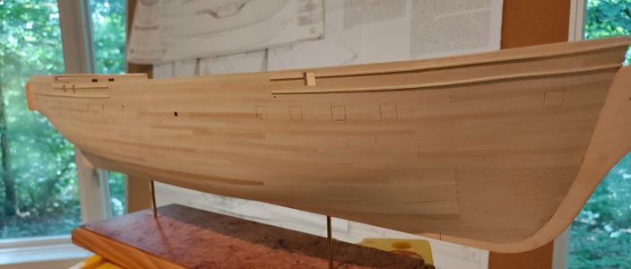

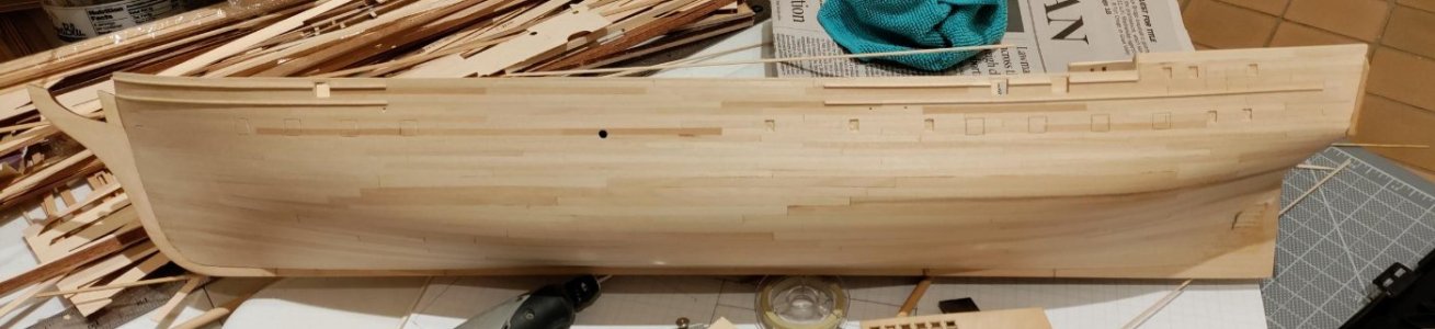

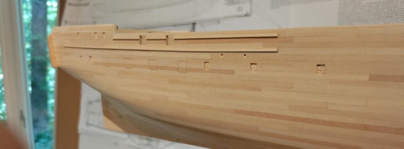

Well, despite my impulsive desire to oil all of the wood and get on with the painting and plating of the hull, I found as I was working outboard that the better part of valor is to finish the outboard work before I oil, pain or plank anything. You knew I'd get thereROTF
So, at this point the main deck gun ports are cut out, the windows are carved in and the lower deck gun ports are indicated. I used indicated on purpose.
Here's what the kit plan calls for (other than a floating bordello :eek:). You see below the number of windows and the really prominent gun ports. Also, yuk! Note that the most forward gun port is not as far forward as it should be according to the actual plans for the ship.
Initially, I thought to carve out the spaces and add gunports. While I was carving the spaces for the windows, I thought - that's dumb. Just indicate the ports by outline. Once that potion is oiled to bring out the wood color, paint the ports black and add the hinges. So no need to go to the labor of carving away the wood at the risk of really screwing up!
Here she is with the expeirmental placement of the larger windows - I thought they were too large and went with the smaller ones - Good choice, Chuck!ROTF
The red arrows show the lay of the shrouds for the mizzen mast. On that note, according to my measurements, a channel is required so that the shrouds pass outboard of the railing on the poop deck. See posts #234-236 above.

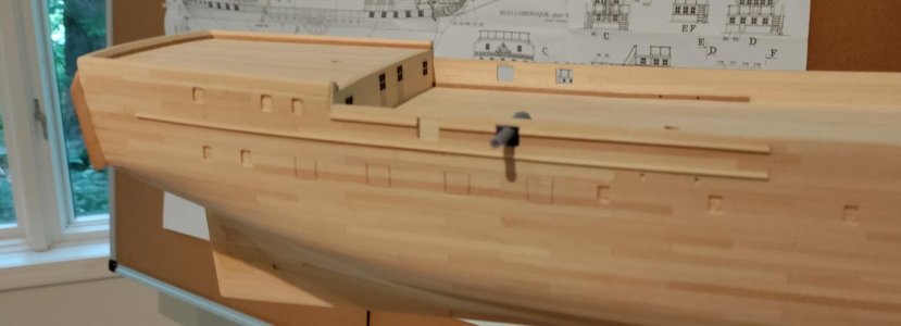

Now several views port and starboard. Red arrows indicate the windows based on the 1847 plans. Blue arrows the lowr deck gun ports.
Port side - the money maker!
And below, some close-ups. I added scuppers, but based on the rulles of scupper placement, there are darn few places for them. I also have the rub-rails aboard. I'm not sure, but they seem quite pronounced. I may sand them down quite a bit until they look right.

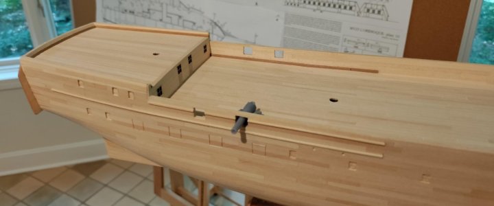

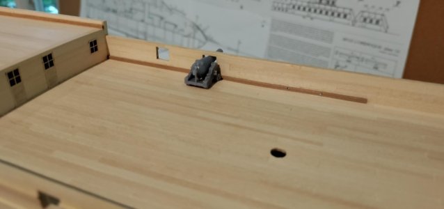

What about the guns on the main deck? We'll know soon enough my dears ROTF
I was a bit concerned about cutting the main deck gun ports. I did it figuring that the guns, courtesy of Todd's Small 3d Print Cannon Foundary, would probably fit as per plan. And since I hadn't oiled or painted anything, I could add back any necessary wood to make things look right. Never the less, I put the Dahlgren in place to confirm my beliefs. I think everything will work out just dandy! Notice that the Dahlgren seems even more overscale.
Between the blue lines is the line for the "wood" colored strip that I am using to replace the white that should be painted there. Of course the wood strip will folow the curves better than the computer generated lines.

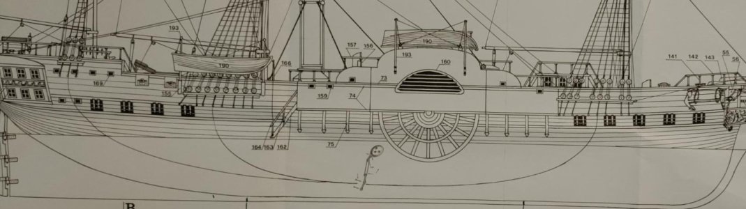

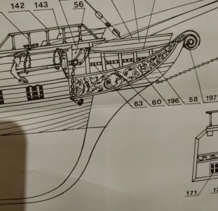

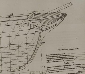

So, shipmates, having decided to make almost all of the outboard parts before any of the fun begins (yes, my idea of fun involves oil and paint ROTF), I am going to work on the head next.
First pic is what the kit plans describe. Second pic is L'Orenoque as planned in 1847. I wish I knew how to display them side by side, but I'm sure you see all of the ornamentation from the kit - thus my earlier remark about floating bordello (I'm also talking about the large hotel that was meant to populate the main deck). Also, seems to me that the kit has a variety of objects lower than they should be, like the hawse pipe (one when there should be two btw). Note also that the kit omits the rub rails. For me, in addition to being indicated on the original plans, they add visual interest and help properly locate things like the cat head and the boomkin. So, making the head look like the plan rather than the kit is my next mini project!
