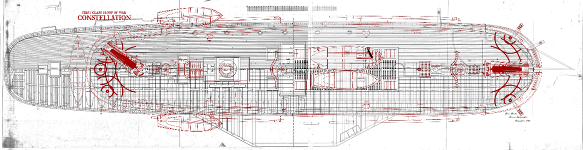

As you know, I am working towards as much historical accuracy as I can manage given the terribly thin source materials. Really, it is a miracle that I found the cache of plans at the start of the build. With that in mind, there was a draught of the USS Missouri in the French archive where I found L'Orenoque's plans. Here's a view of the Missouri or her twin sister Mississippi. These USN steam frigates predate L'Orenoque by about 5 years. I'll take a look into my resources on these ships and see if I cant find some help there. Seems to me that there's a family resemblence to their younger French cousin. Jerry @JerryTodd , thoughts?

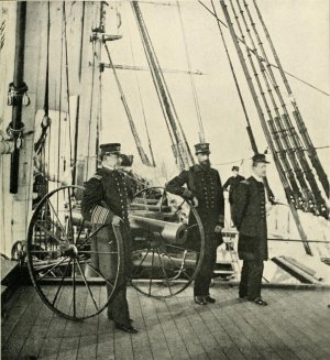

All I have on the Mississippi is a spar deck layout with Constellation's laid over it.

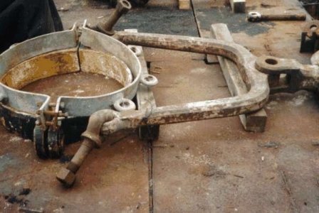

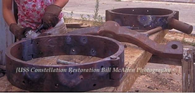

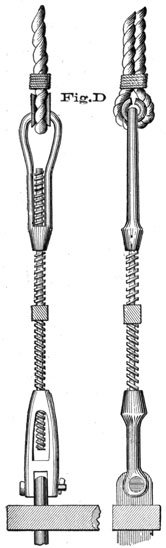

pg608.jpg As for rigging screws I found an image in a manual recently.

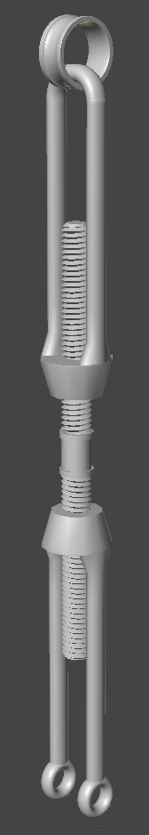

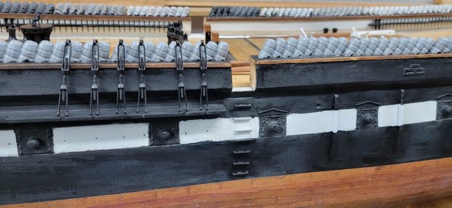

But I 3D modeled one based on photos of Constellation in the 1890s, and printed them for my model

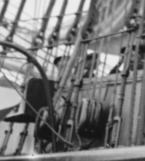

I see glimpses of these things in many CW era photos, usually peeking over hammocks in some group photo on deck of ships such as Hartford. Sometimes you can make them out in photos of ships, but I've yet to find a good clear photo.
Anyway, I don't know how well they'd scale down to 1:100, I may have to fatten them up some for it to work. If you're going this route, I'll take a shot at it.
View attachment 556642 As for rigging screws I found an image in a manual recently.

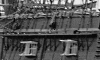

I have been back over the photo's we already dug out, and here's my observations ;
the pitching deck picture shows almost exclusively hemp ropes apart from chain stays to the funnel and possibly a chain halyard top right for a topsail or topgallant.(to be taken with a pinch of salt)
the gomez photo looks like possibly having sheaves fitted in the yards , which almost seem to have the shape of steel yards ? Does not appear to carry jackstays

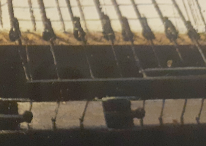

ne_sai10.jpgthis one shows either rigging screws or disconnected deadeyes depending whether you have your glasses on ! and i just found this, which is the british mail boat MS ORINOCO !!caused me some confusion!! built five years before the French version which seems to have jackstays fitted , judging by the sail furling ! (note twin funnels)564540663_26066968402903499_320673434484374902_n.jpg

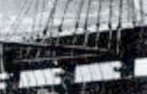

This looks more like deadeyes to me. rigging screws would hardly be visible.

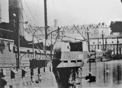

I'm still pondering the rigging question. Last night I found this image of the French stern screw frigate Clorinde circa 1843. It occurred to me to try to find pictures of ANY French Navy ships from that period to try to puzzel out the answers. Also, since (GASP!) no one chimed in on whether upper mast shrouds should be set up with rigging screws if the main shrouds use them (GASP! GASP!) I guess no one knows the answer ROTF
I also looked back trough McArdel's plan set for USS Susquehanna. She is rigged with deadeyes.
Here's Clorinde. I think I see deadeyes. What do you see?

The image is not complete sharp. So if I focus in it becomes blur.
But from this view it look likes deadeyes.

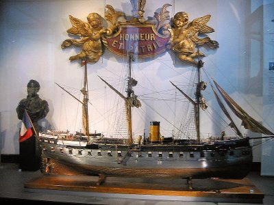

Here's a picture of La Gloire model at the French Maritime Museum. Again, deadeyes, I think. Here's my thinking: If this epochal ship used deadeyes why would L'Orenoque have rigging screws? Also goes to Martin's point about the French Navy being delayed in accommodating the rigging to modern times.
Thoughts?

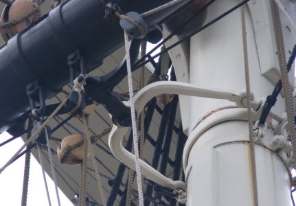

Period painters, even those that had been Naval officers, suck at depicting details such as rigging screws, even deadeyes & lanyards. The Impressionists were taking over the art scene, and their influence was ruining art for us folks looking for the details.

I can't speak to French ship-fitting policy, but rigging-screws were fairly common on US sloops and frigates in the decade leading up to the Civil War. The Patent Truss, which was a standard fitting on clipper ships, had found it's way onto warships as well. Though you can't see them directly, they seem pretty apparent in the image of the Mississippi under-weigh posted above.
(Chuck, I am using the same screws for the topmast shrouds as for the lowers.)
