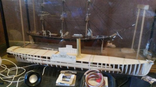

Welcome back. Looks like the usual kit mix of good and bad, we will see later what the fit is like on the precuts. It looks quite modern to me who is used to buying old second hand stuff. Personally i don't mind if it is a bit fantasy , i just love that steampunk look , reminds me of chitty chitty bang bang from my childhood !
I should be ok for the L'Aigle plans, i have put the hull frames together from what i have found on the net (photo) and i will see later if i need to buy the full set or not. It's a long term project ,that one, i have so much else going on ! I am slowly collecting bits in the right scale. On the other hand i was pleased you mentioned Winfield and Roberts, as i did not know of it and unfortunately my adopted french compatriotes are a bit short on decent documentation. I will buy it as it will be handy i am sure for several of my projects.
next to my Cutty, same scaleView attachment 522583

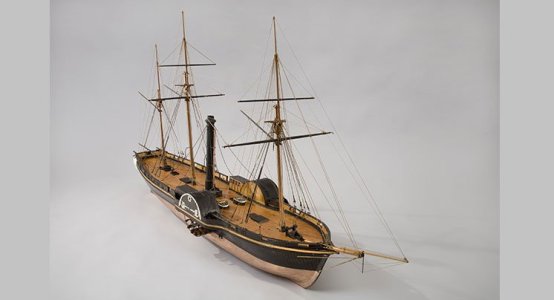

I have been able to find additional pictures of the Sphinx model and I found pictures of the Meteor model. Although both predate the Darien class of steam frigates, they are useful in understanding how these ships looked - paint scheme, rigging and what I can see of the deck. What I'm really missing is information about the actual deck plans for any ship in the Darien class and there were 14 of them. L'Orenoque was in the final group which included Groenland, Montezuma, Panama, Albatross, and Labrador. Perhaps some of your compatriots can help?

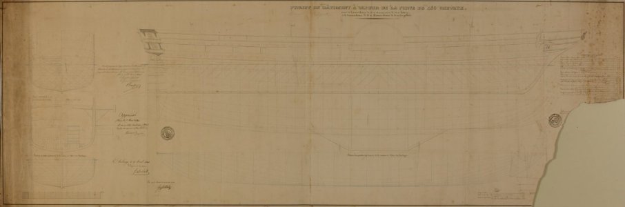

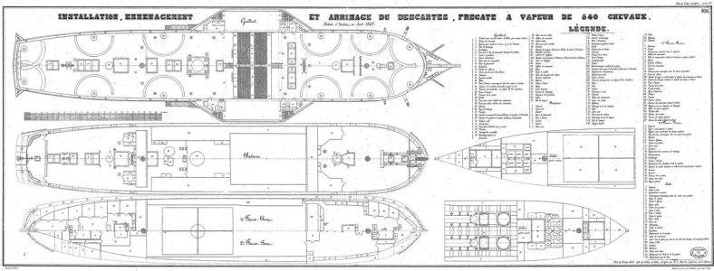

still looking. a couple of photo's and a deck plan of the Descartes/Gomer, which i beleive is the same series but with slightly different modifications (Group 2 against the Orenoque, Group 3). Note that these ships seem to have changed names on several occasions , and the originally proposed 450hp engine was swapped out for the 540 horse in march 1841.

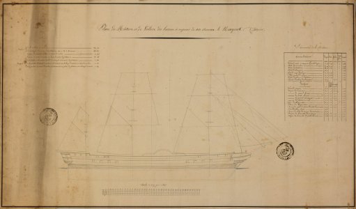

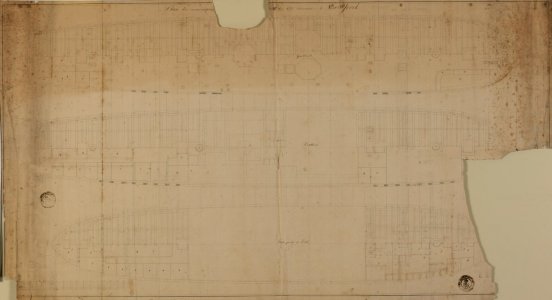

Did put this out in france, this is what has come back so far, not very clear , but looks original. This would be pre-production.
View attachment 522763View attachment 522764View attachment 522765
Martin! Thank you! These images are extremely helpful! The deck plan of the 450 steam frigate New Yorck and the illustration of the Darien's deck plus the other images we've found have confirmed that the very busy deck of the kit is pure fiction. Excellent! The idea of a large pilot house somehow got into the kit designer's head and he went with it. But it was never a part of this class of ships. Unfortunately, the kit is designed with a huge square hole in the middle of the deck which is meant to be covered by the pilot house. No problem - I'll get by:cool:

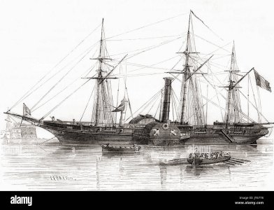

Here's another example I found of a ship resembling the Darien Class and below her a drawing of the Sphinx, corvette. Both show that the ships carried their boats aft, the smoke stack and main mast aft of the paddle wheel boxes and NO DECKHOUSE in the middle to clutter the decks.
the-french-corvette-the-sphinx-built-in-1829-she-was-the-first-operational-JT6778.jpg
Here are pics of Meteor -
On another note, I'm sure you noticed the handwritten "Darien" on the plan - that's because the New Yorck and the Darien are the same ship. New Yorck was initially the a part of the French steam ship line with service to the "new world" when she was launched in 1842. She was renamed Darien when she entered the French Navy in 1847.
What I really like about the Darien rendering is the bridge spanning the deck - no deck house. The view, however, is somewhat confusing. Neither the main mast nor the smoke stack in this class of ships was in line with the paddle wheel boxes. Moreover, the main mast was always well aft of the smoke stack and the fore mast was well forward of the paddle wheel boxes. I'm thinking that the artist was portraying a view from somewhere near the mizzen forward. I say this because the sterns of the ships boats are showing. BUT - I haven't seen a plan or other visual representation of this class of ships that showed them carrying their boats forward of the paddle wheel boxes. I imagine that the artist was primarily trying to capture the effect of the rough seas on the crew and so was not particularly careful with perspective (among other things). But I can't accept that he/she exercised their artistic license to remove a large deck house.
