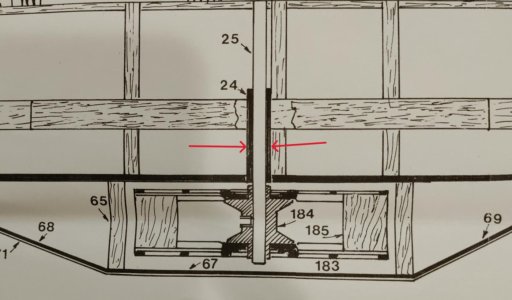

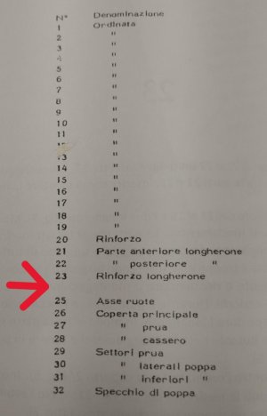

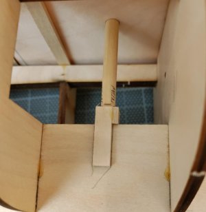

In this kit parts on the wooden fret are numbered on the plans, but not on the parts themselves. So, transfer the info from the plans to the parts. Check! Next, according to the instructions, the build proceeds in order of part number. Check! Parts 1 - 23 get you to the point where the keel is assembled, the frames are aboard, and the structural beams are aboard. Check! On this kit, the paddle wheel's are complete wheels set on an axel that passes through holes in the structural beams (make sure these are properly aligned!). That axel is part 25. The instructions refer to a "bushing" called "part 24." So, I began looking for "part 24." I'm not saying that the search for "part 24" stalled the build, but it really bothered me. "Part24" appeared on the plans as a further support for the ends of the axel just behind the planking. On the other hand, the parts list doesn't list a "part 24"
This gives some idea of the quality of the instructions.
So, despite the instructions and the plans. "Part 24" does not exist - at least as far as the parts list is concernedROTF
So, I decided to get by without "part 24." I don't think it is a necessary part. The axel is very stiff and fits through the holes in the structural beams and in the hull planking without problem. So if you find yourself building this kit, like the parts list, just skip "part 24" and move on.:cool:

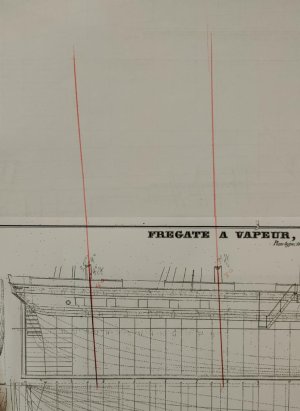

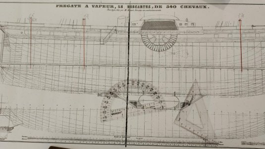

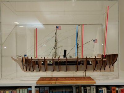

I'm not going into detail about the mystery of the rake of the masts - here's how I determined the rake and what I did to make sure that the masts had steps so that once aboard they would keep their angles:
First pick is a plan of the Descartes showing the rake of her masts. Again - strange to me that no other plans I could find including L'Orenoque show the rake. Second pic shows the relative extremity of the rake, particularly the mizzen.

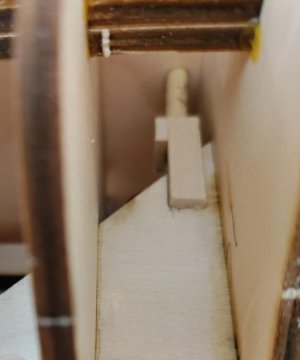

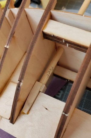

Future builders - be sure to build the mast steps! The instructions say nothing about this necessary connection point to make sure that the masts take the correct angle of rake and maintain it. The steps also secure the masts to the keel. Otherwise, what? You put a bunch of glue through the hole in the deck and hope for the best?LO mast step fore.jpgLO mast step main.jpgLO Mast step mizzen.jpg
Here's what it looks like all aboard. The red lines are to help see the masts. L'O is in front of Harriet Lane. The are set at almost the same height and you get a good idea of how much bigger L'O was. The blue line helps see that the rake of Harriet Lane's main and L'O's main are very similar.

I wonder why masts would need to be glued in place. Mast steps I get, not the masts
Jerry! I get your point. These fit quite snugly in their steps and the masts are in line and properly raked. The shrouds should do the work of holding them down without glue. Nevertheless, I glue them in the steps and at the deck - I don't trust myself not to dislodge them during the rigging process. ROTF

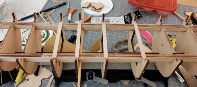

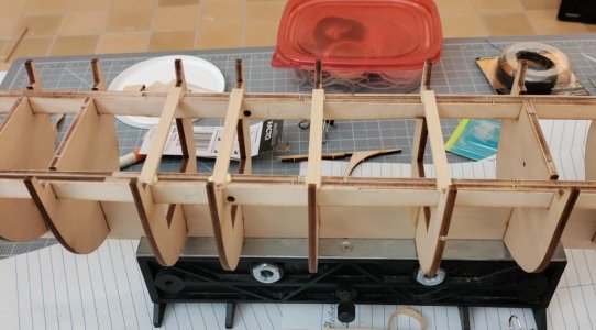

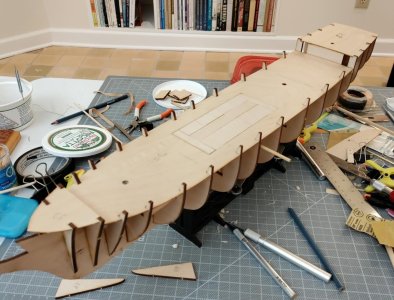

Finally - fixing the unnecessary hole in the deck.
Unless you're planning to motorize the paddle wheels, the huge rectangular hole in the deck and the way the frames under the hole are cut out serve no purpose that I can tell. There is a large deckhouse, according to the kit, that covers this hole. But still, why such a big hole with no support for the structure you're supposed to cover the hole with?
In my case these mysteries (I know one of you will say the explanation is cost of manufacturing the kit ROTF) need no answer. I'm not including the fictional deck house complex. So - close the hole and install support beams for the deck.
I was able to piece together enough material from the leftovers of frets of the same thickness as the deck. I used some left over material 1/32" thick material from Harriet Lane as backing for the upper layer. BTW - you probably already know, but one should keep the "excess" material from earlier kits (unless it's plywood:mad: ) because it might come in handy in some future build;)
