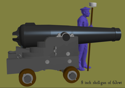

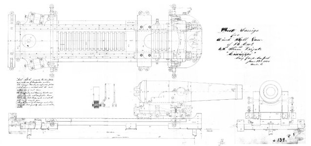

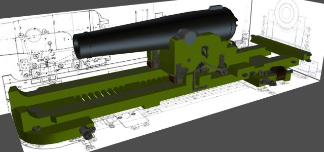

I have 3D models of the Mississippi's 10in pivots, and 8" shell-guns ready to print ;)
mississippi_shell_gun.jpg pivot_gun20200713b.jpg 8inch_shell_gun20240306.png

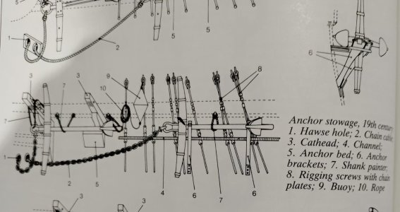

No expertise on the cathead/anchor issue. I would assume one cathead was the norm. The second (backup) anchor would be tightly secured.
IF the main anchor was lost or not holding, the second could easily be tied into the cathead and lowered. I think recovery could also be done sequentially, with only one cathead.
If your research finds any documentation on two catheads, would love to see it.
Thanks for the update but looking forward to the pictures you promised!

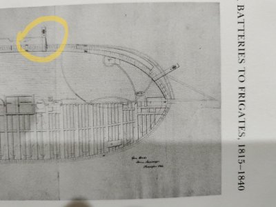

Brad! Well, the idea of double catheads is from Wolfram zu Mondfeld's Historic Ship Models - that's the image I posted. zu Mondfeld writes that it was a "thing" in the 19th Century. I had also seen it as I was thinking about double catheads for Harriet Lane. Plans for the USS Mississippi show her wearing double catheads.
In any event, the deed is done :cool: and I love the double catheads on L'Orenoque
