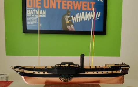

I decided to do a mockup of the fore and mainmasts based on the lengths given in the Magellan plans. 28 meters lower masts 20 meters topmasts. So, 280mm, less the distance from the bottom of the keel to the top of the deck (yellow line) and then 200mm less 40mm doubling (red line). Looks very tall - too tall?
Magellen gives 17M for the topmasts , not 20 so you are probably 3CM too tall.
So with that correction and some other adjustments I have the heights and proportions of the masts figured out. They will be just a little taller than the first versions and definitely not so spindly

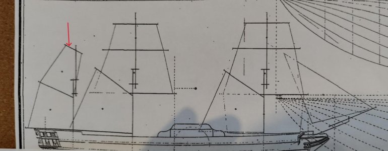

I would say hoops for the lower mast gaffs, but i would set the mizzen topsail flying.
wooldings or some sort of iron band are plainly visible on this picture
crows feet i have no idea, but 1835 , why not, if it gives you pleasure , not understood the attraction myself...View attachment 582366
Martin! Thanks for the picture and the thoughts on the mizzen topmast hoops. I don't know the name of this abridged lateen spar (red arrow) but I was pretty sure the sail would be set flying.
