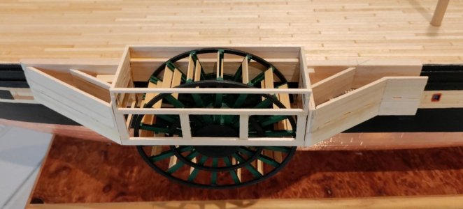

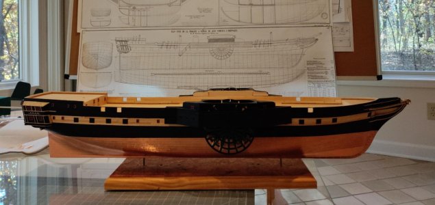

Here's how the sponsons came together: First, the kit plan (shown below) is complete fantasy. I won't repeat the long list of other inaccuracies of the kit sponsons I catalogued in earlier posts. Note the number of supports. Although, I now believe that there were supports for the sponsons, this is too much. None of the available plans for the class of ship (450 hp steam frigate) show the supports, but the models of smaller ships show a more elegant solution which I intend to replicate. That solution was iron rather than huge balks of timber. I wrote that "I now believe" that some support is necessary because before I hadn't thought of the weight of the bateaux tambours, almost 2.5 tons sitting outboard atop the sponsons. Martin @Martin By Eye, I know that we discussed the issue an were thinking perhaps the weight could have been born without lower supports because the sponsons were so stoutly attached to the fabric of the hull and the bulwarks.

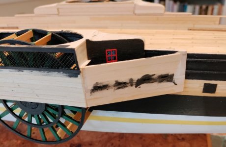

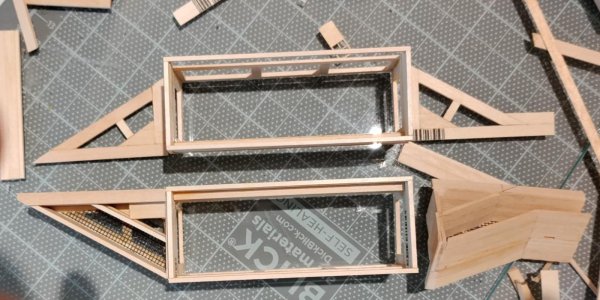

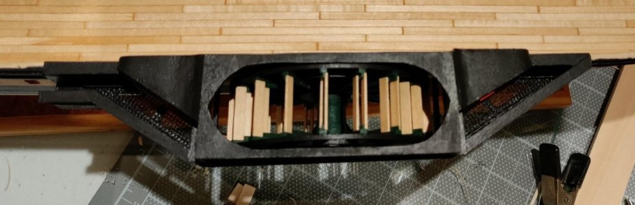

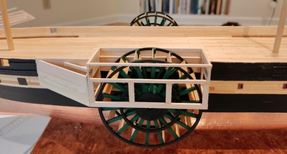

Below is a shot of the basic parts of my sponson solution. Upper left - red arrows - I built a frame to sit over the wheels with the inboard side resting on top of the bulwark and against the side of the ship (I added scrap to the inboard side of the wheels so that I had 1/16" clearance between the wheel and the interior of the housing inboard. Next - blue arrows - show the separate fore and aft water closet structures with the one aft having a gangway for coming aboard in accordance with the original plan. I built these structures and then glued the forward structure to the larger box. Once I was satisfied the glue was dry and things were still mainly level and square, I glued the aft structure to the whole. The result was a complete structure that can be removed without problem while I work on the rest of the ship. Next - magenta arrows - the water closed tops and the light green arrows pointing at the aft structure and pointing out the scuppers - there are scuppers on the forward water closet as well - had to see in this picture.

Good morning Chuck. Quality stuff. Going to look fabulous. I missed your Birthday so Happy Belated Birthday Chuck. I hope you had a good one. Cheers Grant

A nice puzzle to get all the parts together, Chuck.

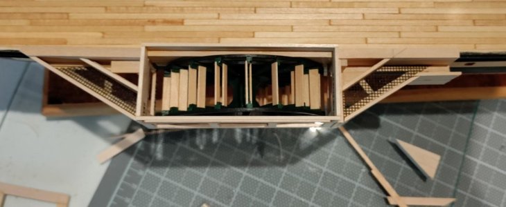

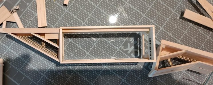

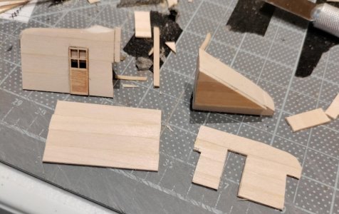

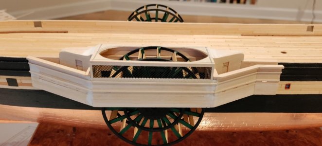

Here are some pics of how the pieces came together. Note: one of the more helpful tools I've discovered is a nice thick piece of glass. I glued the sub-parts of all of the sponson components together on glass! I hope the pics are self explanatory. Happy to give more informatio if requested.
Ok. The pictures are not in perfect order. I'll leave it to you to puzzel it outROTF I know that the screen mesh I amusing for gratings is way out of scale. It looks a bit better painted.
LO sponson aboard partial.jpgLO sponson aboard partial 2.jpgLO sponson aboard oh 3.jpgLO sponson assembly oh 2.jpg

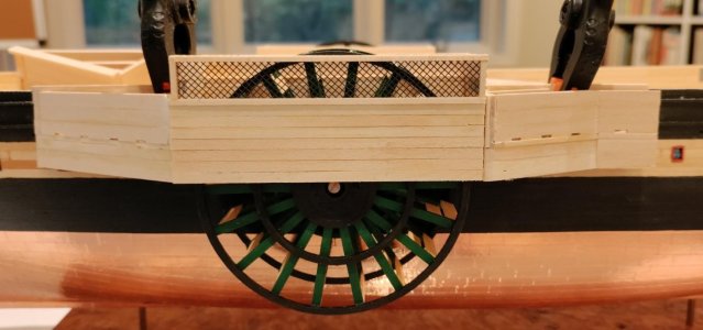

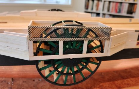

Here are a couple of pics focusing on the lattice on the upper part of the wheel covering box. Again, the screen mesh is not to scale. Once painted it is much better, but still not to scale. I like that the wheels are more visible through the non-scale lattice. Not just a rationalization;). You'll see.

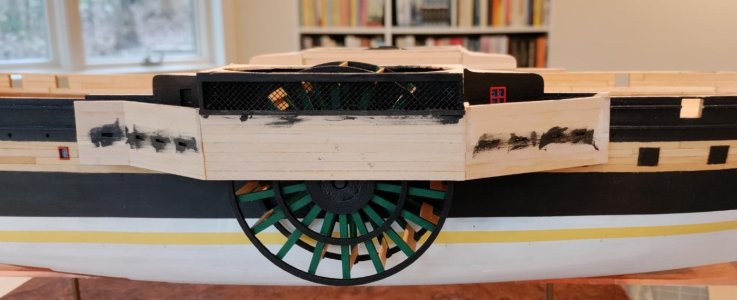

After I got the major components finished and fitted, I had to put doors on the fore and aft parts so that sailors could go out onto the sponsons and personnel could get onto the main deck from the aft gangway.

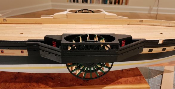

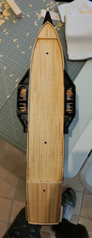

Once I had a skin with the cut out for the door, I glued the skin to the top part of what I am calling the w/c and then glued that part to the sponson assembly. Then, time to paint.
LO sponson fin w paint 1.jpgLO sponson fin w paint 2.jpgLO sponson fin w paint 3.jpgLO sponson fin w paint 4.jpglo sponson fin w paint 5.jpg

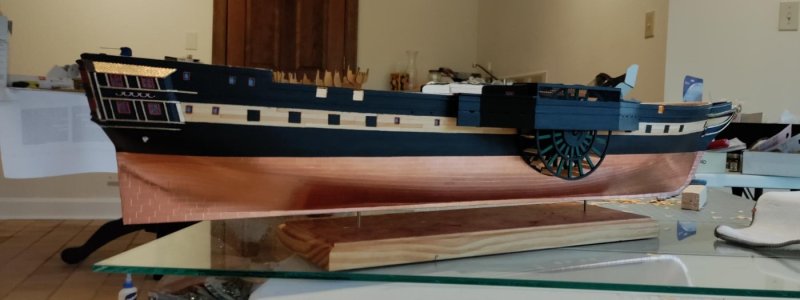

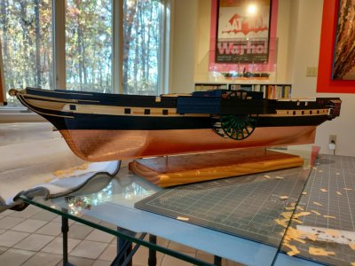

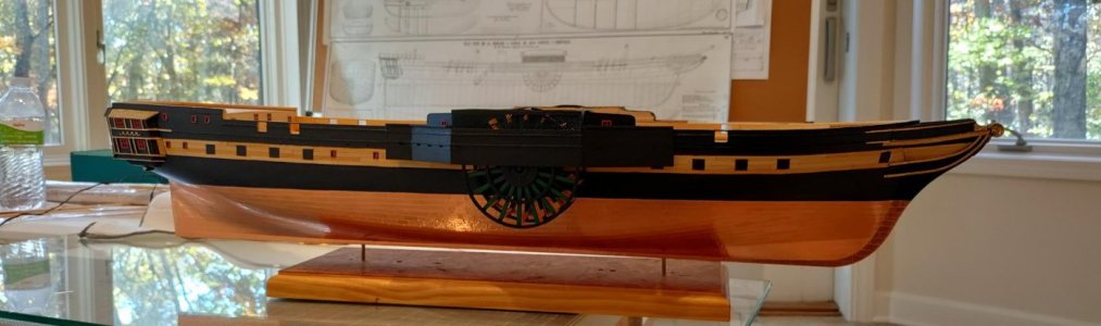

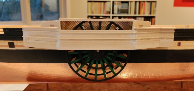

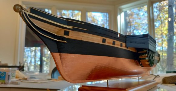

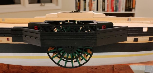

And, shipmates, as we come to the close of this session: I finished coppering the hull and added her name to her stern and painted the open gun ports red.
A few posts back Paul @dockattner asked whether I would repeat the green on the wheels elsewhere. Paul, I'd like to do that. I am thinking the gun carriages and the doors on the inboard parts of the sponsons and maybe the ladders and the bridge. I also thought to paint the funnel that lovely green. We'll see - I'd be glad to have my shipmates' thoughts. I think painting the funnel other than black may be too far out of touch with historical accuracy. Whether that impacts my decisions is anyone's guessROTF
LO nov 5 1.jpglo nov 5 2.jpgLO nov 5 3.jpgLO nov 5 4.jpglo nov 5 5.jpglo nov 5 6.jpg

Brilliant, as usual! You are right: that mesh works very well. WRT the funnel, perhaps a compromise: paint the funnel black, but with a couple of green rings.
