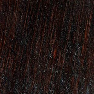

I think I don’t want to be historically 100% accurate but play with the illusion a bit. Leaving the hull untreated other that oiling will contrast to harshly with black wales in my view, so I’m leaning to a deep dark brown or or even smoke house.
Painting a true waterline on a clinker at this scale (specially in white) would be a challenge . I will Tung oil mine on both open and closed sides with black whales.
A little stain to add color would be interesting but your sample seems a bit dark to me . Add the black whales and all appears gloomy also you will have a high contrast with the lighter topsides. Now that's just my 2 cents.

The colour sample is for the Wales as I don’t want to use black but a darker shade of brown . As you, I will use tung oil for both sides of the hull planking
