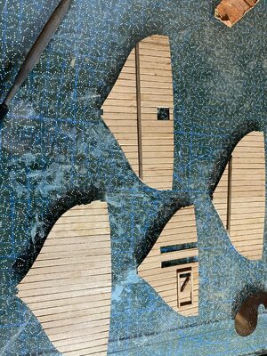

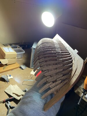

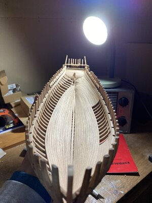

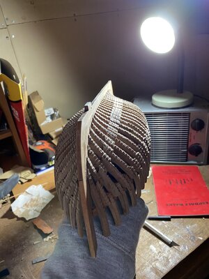

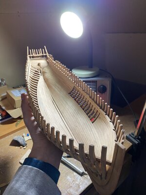

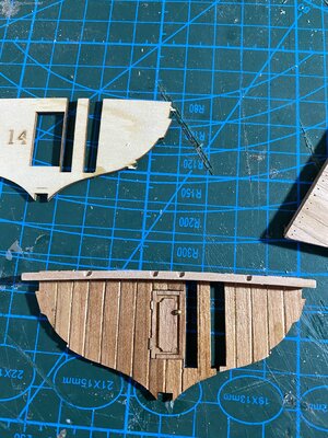

Finally found some time to finish the inner hull planking and make a start with the bulkheads and other parts of the inner structure. I have to say it’s a pleasure using wood glue only again and doing the detailed work. The 4 main bulkheads are done and just need final fine tuning, sanding and oiling but I won’t do that until the final fit after the outside hull planking ( interesting debates going on on the group build).

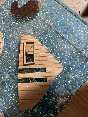

Really enjoyed doing the little window in bulkhead 1 that like others found out works perfectly. Looking forward to constructing the final bulkheads, floors, doors and other items and playing with the idea of some added detail such as lighting, additional storage items and what to use for ballast...

I presume as @ot1138 and @Uwek reported, the planking will not only require bending but will also have some challenging torques and twists that are hard to achieve with just heat, soaking and wood glue. Will focus for now on the inner hull fittings. Your coureur is coming along nicely too and I believe you are just using wood glue for the inner planking, so it can be done.
