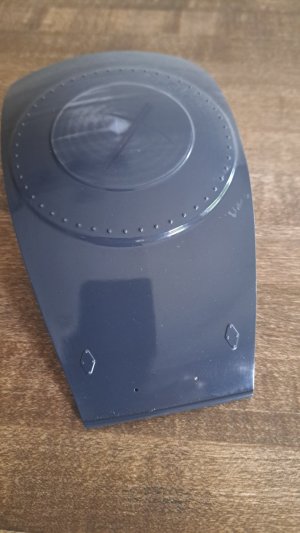

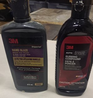

Francois - looks like you will need to do some sort of finish prep as the photo seems to show a bit of dust. Wet sanding may remove too much paint around raised areas like the 'bolts' and edges. As an alternate to wet sanding try some 1500 liquid polish compound. I've always used Presta but it has gotten way beyond expensive. 3m or Meguire's and others have similar products
Dave, I'm a much better designer/modeler than a painter. I new this part of the project was going to be very challenging for me, I'll do my best but I don't expect a perfect finish. I did a test this morning using 3M polishing compound followed by a 3M hand glace on my test piece. It got rid of some dust but not all. One theory is that I didn't give it enough curing time.... but probably that I'm just a bad painted is more likely.
A thin coat of floor polish will make it shine. Is often used in plastic kit models as a final layer.
Top of my head: Pledge Clear.
But test on a part and let dry until hardened.
Francois - that looks pretty darn good and exactly the kinds of finish products I would have used.
As to being a not so great painter - I reread the original post and it appears that you used rattle cans to do your painting. These will get paint on but sometimes they just cannot always do a great job. Consider what they have for a mass produced spray nozzle (that often gets partially clogged) then the propellant which is at an inconsistent pressure. I have used IWATA LPH-80 for small areas as well as their full size guns. They are low pressure and for my amateur needs, perfect - but you do need at least a compressor. As far as dust - that happens without a spray booth of some sort - sighhhh
A good carnuba based auto wax will work best for final shine but wait a couple more days to let the dry surface trapped solvents (water or?) escape.
That lid really looks nice now though
I'm on a fairly steep learning curve with the paint and clear process.
I cleared all parts except the fenders, the rear trunk lid and the body. The result is ok, no more. I need to better control the dust (I got a tack cloth for this) and to better degrease the parts. After testing on a spare part, I decided to sand the cleared parts with a 3000 grit tamiya sponge pad first and then with a 5000 grit polishing pad (dry and wet). I will then re-apply a wet coat of clear. Once this coat has cured 48 hrs, I will see if another 5000 wet polish is needed or if I can just wax it as is. It's a very slow process.

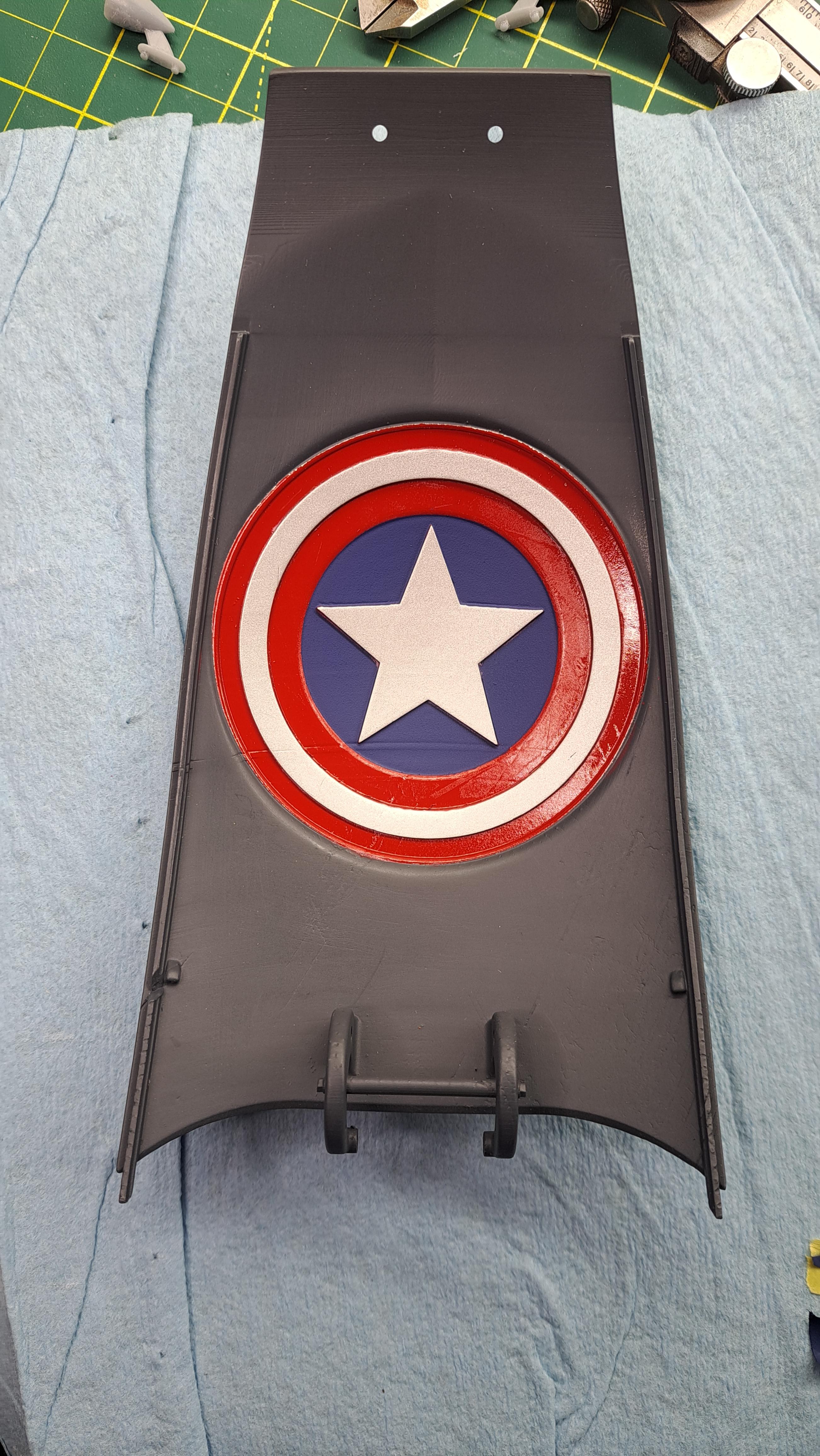

I finished the of day by painting the shield on the inside of the trunk lid. Still need to do a few touch-up and to apply the clear but I'm happy with the result.

This is the latest test, and hopefully the last, before I resume clear coating the parts. Here's what I did. Starting with my test piece that had a coat of finish paint and 3 coats of clear, the clear was wet sanded and received another coat of clear. This last coat was sanded it with the 3000 pad and wet sanded with the 5000 pad. I then buffed the left side using my 3M buffing compound, my 3M hand glace and finished with a polymere wax. These 3 last steps were done using a cotton wheel on my dremel at the lowest speed. The right side is as it was after sanding.
The result is quite nice and the waxed surface is slippery as should be.

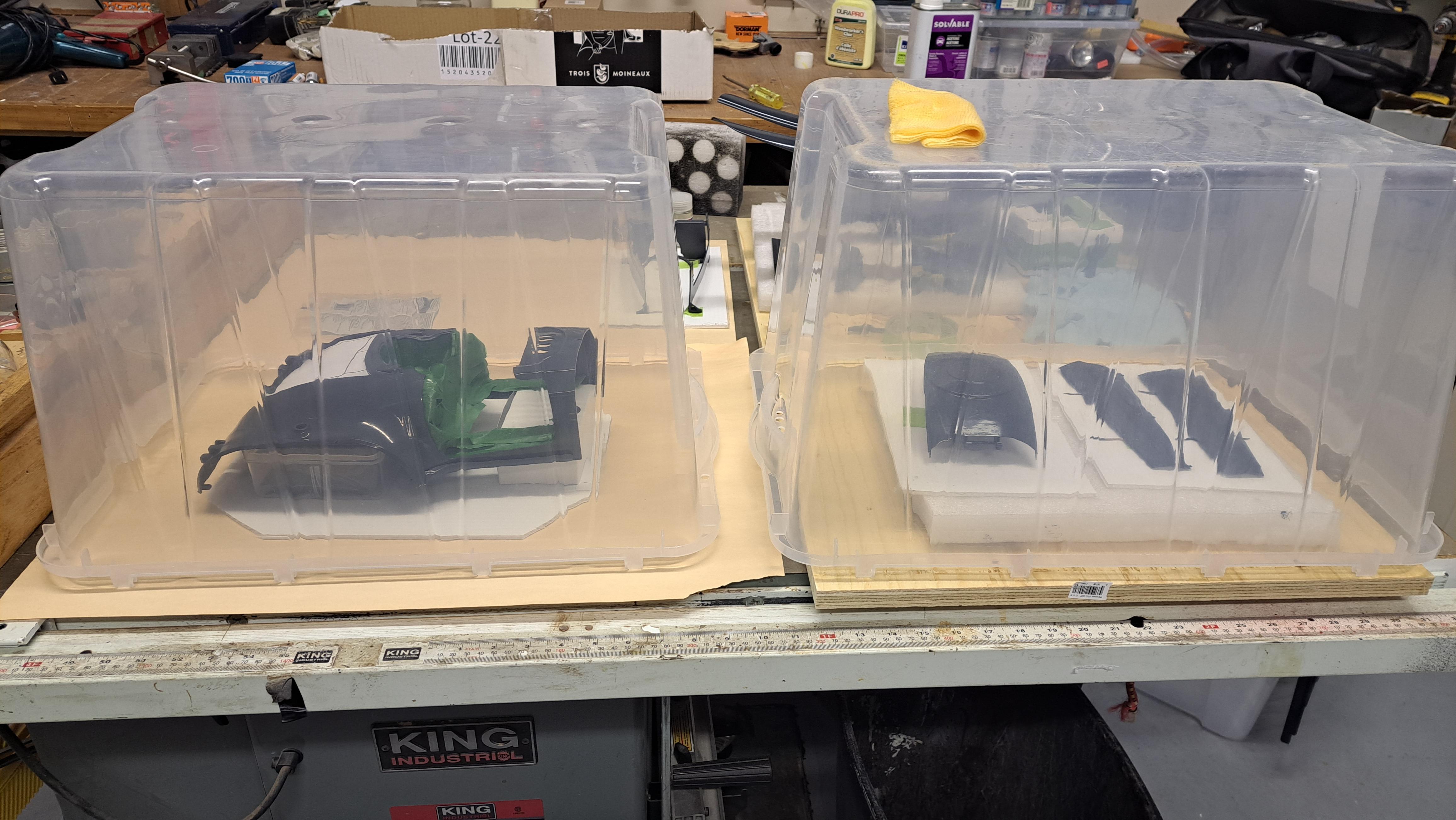

Curing under dome. It was suggested that I cover the still wet parts with a box to protect from dust, quite ingenous

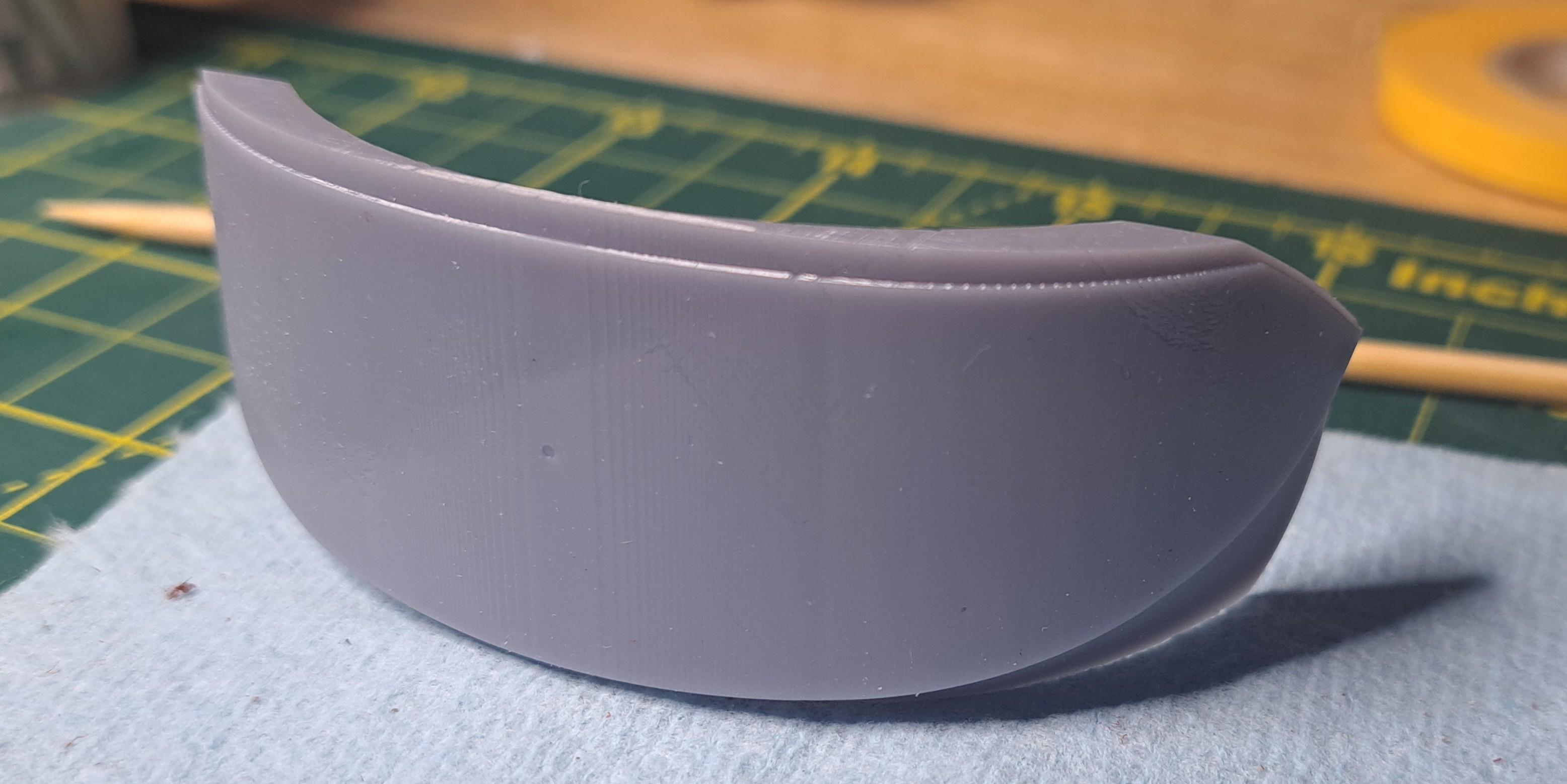

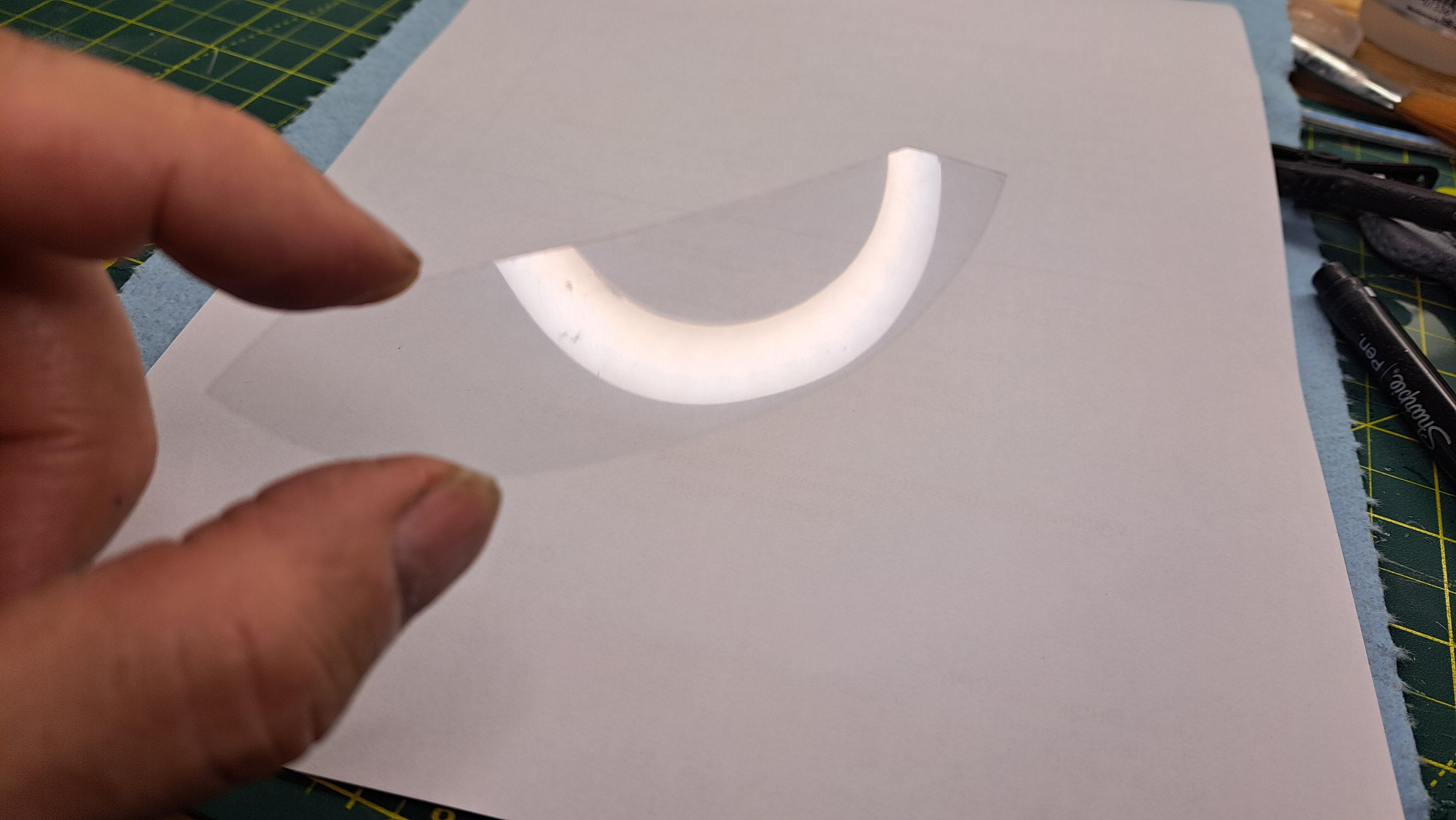

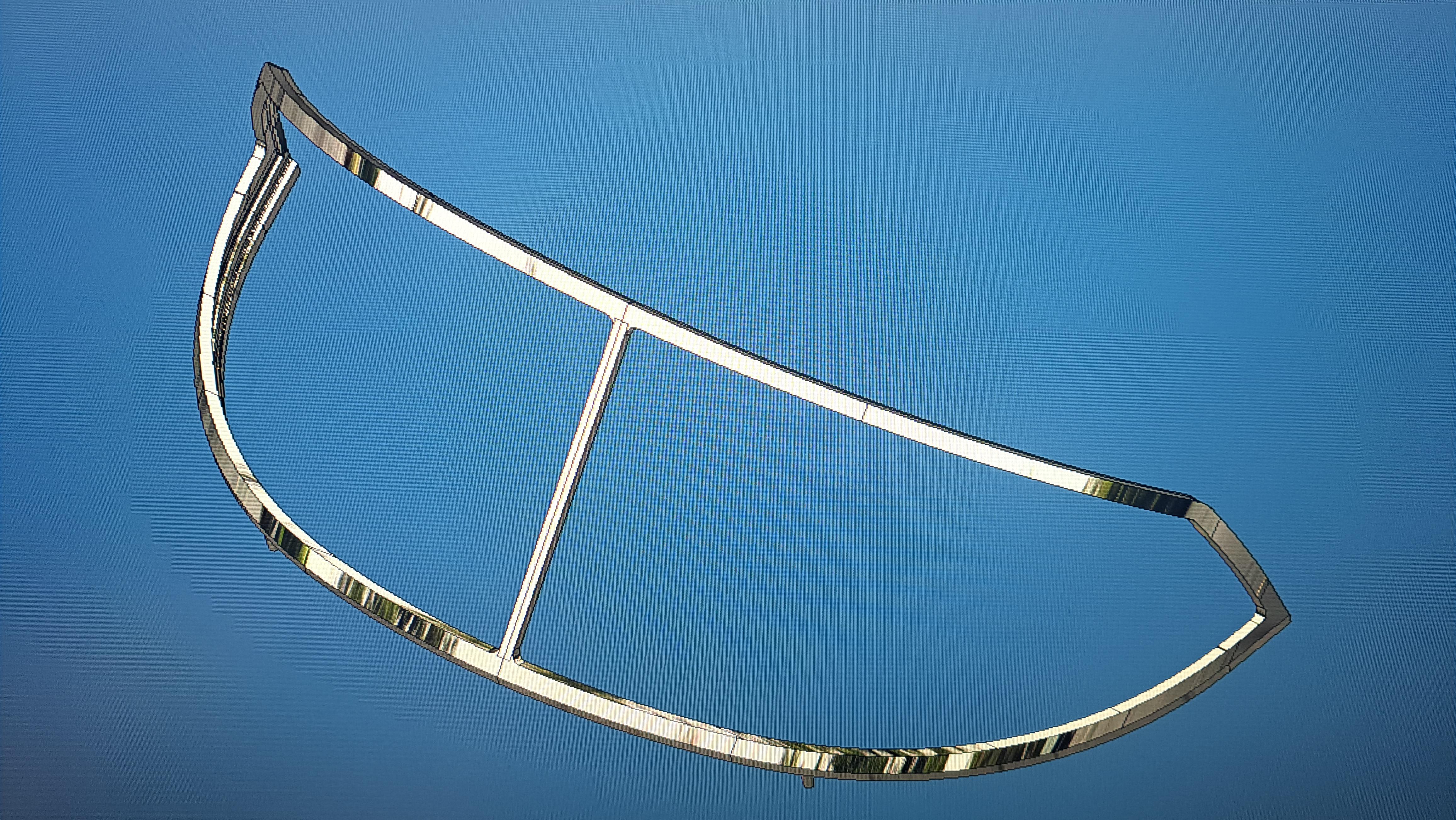

I did the windshield today. It's quite an odd shape to cut so I printed a template. To design the template, I used the 'derived component' command on my 3d modeling program. I apologize in advance to all you non-3d modeling savy readers out there, this will get a bit technical. Hopefully someone will know what I'm talking about, if not, well it will have been another good english writing exercice.
What this command does is that it can sudstract one or more form (the cutter) from another(the raw material). The resulting 'derived' part is the difference of this substraction. In this particular case, I needed the curved shape of the windshield so I could use it to cut a clear plastic sheet to the correct shape. Now, I already have the windscreen frame modeled. So by substracting this frame (the cutter) from a larger form ( the raw material that the cutter cuts), I ended up with a derived part that has the exact shape of the windshield. There's one other maneuver that had do be done but I won't explain it because, well quite frankly, I don't know how to.
Here are a few pictures to better explain
The windshield frame
The 'derived' part which is the difference between the frame and the raw form hence called the template
The printed template
Clear plastic sheet on template
Windshield cut to size

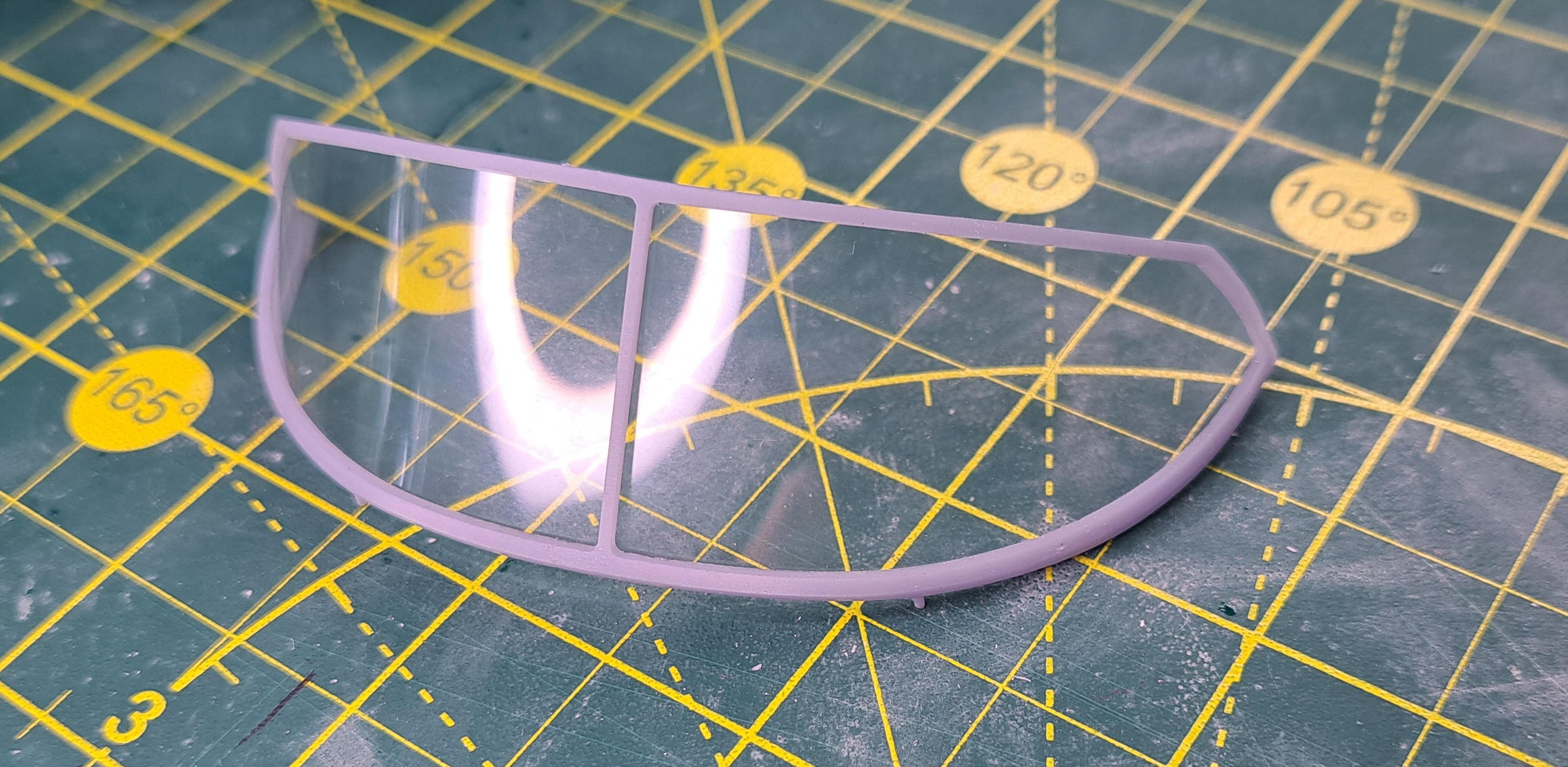

Windshield in windshield frame
