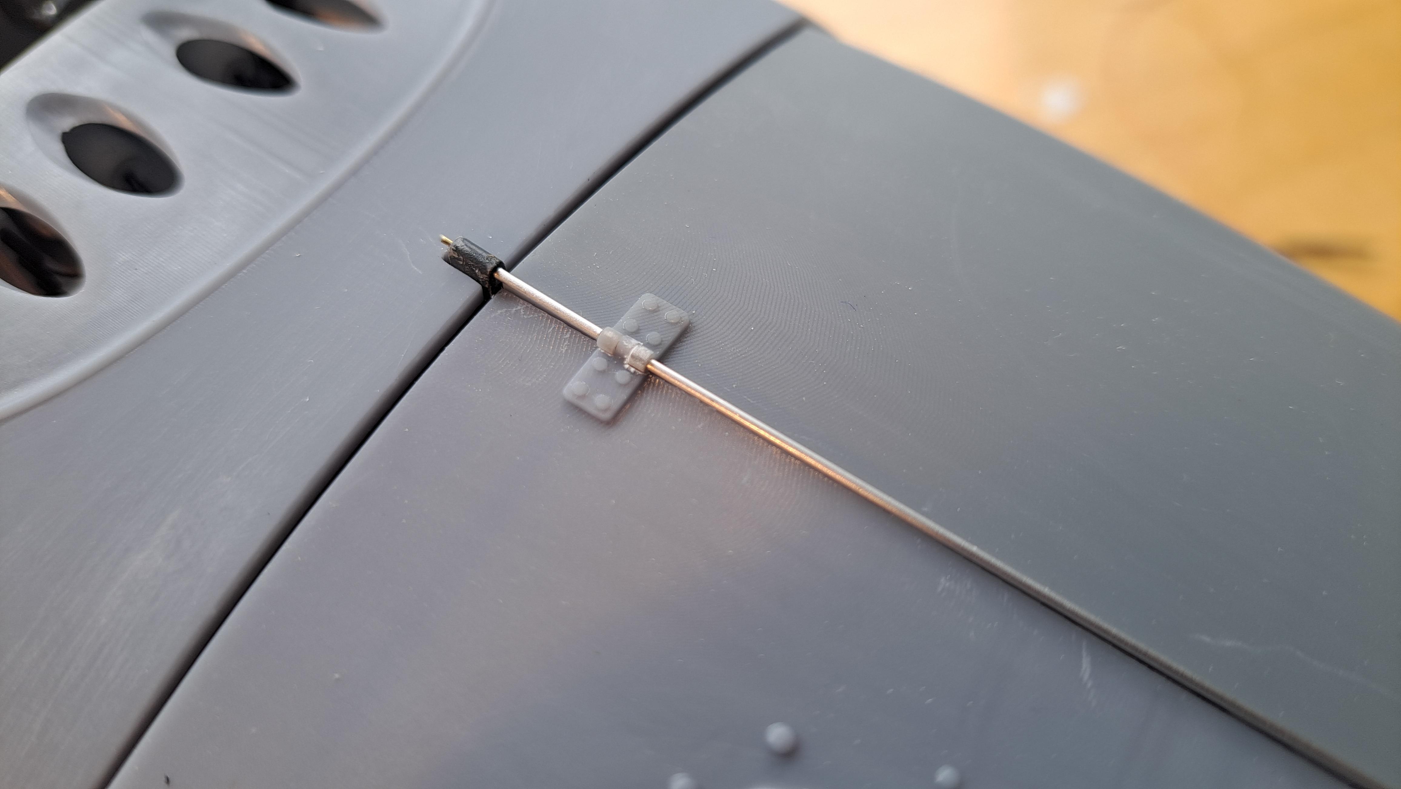

Francois, if you won't be offended by a suggestion, it occurs to me that a length of tubing between and on either side of the bonnet hinges through which the hinge pin could run would fill the gap between bonnet halves and give the whole thing a cleaner look. If the tube were fixed to only one bonnet half (although in theory it might not need to be fixed at all), it would still allow you to open and close the bonnet.
Namabiiru, not offended at all, it's a great idea. I have to say that it's been the plan from the start, I'm waiting for final assy since these tubing have a very small diameter and are very fragile.

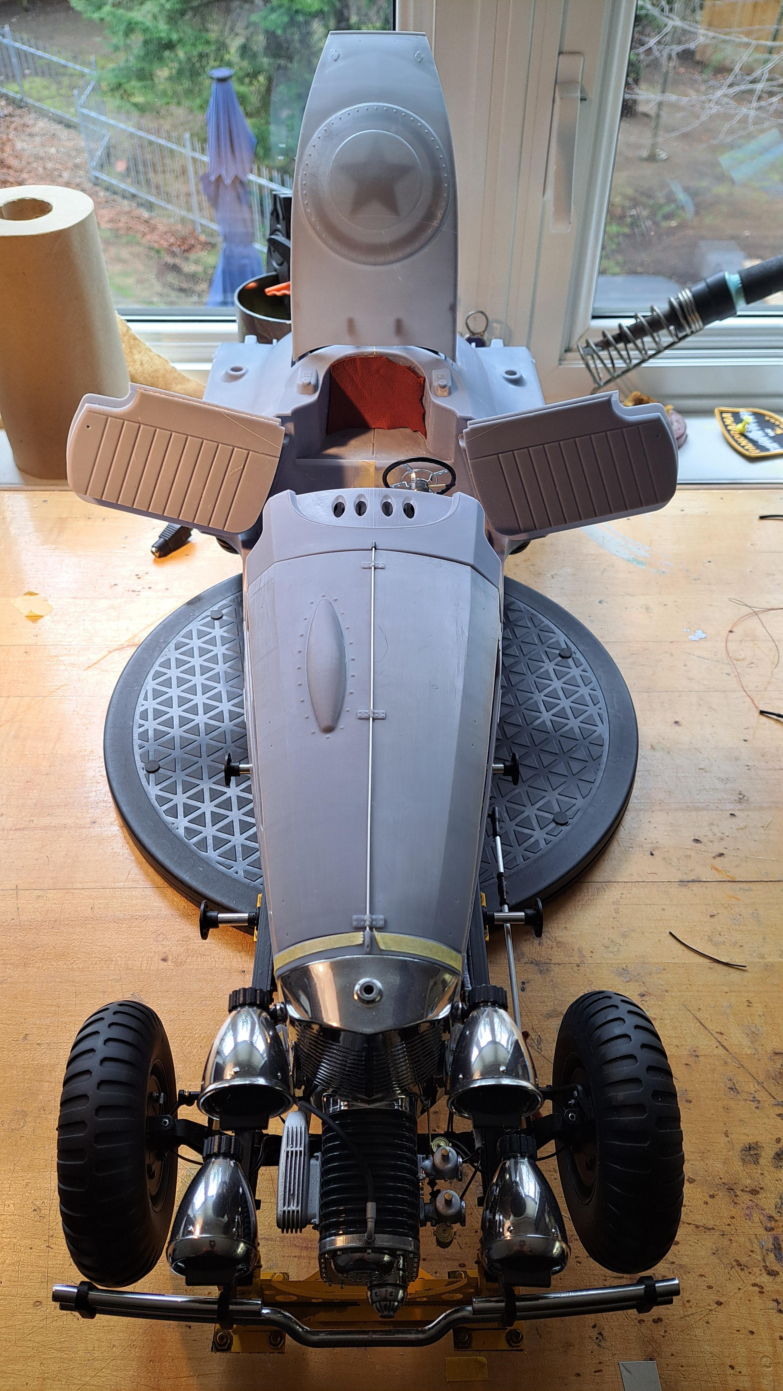

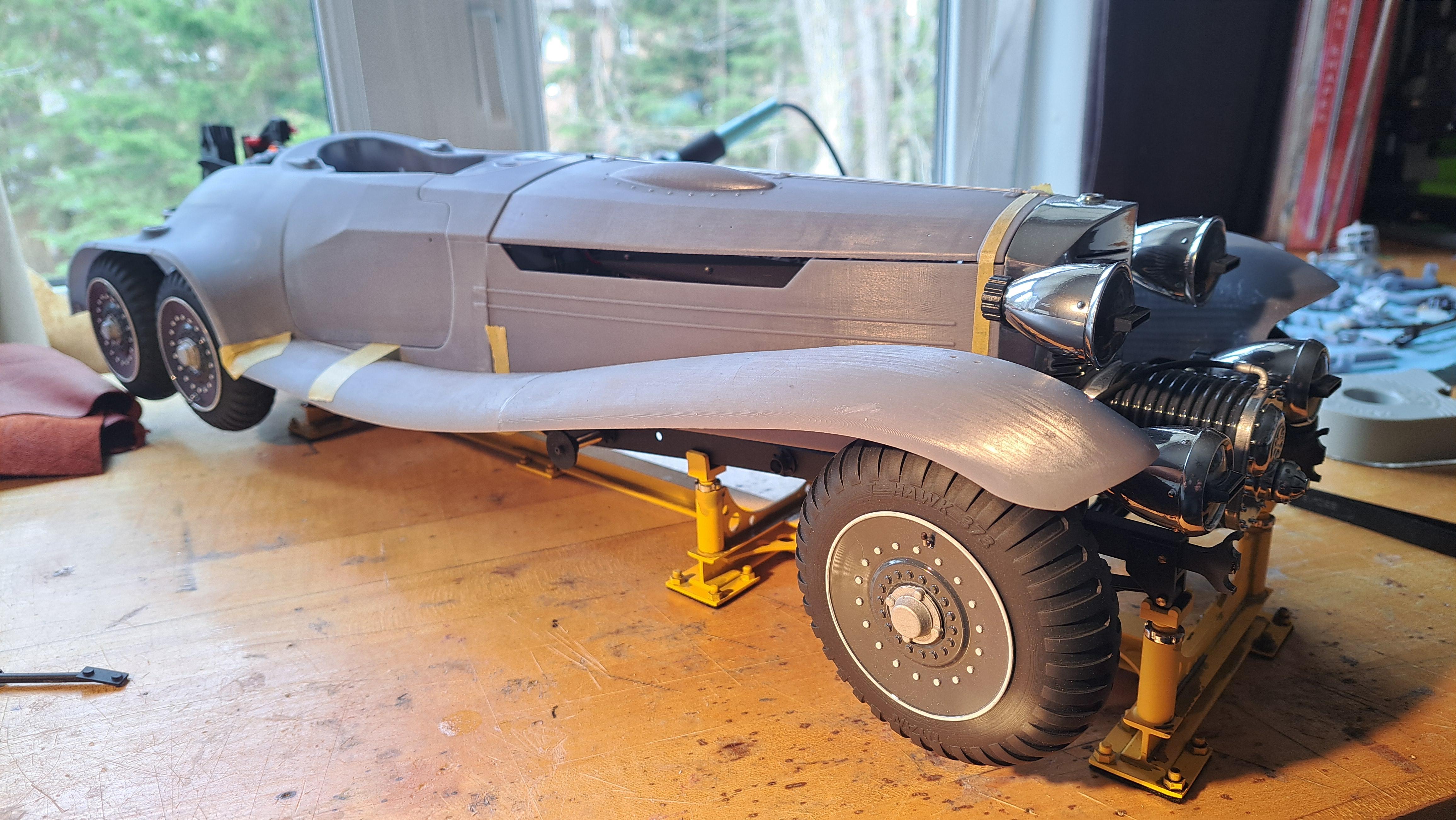

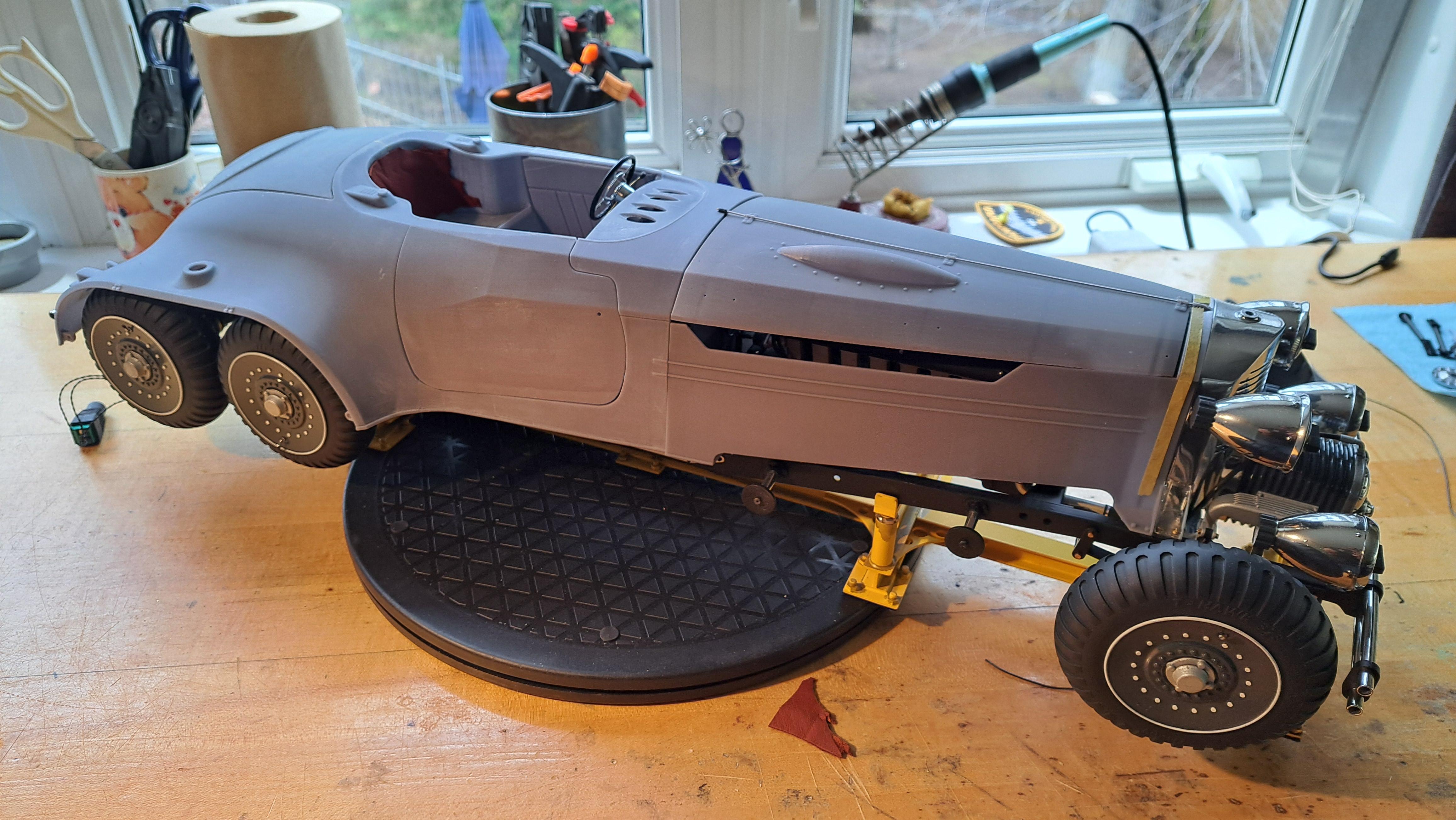

The body is slowly coming together, and the fit is surprisingly good. The doors open and close easily as does the trunk lid. I still have a lot of fitting and sanding/puttying to do. I'll ve applying a sandable primer before paint. Here are some shots as of today. I also took a few shots of the undercarriage.

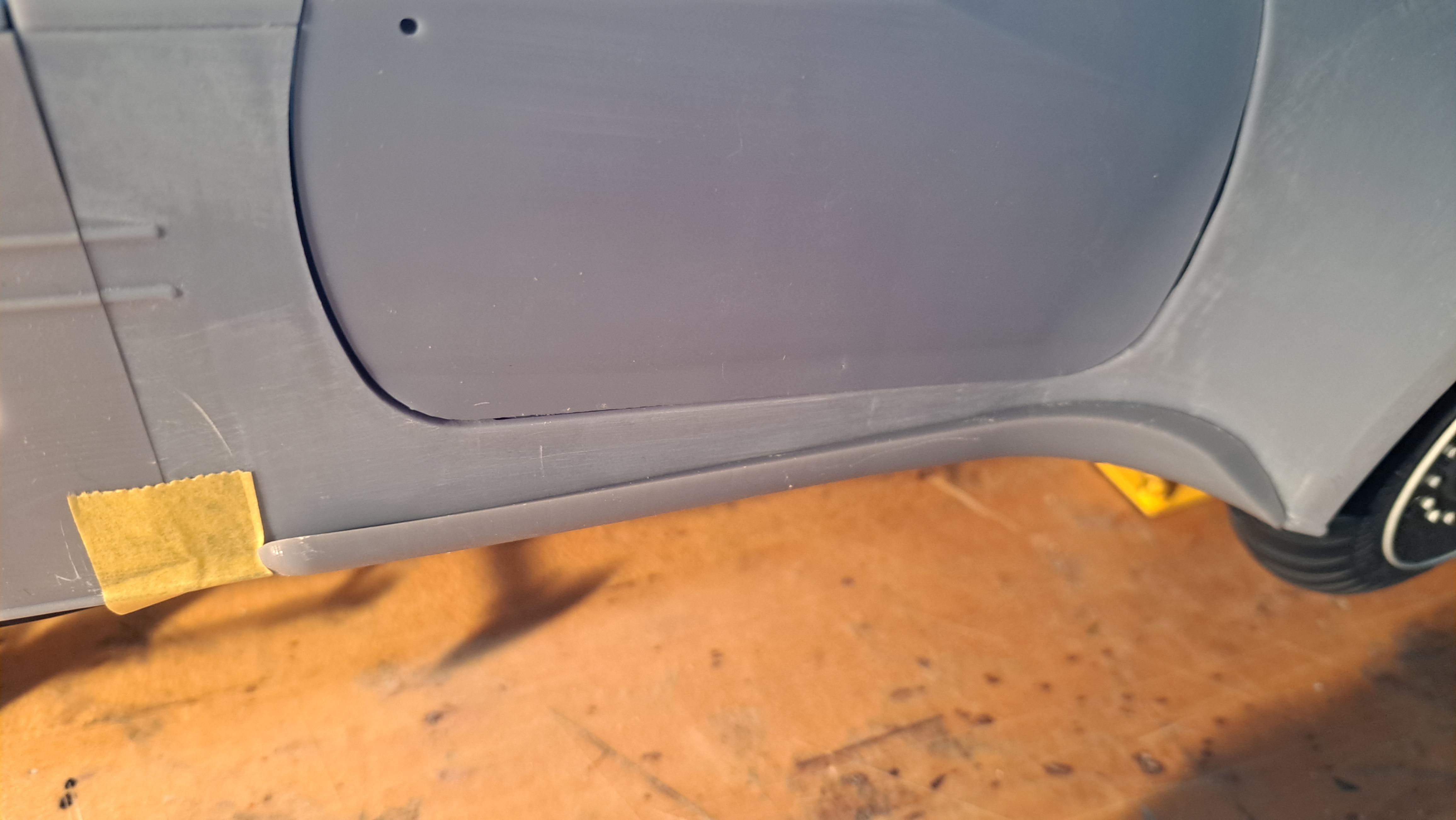

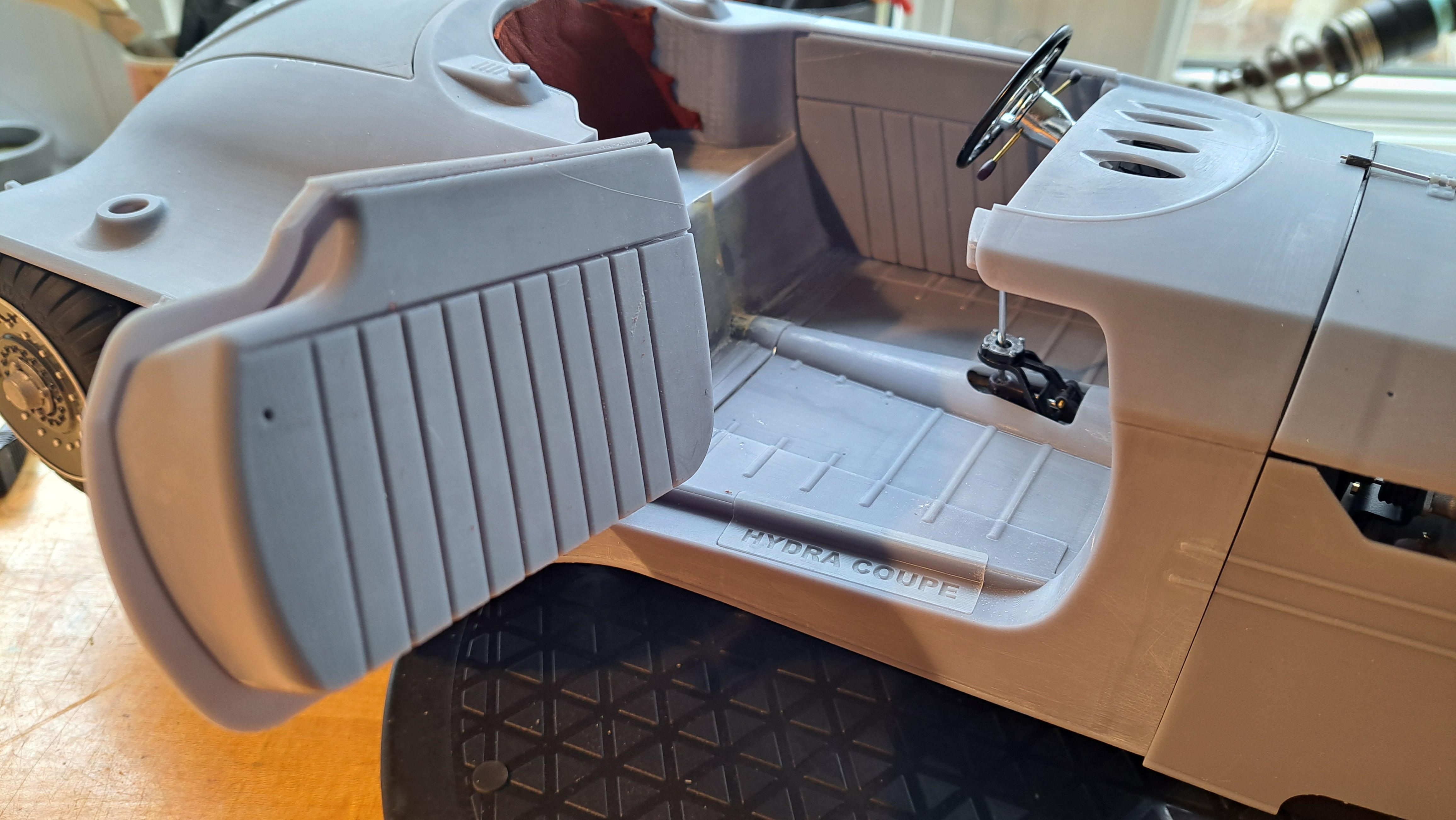

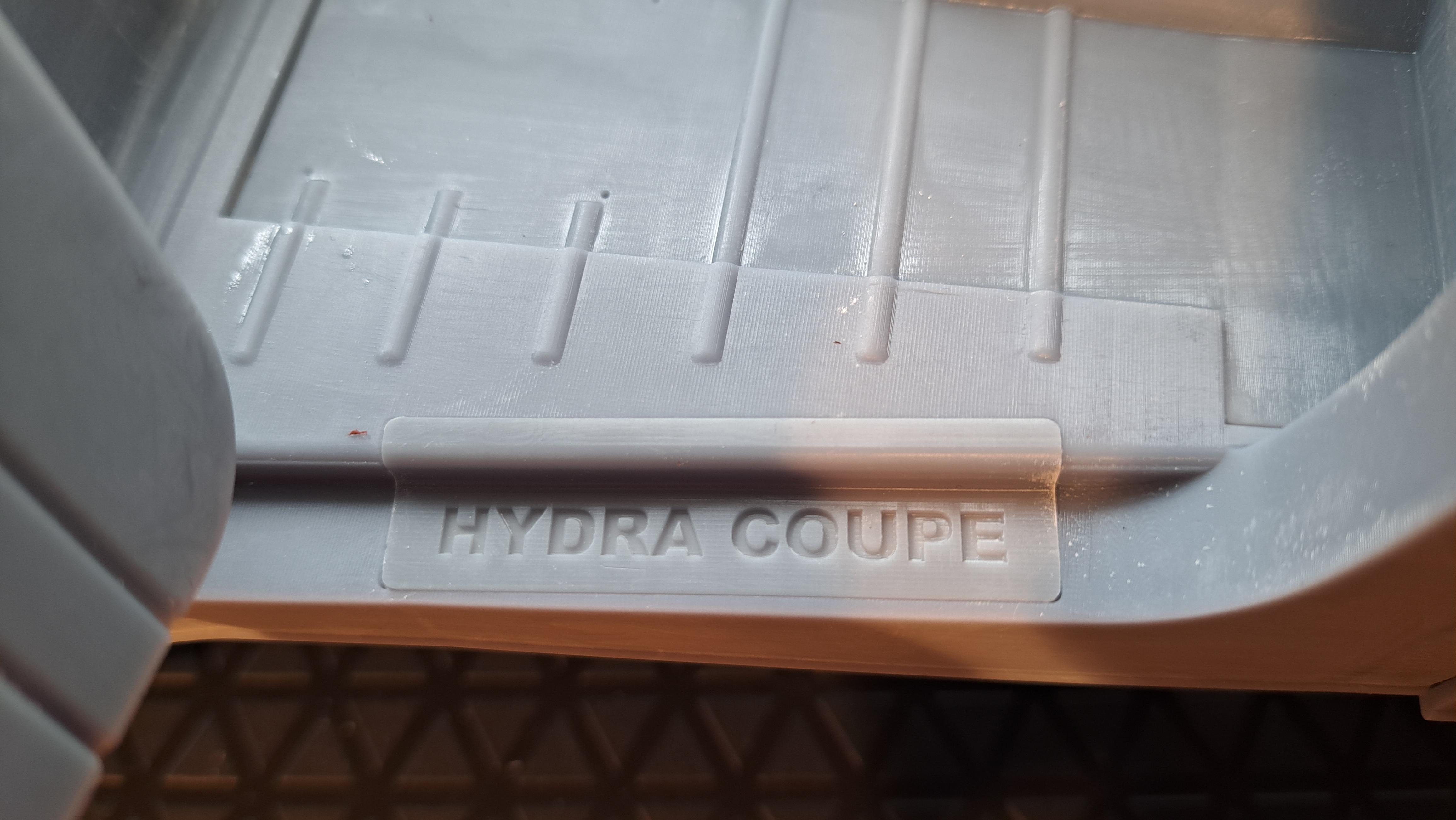

Door sill, will be chromed with black lettres

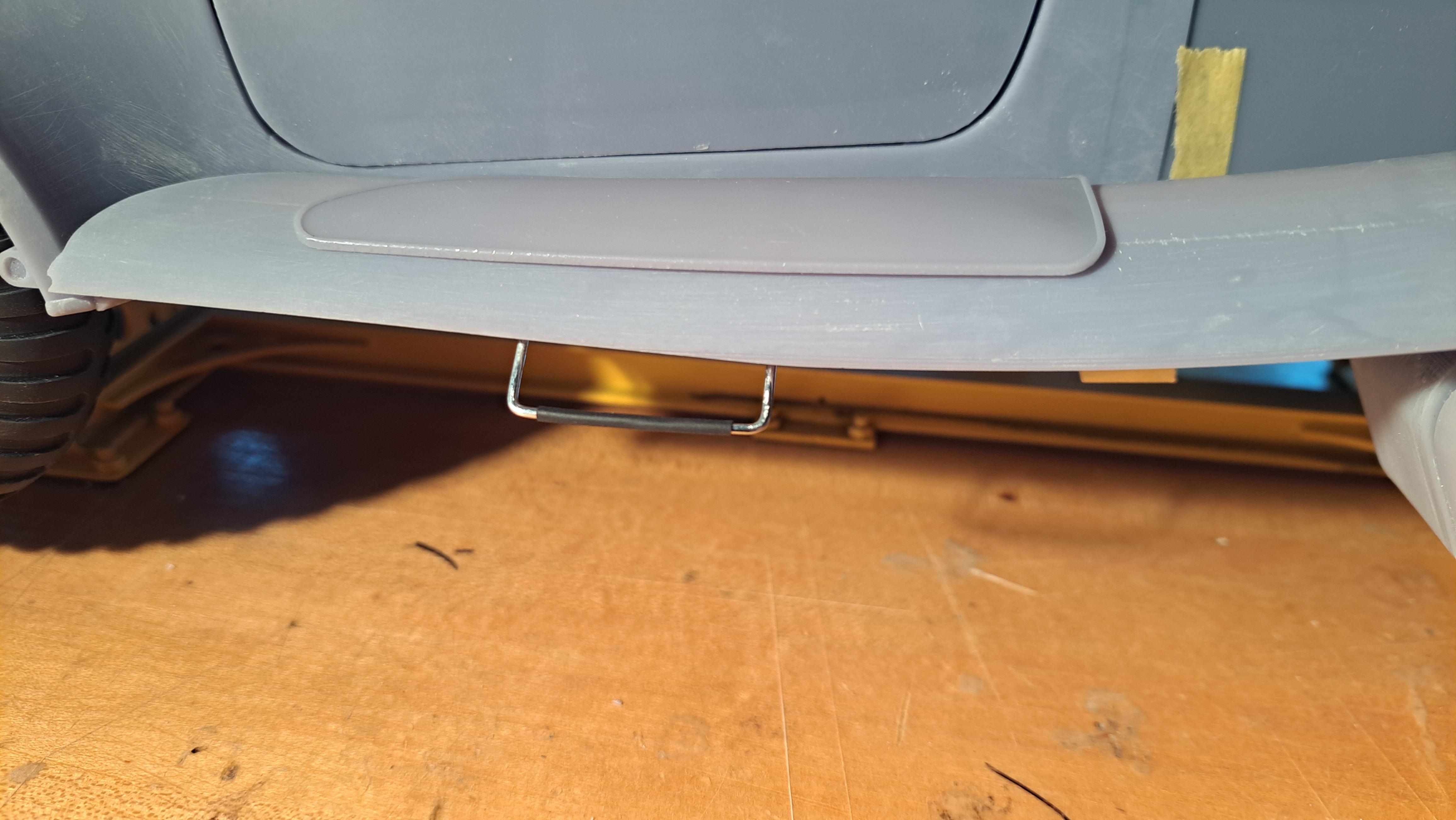

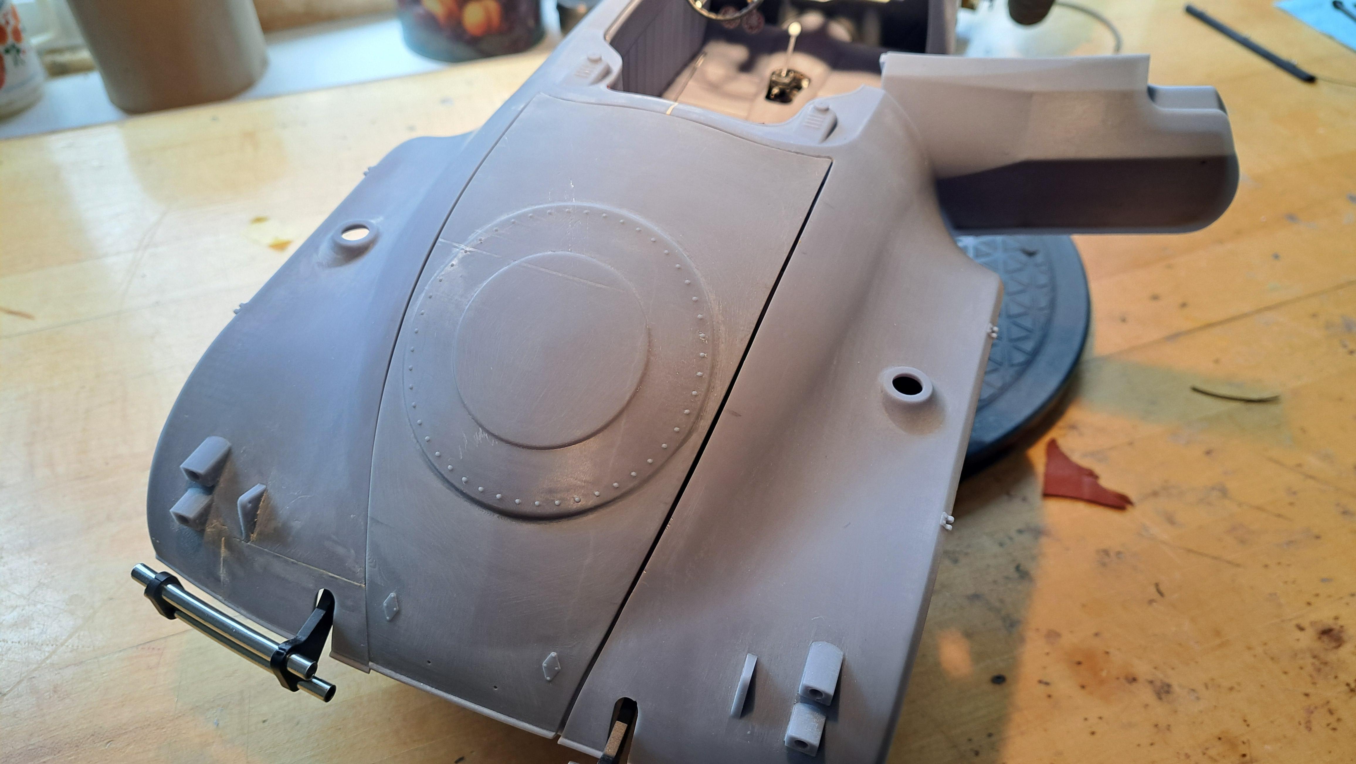

Trunk lid prop bar added
aluminium micro tubing over brass pivot rod

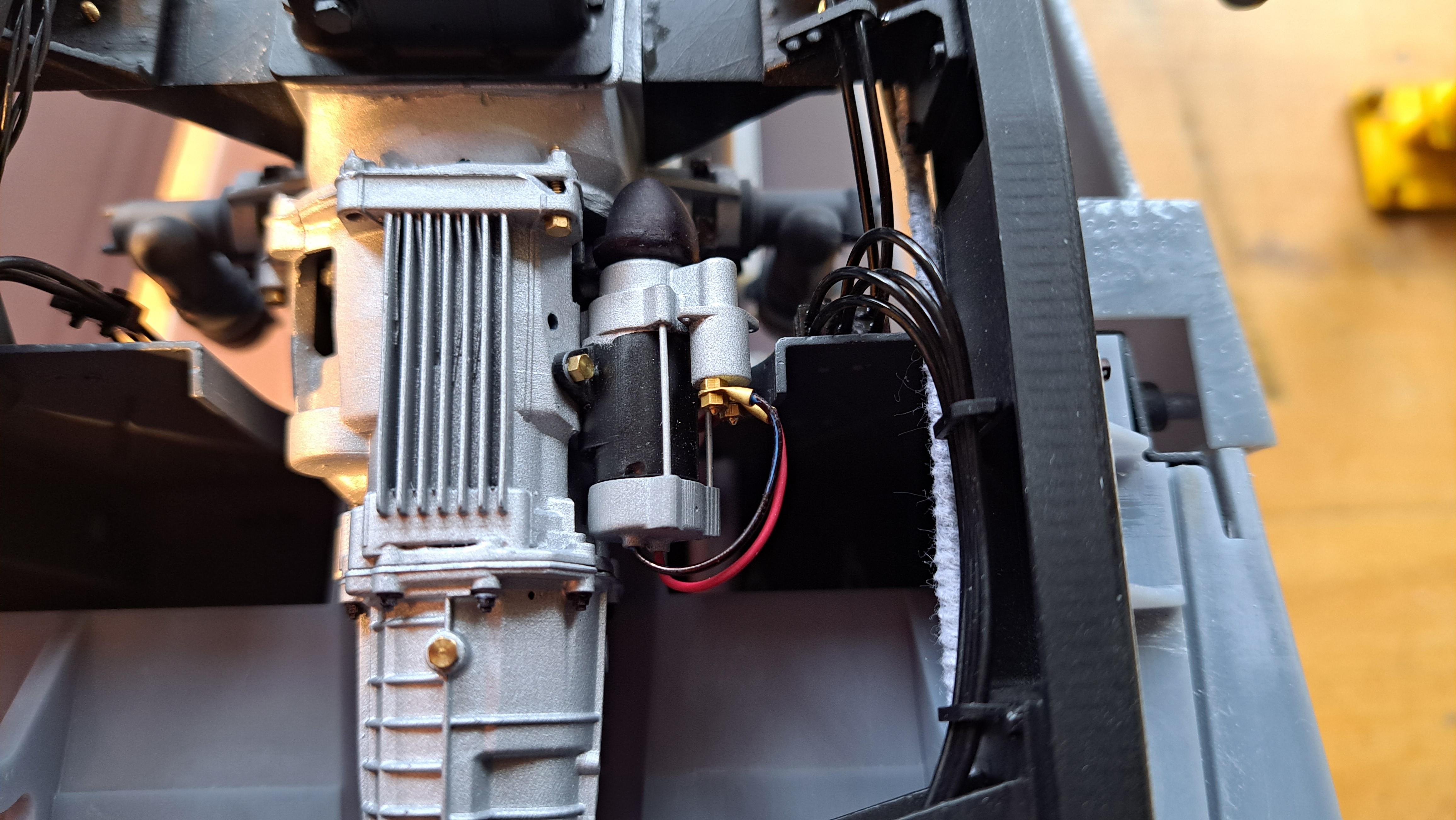

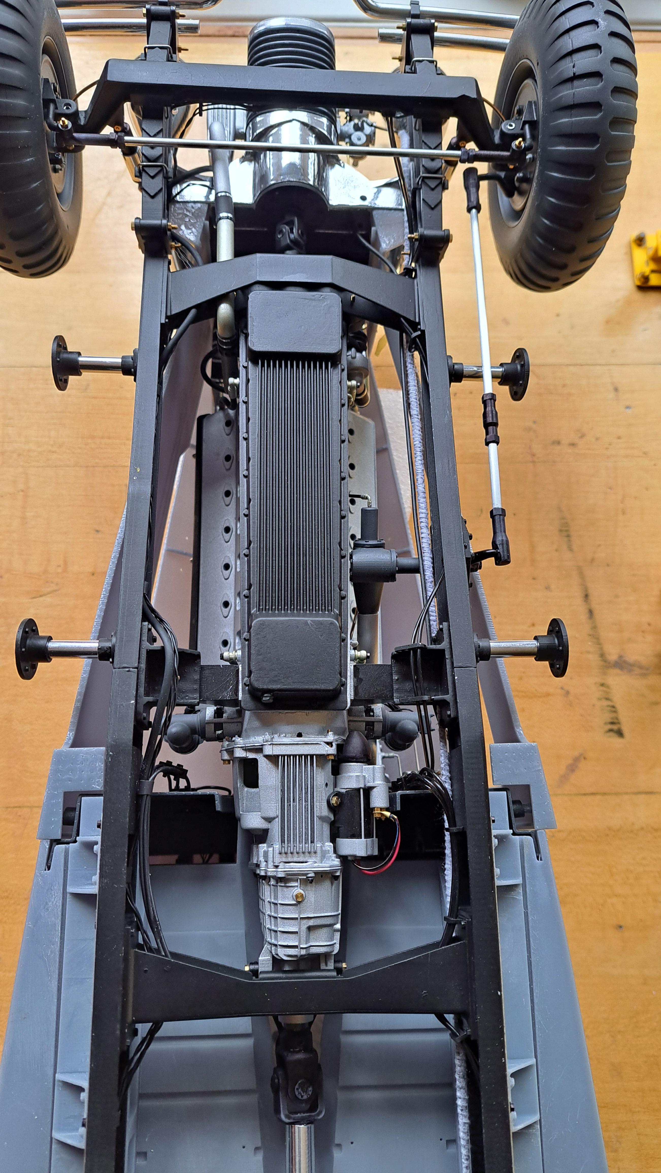

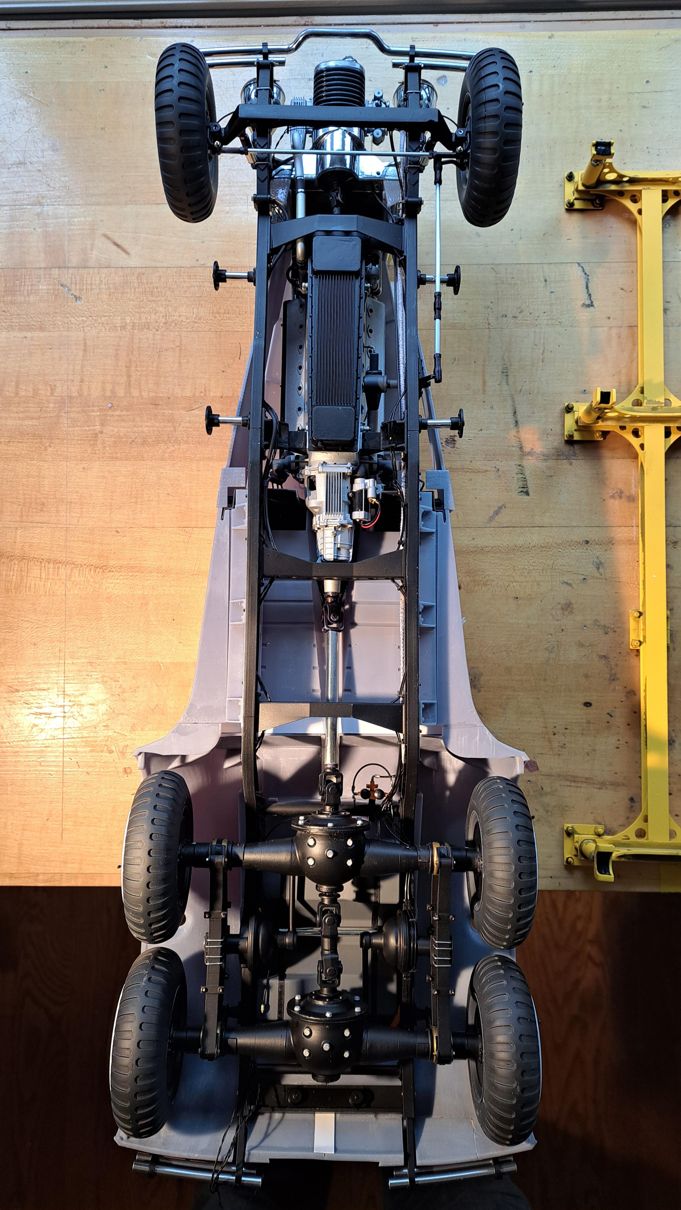

Undercarriage
Close up of the wired starter

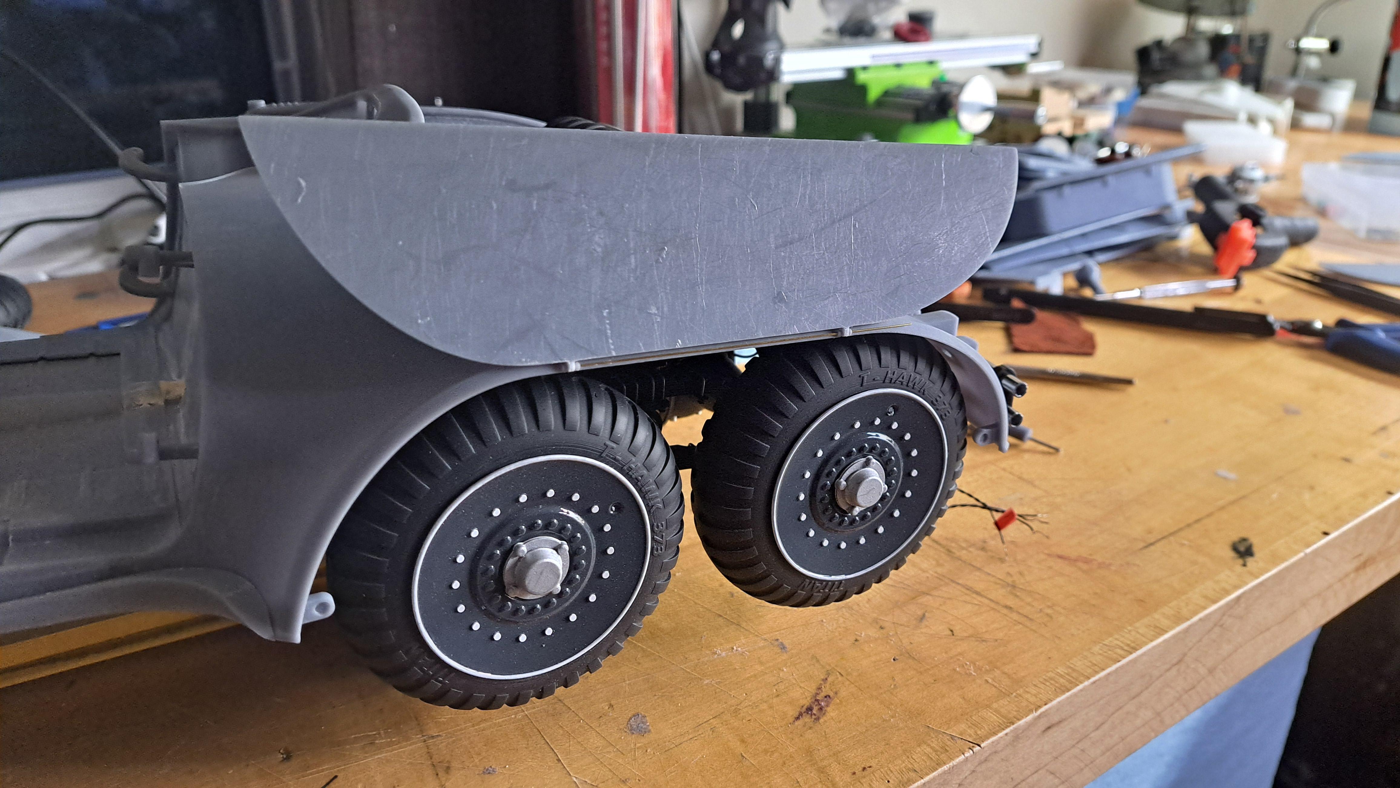

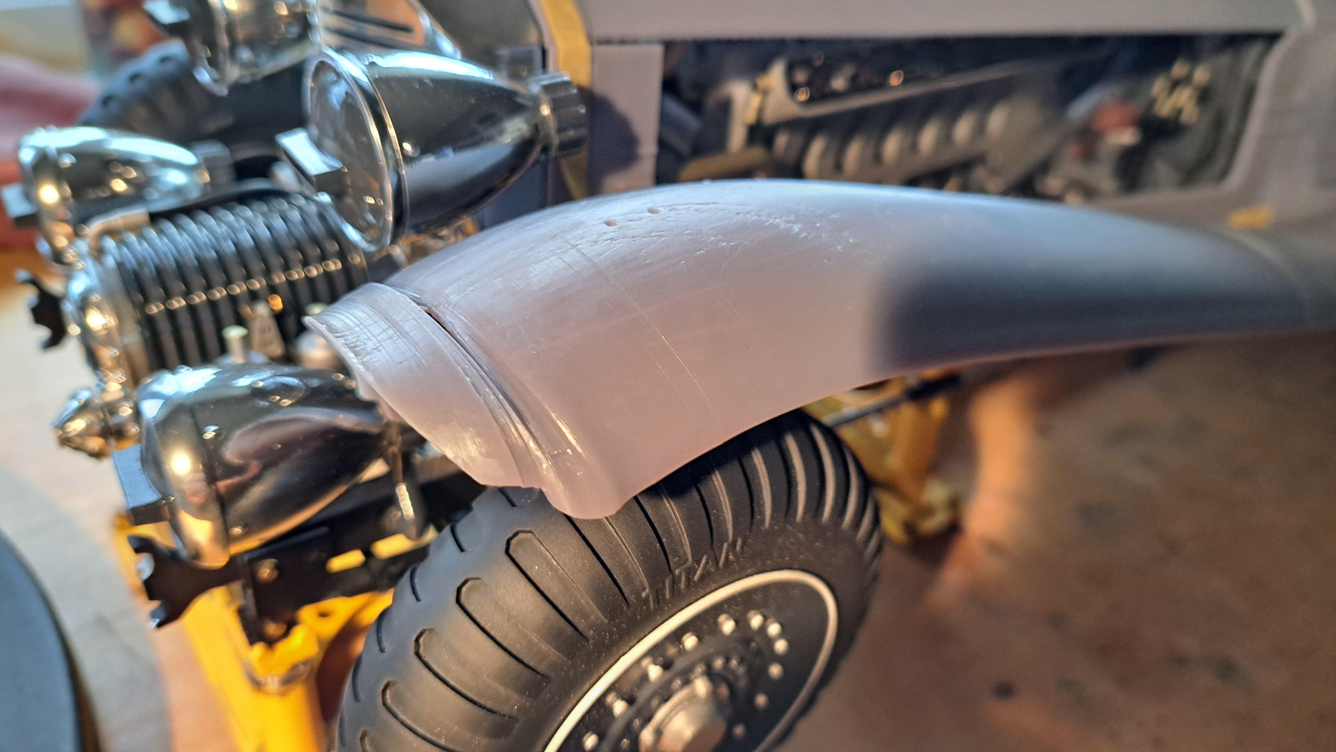

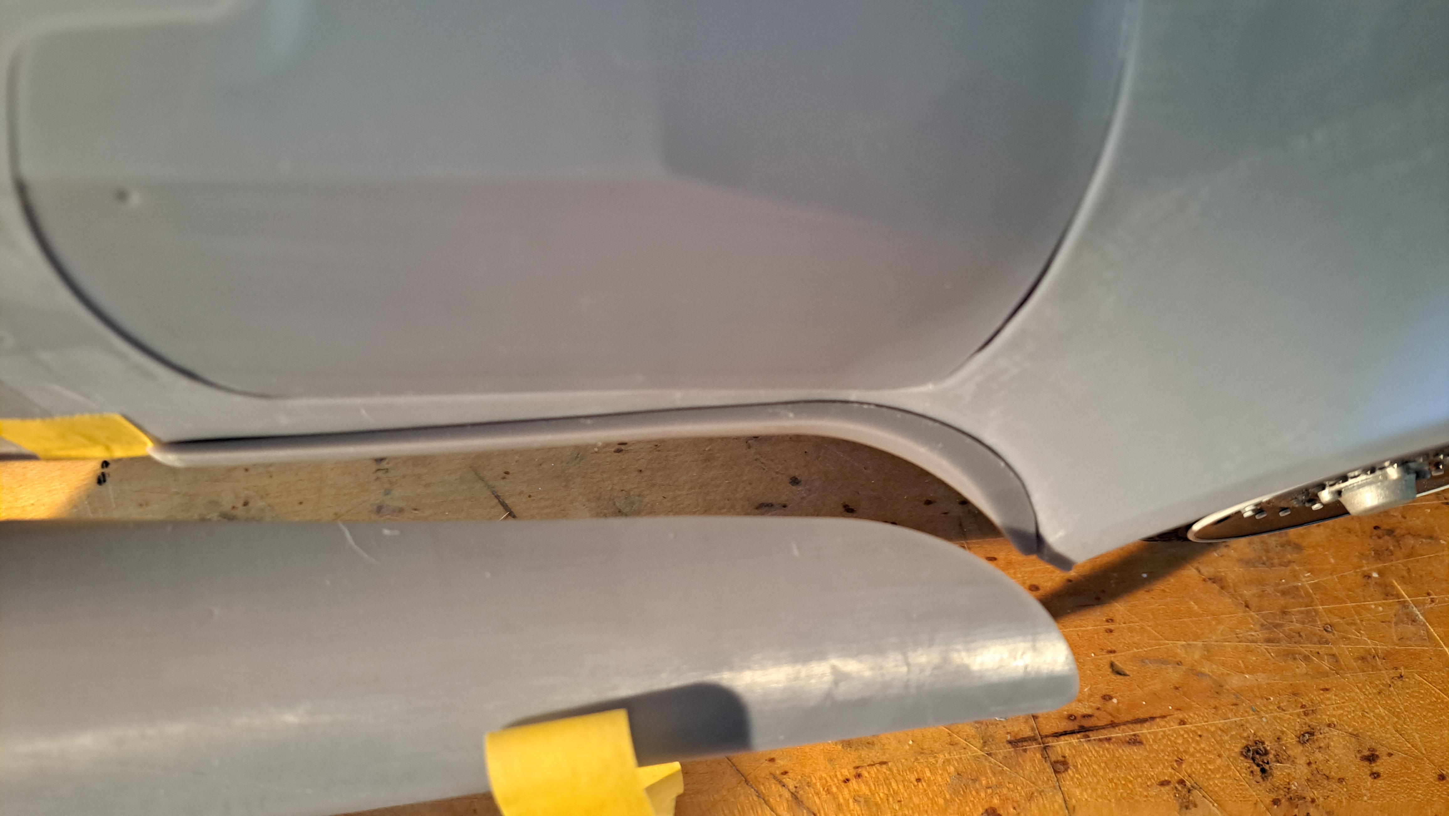

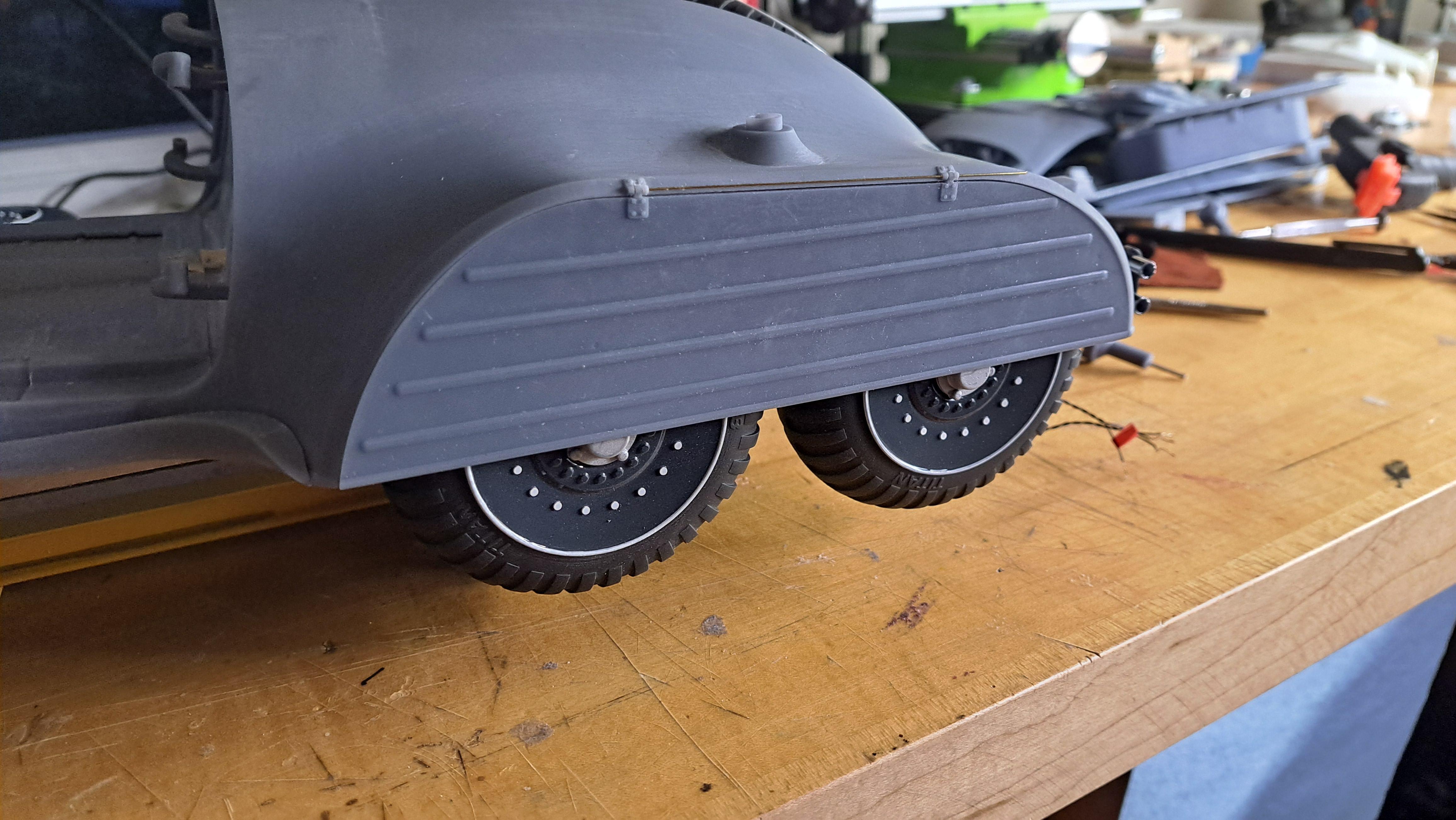

The fenders on this project were among the hardest to 3d model and they prove to be just as difficult to print. They are also very big so they need to be printed in 2 parts. My first try didn't come out so good. I printed the left side fender and althought it has good dimensions and fits as it should, the front amd middle were badly printed. I'm hoping the second try will do better. It wasn't easy to properly locate it again the body so I made a hook up rail that fits perfectly against the body and is glued there. The inside edge of the feeder can then be hooked on the rail in order to be in the correct spot.
Hook up rail glued to body
Fender edge near rail
Front of fender badly printed
But it's promissing

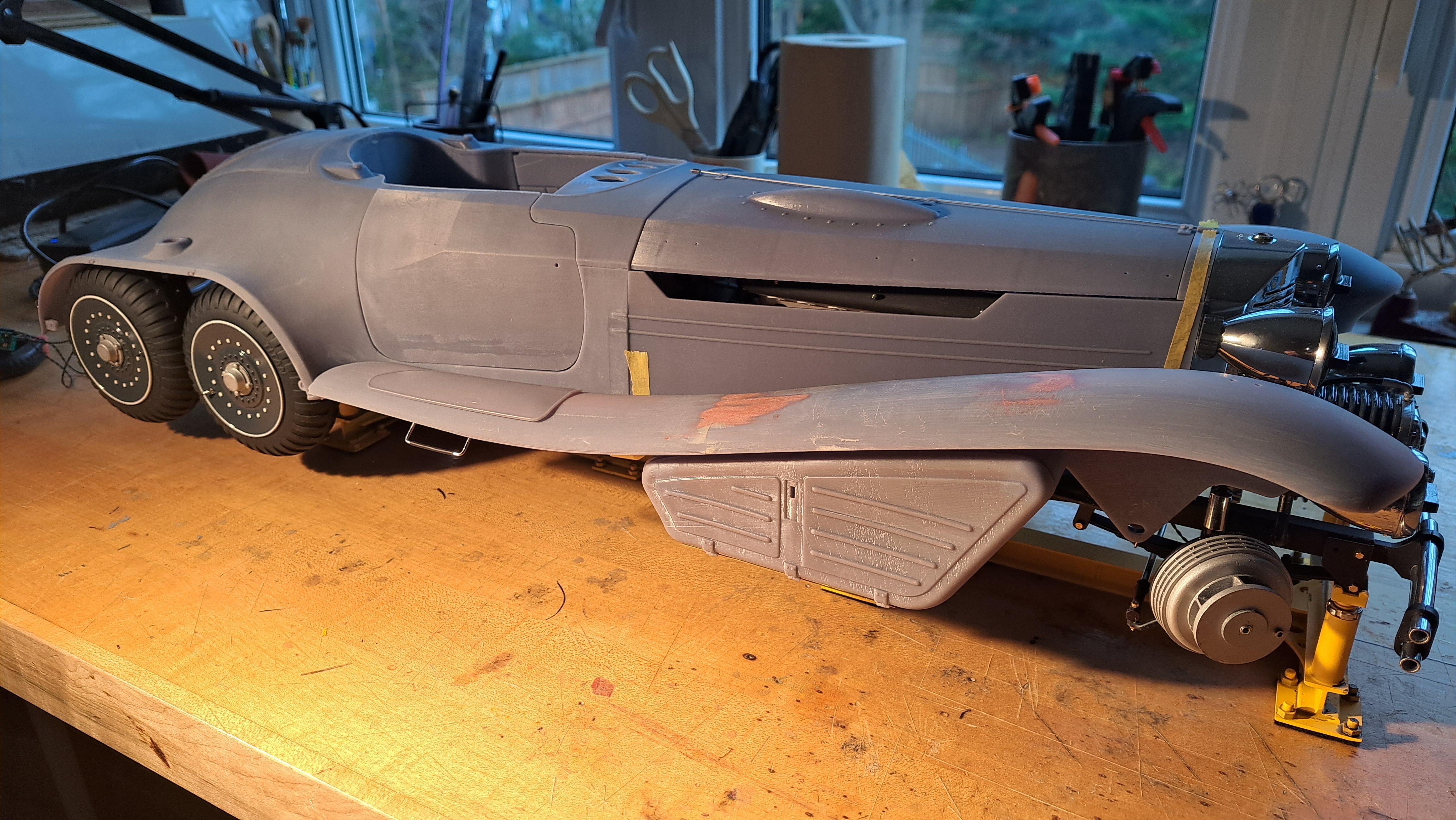

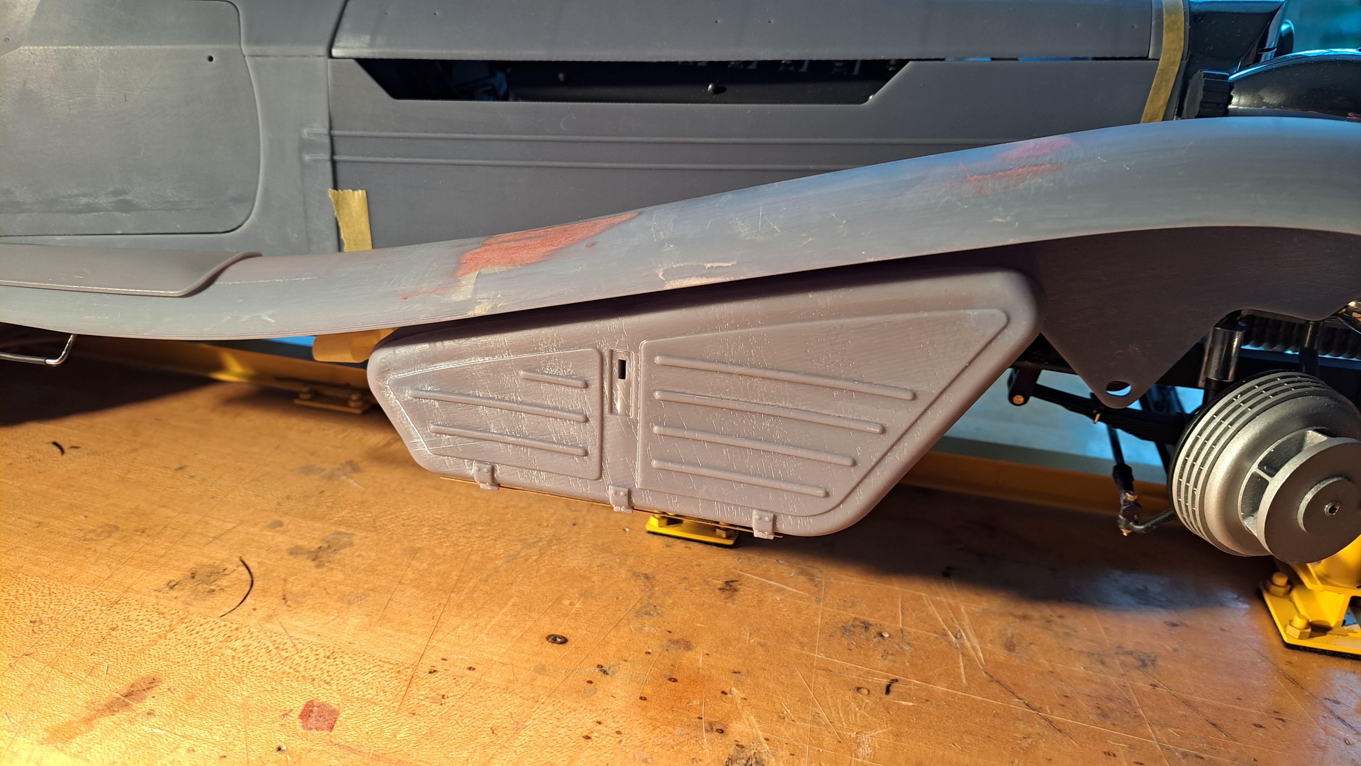

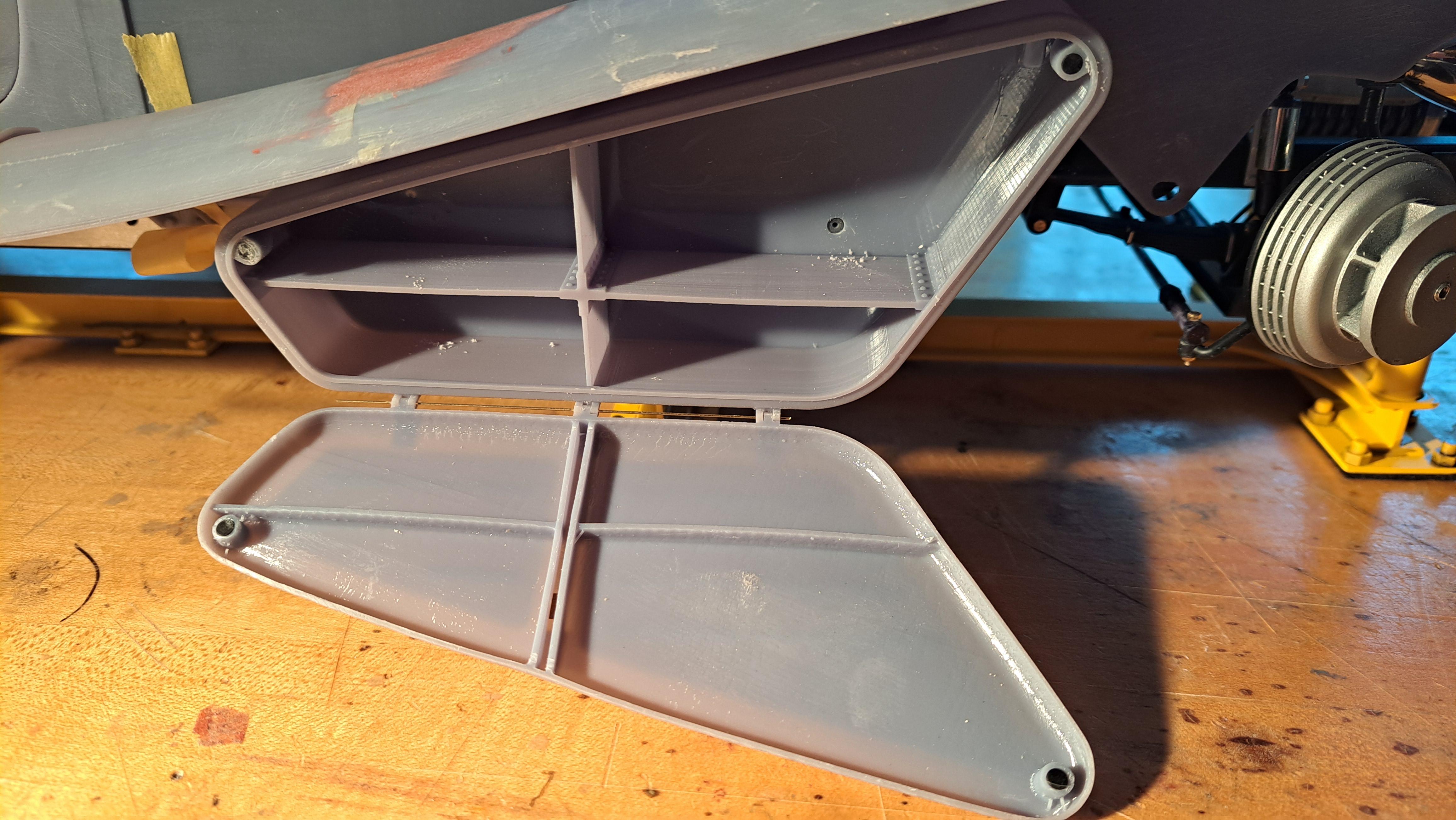

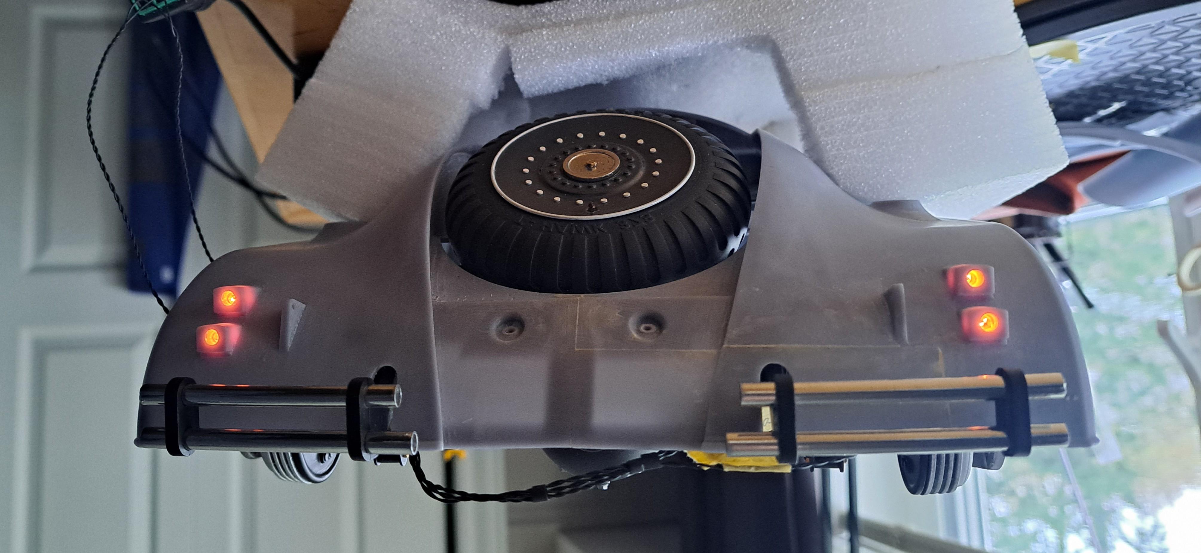

Did a bit more work on the Hydra Coupe today, both under-fender cases are printed, as is the fender step mats. I also did the fender step ladders and wired the rear brake lights. I'm almost done with pre-primer sanding and should be ready to prime pretty soon. I still need to print the rear wheels side covers but not a big deal.
Side case
Step mats and ladder
Wired brake lights
Body parts ready for primer

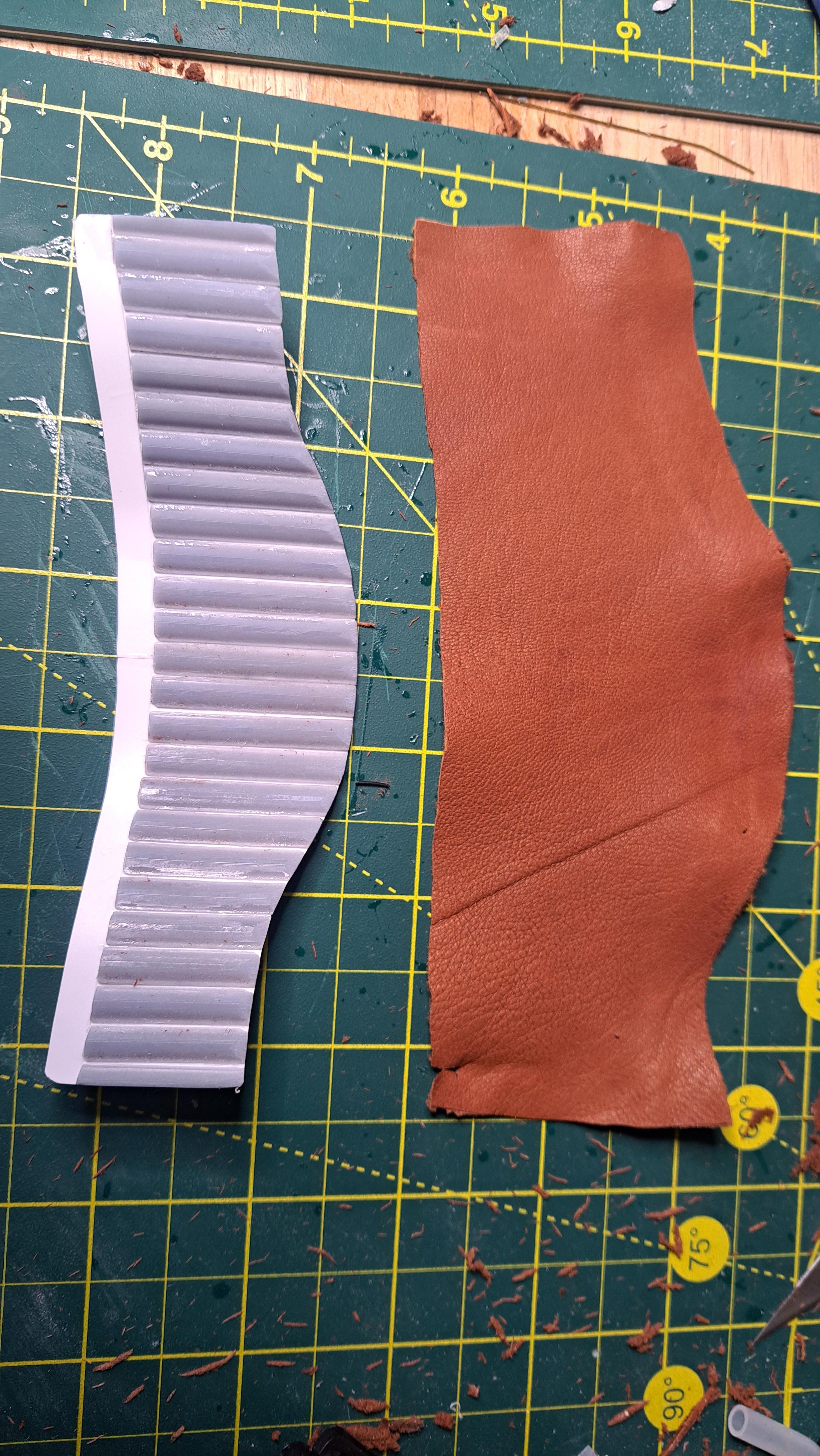

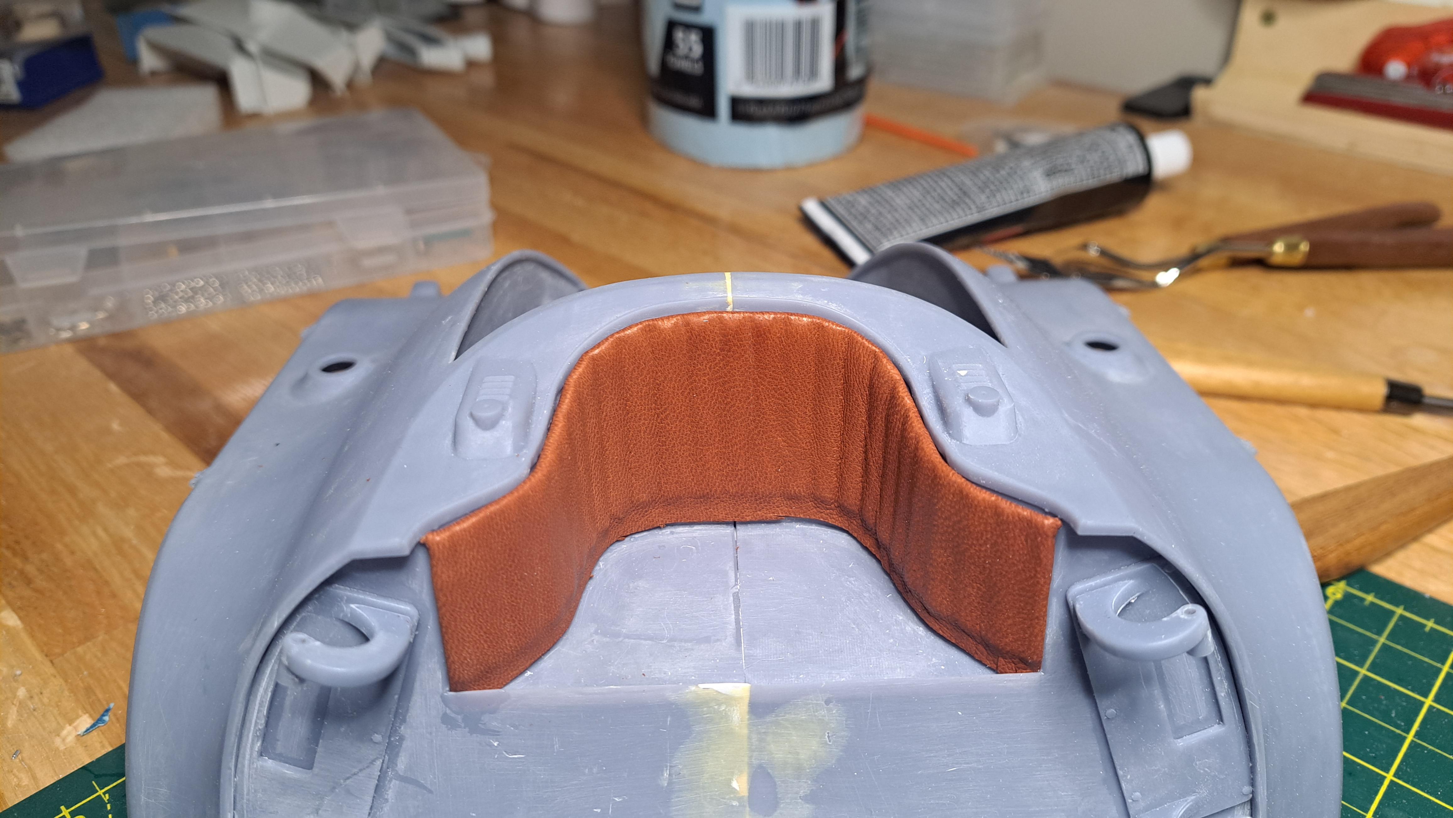

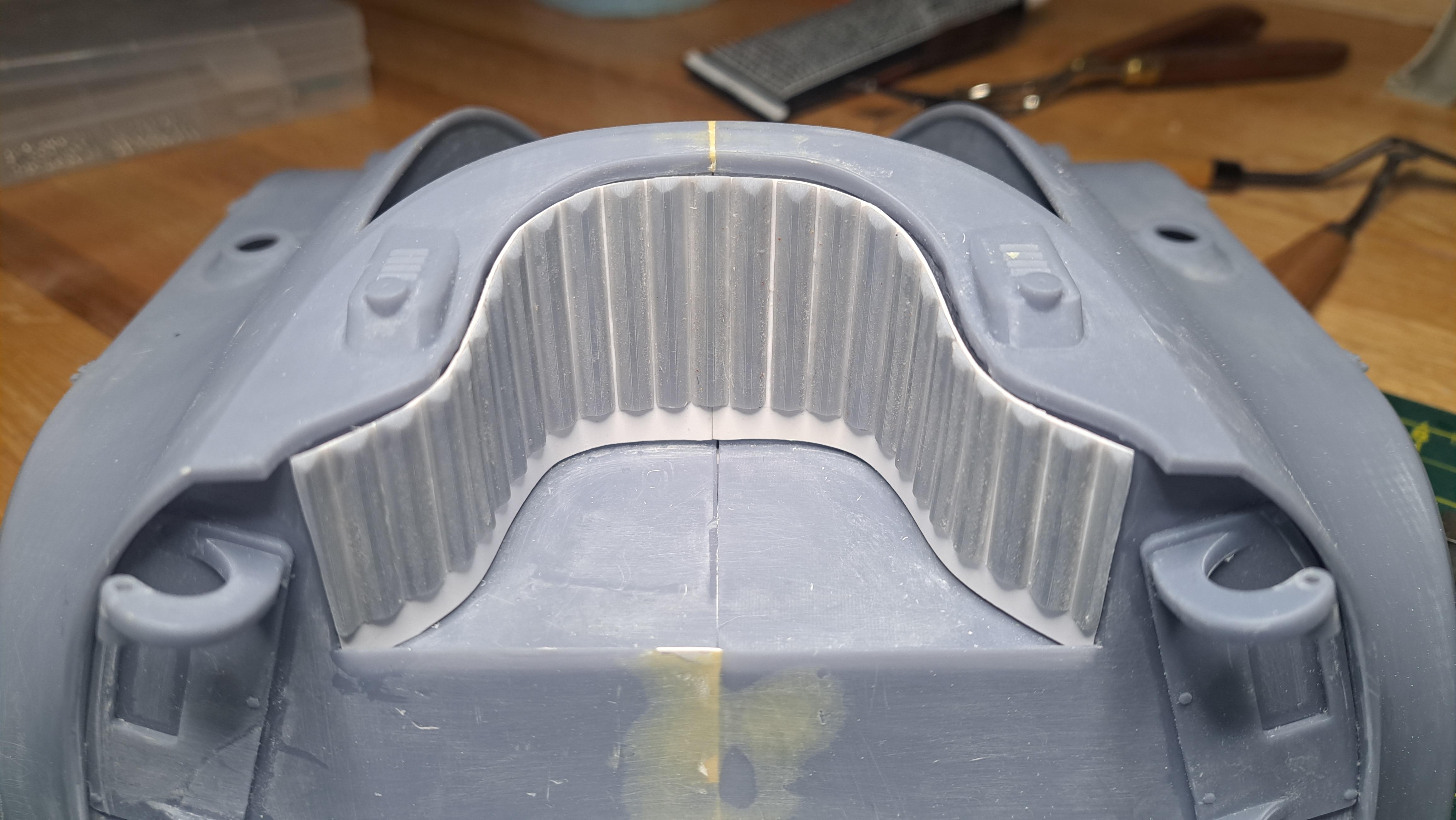

I did the rear seat today. Here's how it was done.
I first made a paper template of the back rest.
Which was then transfered to a .015" thick plasticard

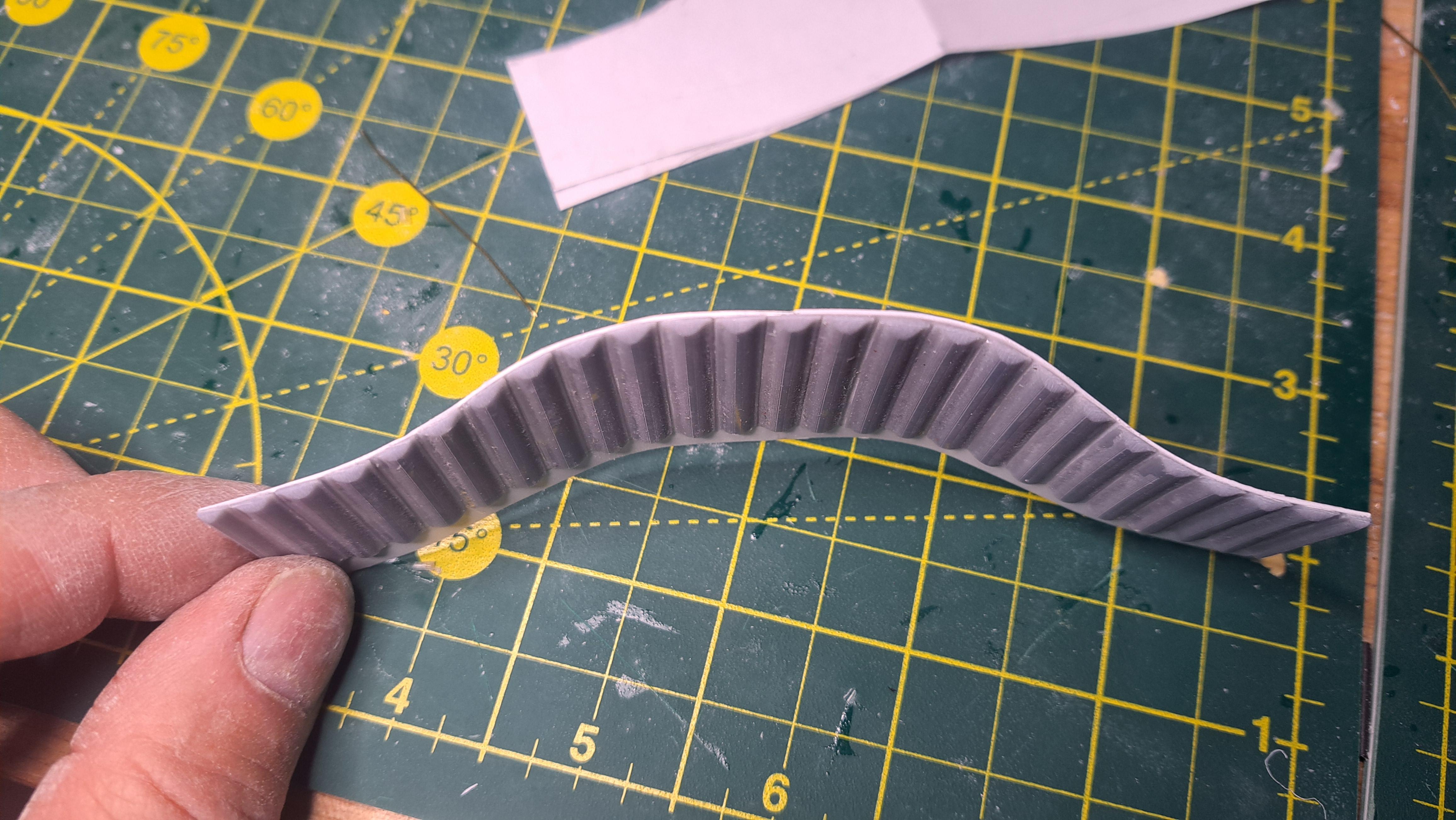

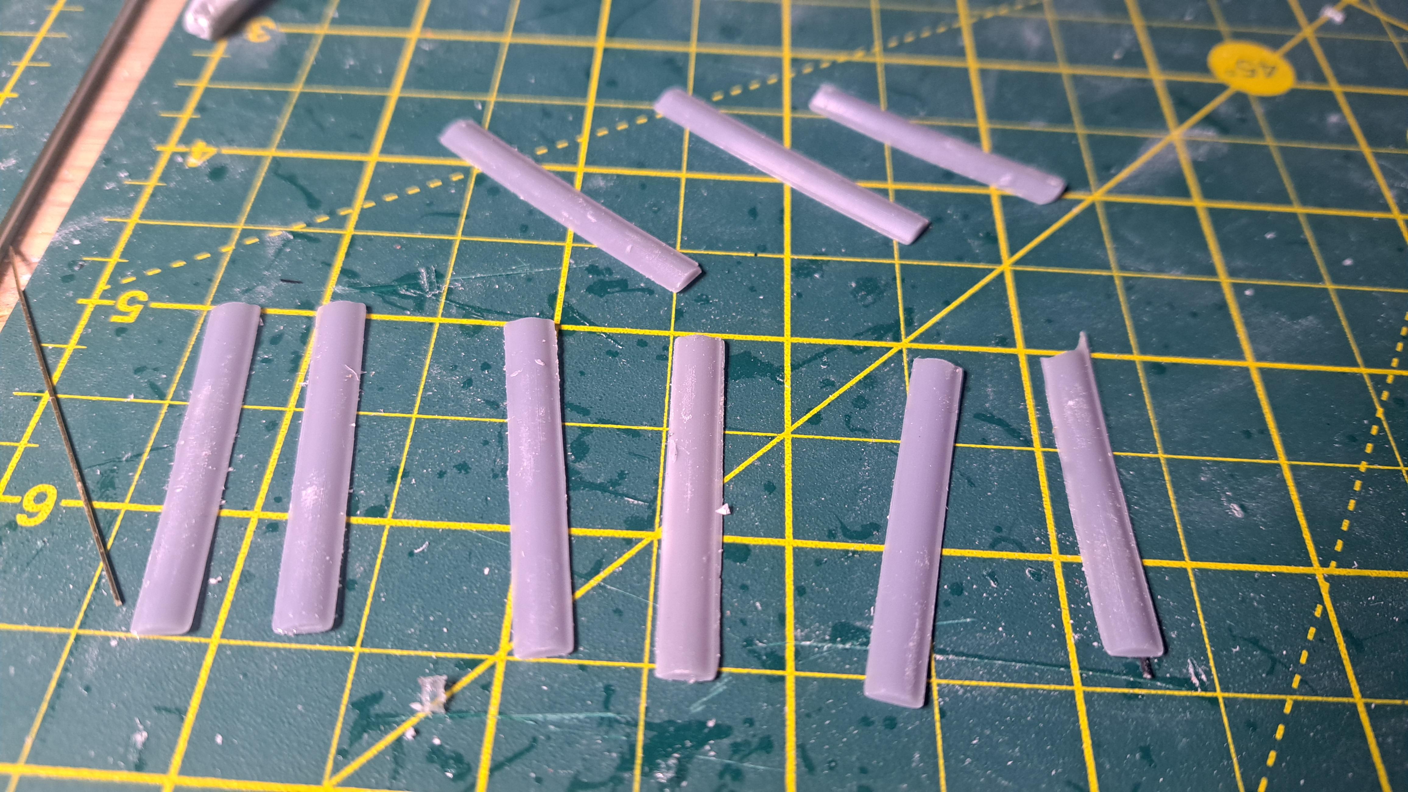

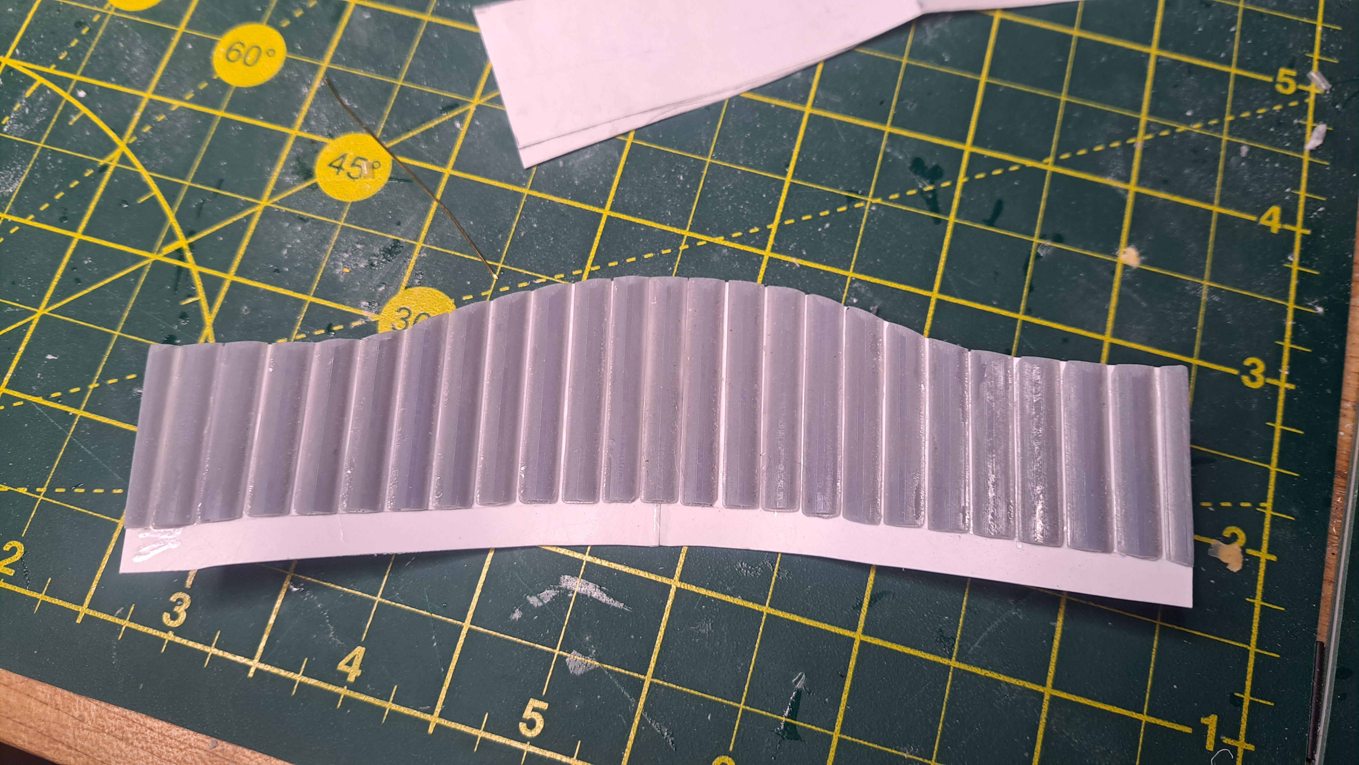

I 3d printed a bunch of domed strip to create the back cushion shape
Which were glued to the plasticard

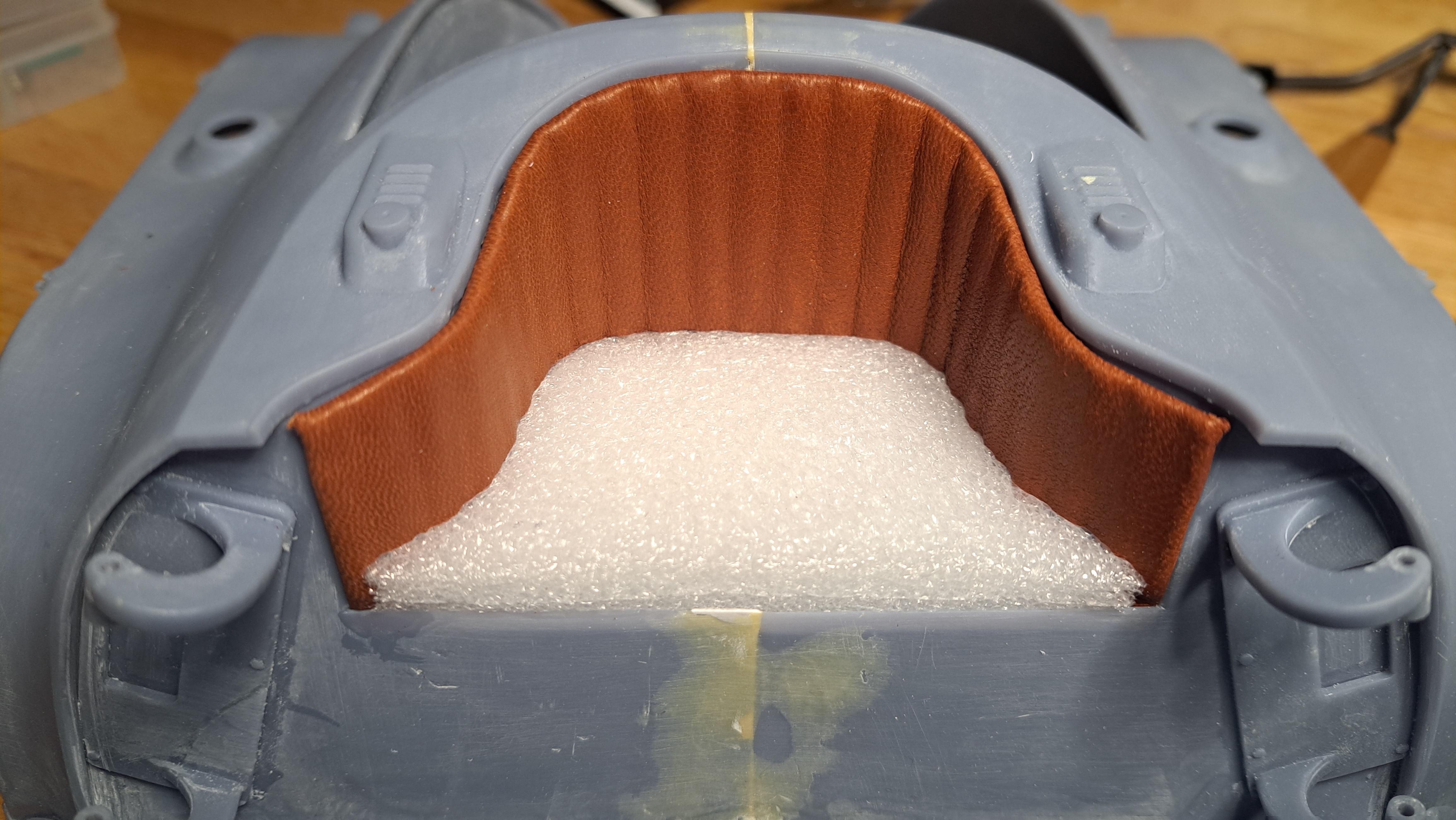

Next came the leather
And once glued
I then cut a piece of white foam for the seat cushion
And covered it with leather

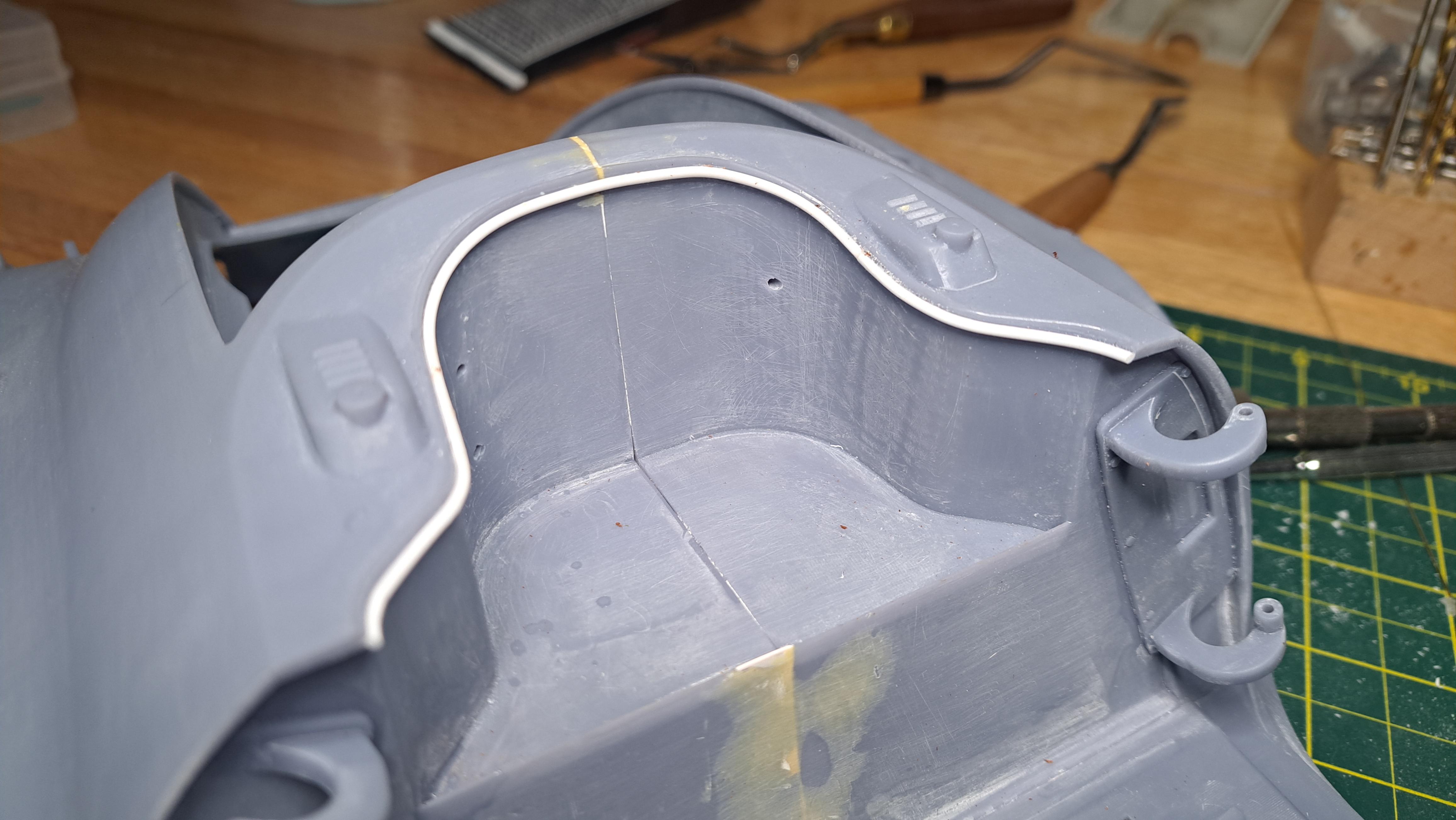

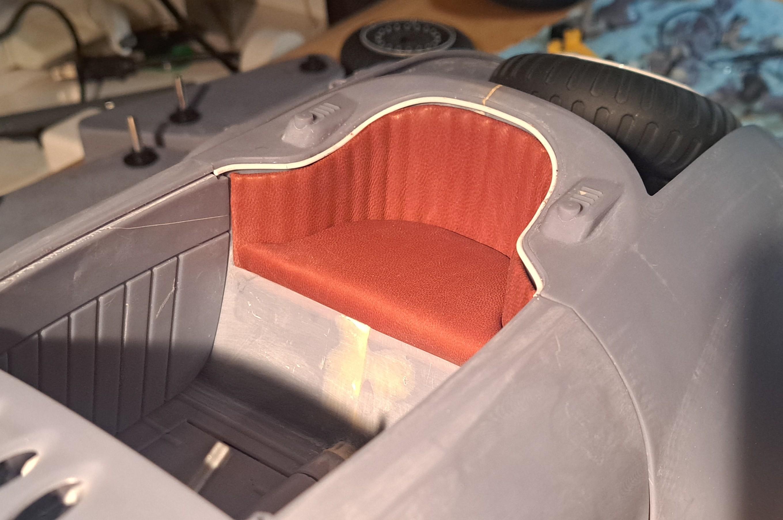

But I didn't like the gap between the back cushion and the body so glued a 1/16" dia styrene rod to create a lip that will hide the gap. The rod will be painted the same color as the bodywork.
I'm very happy with the result even though it's not final since I have to remove the seat for painting.
