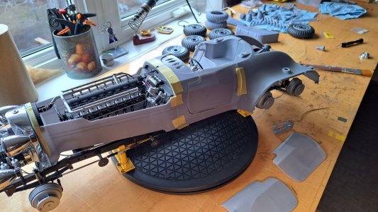

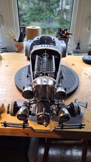

I post on 3 different forums and explained on all 3 my conundrum. I received plenty on interesting ideas l. But there's one that I think will be best. It's rtwpsom2's. I'll but the body on the rolling chassis but I'll modify one of the front lower panels to give a good view of the motor and all the bits and pieces that are worth seeing, probably on the steering column side. The underside of the model could be seen by reflexion on a mirored floor. I can also raise the hoods to give an even better view. I slightly modified the body to be able to lift it from the frame if need be. With this solution, I get the best of both worlds, a good view of the fun moving stuff and the great looks of the body on the frame with the wheels and all the trimming. I'll post a pictures of the 3d model showing all this soon.

So here's the 3d model showing the modified left front body panel that give a good view of the engine.
And when seen from the other side

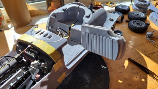

The body is slowly being printed. The rear end is quite big to print, even in 2 halves. My first try didn't work. But still, it's starting to look like something a vilain would drive.
First rear end half print, close but no cigar. It's as if the max printing volume the slicing program gives me is incorrect, the top of the part didn't print (circled in red). It took over 12 hrs to print and 500 ml of resin, oh well...
But still, it's getting there
For those wondering where this gadget is going

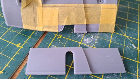

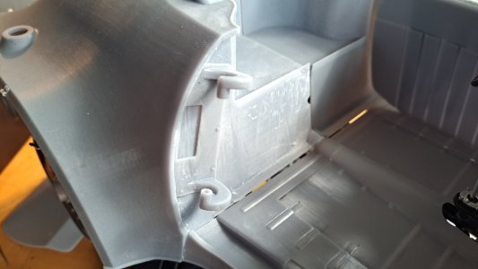

All major body components are printed. I had another issue with a rear body half ( problem with the U shaped cutout for the bumper) but this time I was able to repair it. I printed a patch and replaced the section. Still needs a bit of putty but it should be ok. Also printed a test door, the outter sheet is too thin. I'll have to thicken it a bit. I decided to print the outter sheet and inner panel as a unit. Once painted, I'll be able to apply the leather. Speaking of leather, I found a piece of nice thin brown leather that should look pretty good (thanks Rick).
Rear end repair
And once repaired

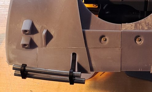

It's update time. I started gluing up tge body together. First is the rear two halves. I installed some fish plates to better align the two halves and to get more gluing surface. It came out good, is rock solid and very well aligned. I'll need to do a bit of epoxy putty on the seams and gaps but I think it should look pretty good. Both door hinges are glued in and I even added some rivets to the only fish plate that will be visible (with the trunk lid opened). I also printed the trunk lid but it's not to my liking, I added some longitudinal stiffeners to the new one that should help to better maintain the shape. But even with it not being perfect, it still looks good.
Two halves glued together with white styrene fish plates in place
Riveted fish plate
Hinges installed
Test fitting of the bleu cube thingy which fits as planned
test fitting of not perfect trunk lid

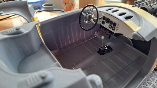

And a few general pictures
