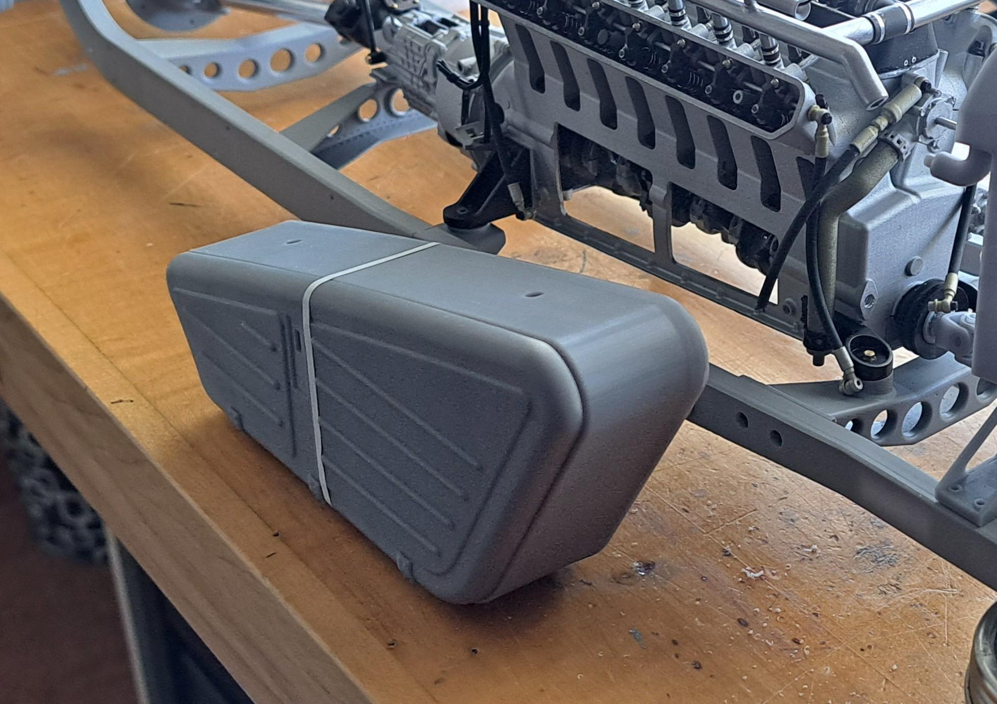

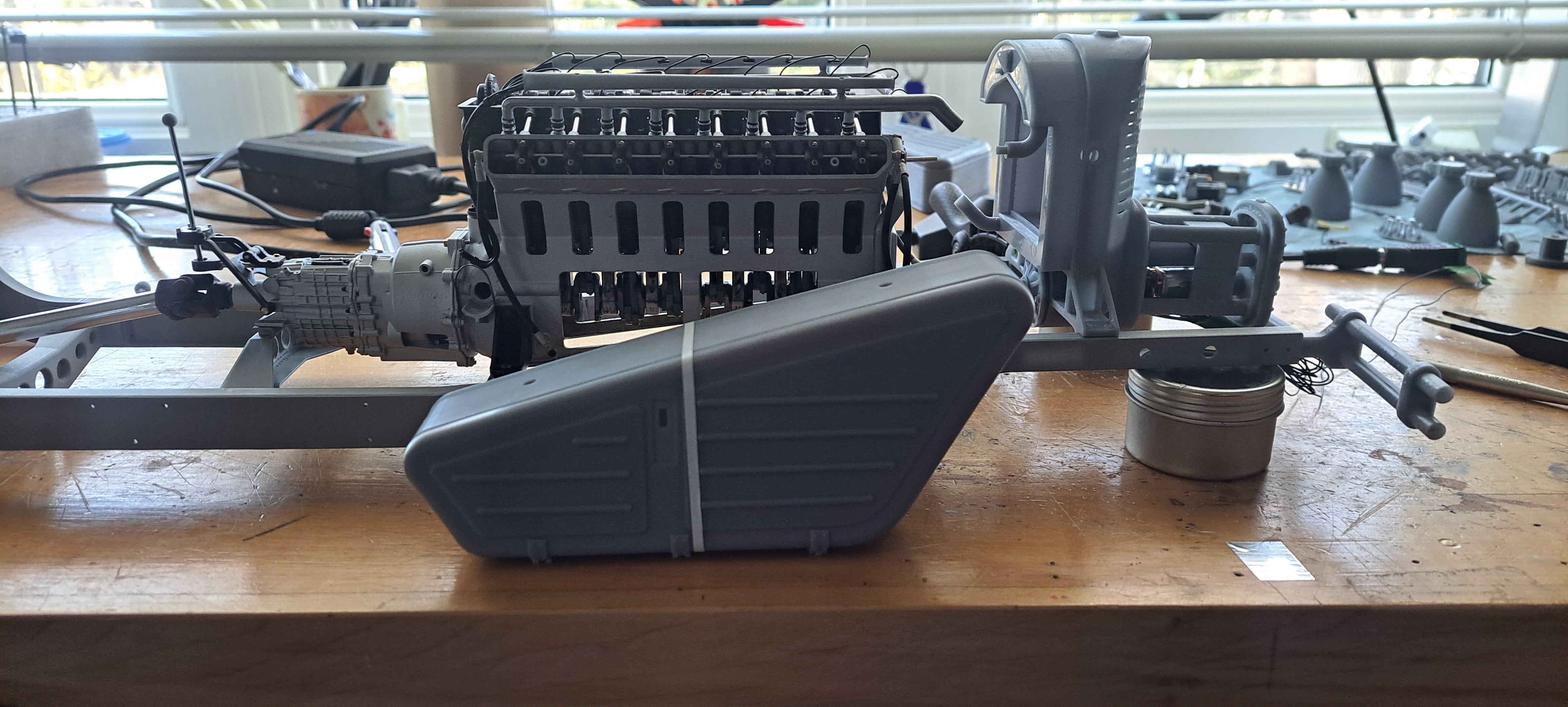

While waiting for the new motors to arrive, I started the frame. It's all printed and assembled, a lot easier and faster to print and assemble than the engine. I also test printed the radiator since the new gearmotor will be mounted in it. For a test print, it came out pretty good. At the risk of repeating myself, this model will be huge !
The assembled frame (that's an 18 in ruler next to it)
With the engine
and the gas tank I printed last summer
And with the radiator cowling and blower
I'm always impressed with what the printer puts out but like I said before, garbage in, garbage out. I guess I'm not giving it too much garbage !!

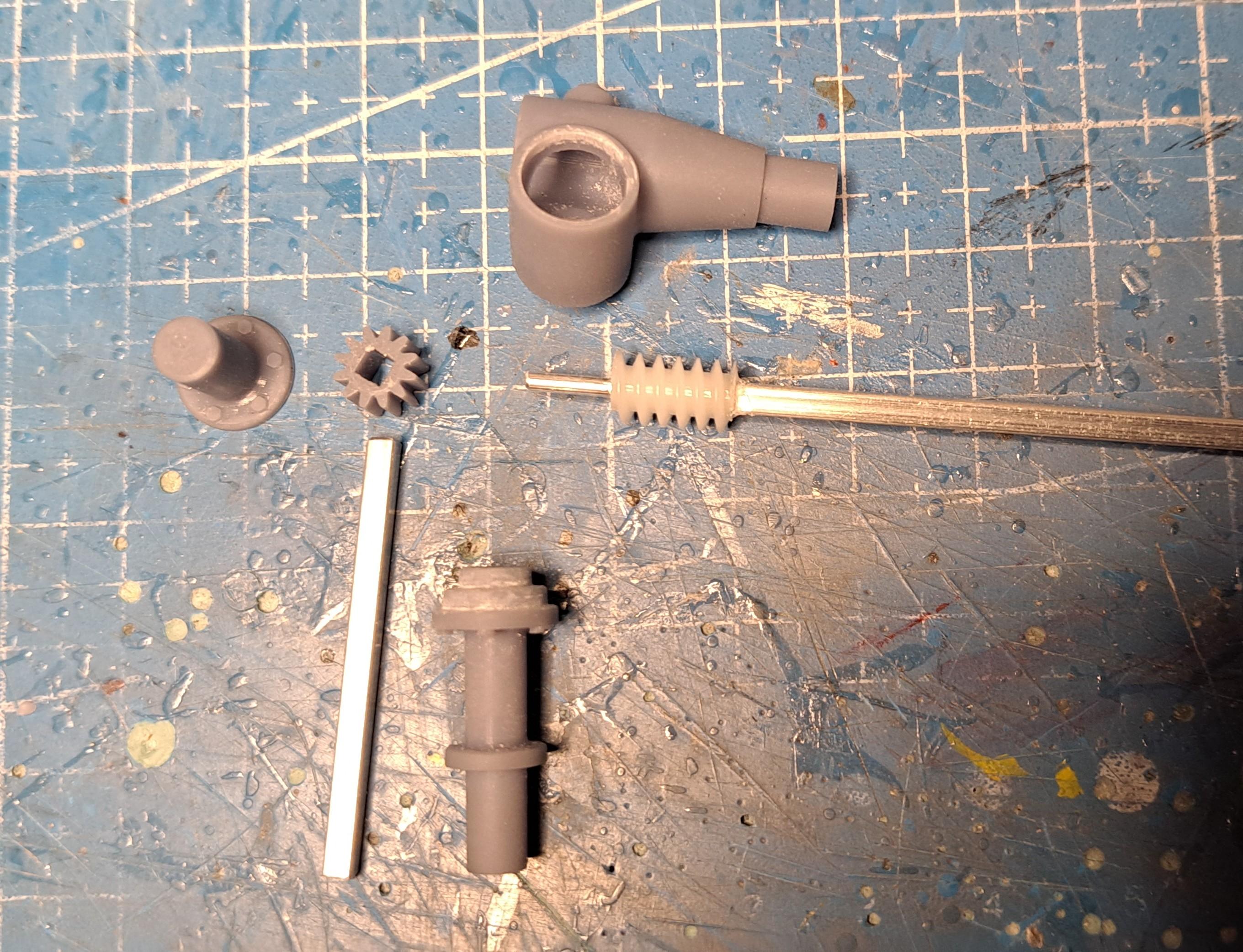

I've been more busy skiing than modeling this past week but I still managed to finalize the blower drive. I decided to add a subframe between the radiator and blower front face to facilitate the assembly and paint. This way, I can chrome both the radiator and blower front face at the same time without having the blower housing in the way. Since the blower housing will be painted the same color as the bodywork (color to be determined), I made it in two halves that can easily be assembled later. I also made a small drive shaft between the crankshaft and the blower. If this was a real car, this shaft would drive the blower from the engine but on the model, since the gearmotor is hidden in the blower it's the other way around.

Small drive shaft
Gearmotor spur gear (bottom) driving blower spur gear (top)
