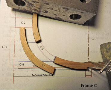

As i build i realized it is important to built the frames as accuratly as you can. Just building and stacking worked fine in the mid section because all the frames were close to the same shape. But as you move forwand and backward the frames change shape from one to the other so just stacking becomes less reliable.
First i pinned the floor to the keel location and used a heavy block to hold the top piece in place.
Notice the horizontal lines they are there because you need to place the parts on those lines. If you are to high or low you are changing the arc of the frame.
take a close look
to glue part C3 it has to hit the upper line
everything you would ever need to know Mike has on each frame drawing
as i was saying try and build the frames as accurate as you can not only do you have to line up the parts side to side but also top to bottom and that is what the lines on the parts and horizonal lines on the plans.

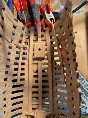

The small platform located over the mizzen mast step is framed with beechwood the planking is pine and the opening frame is myrtle (a local wood found here).
Progress photos.IMG_3953.jpgIMG_3954.jpgIMG_3955.jpgIMG_3956.jpgIMG_3957.jpgIMG_3959.jpgIMG_3962.jpg
