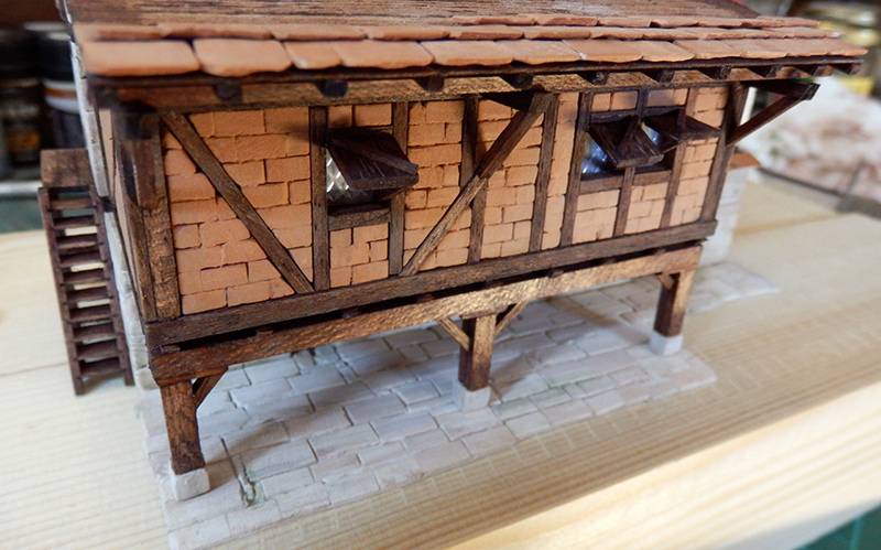

I finished laying the tiles in the covered market.
So I'm moving on to the suite that will be the "rural" house... Actually a town house. I'll have more to do, but this is the one from the basic kit.
And I'm transforming a bit what was planned: everything was to be made of stone. My version will have half-timbering on the first floor, which will be filled with bricks, the ground level remaining in stone.
The back wall is a part of the village wall: it will be with large stones for the sole, and normal size for the rest.
A 1st thin structure (1mm) of the studs is in place: it allows the 3mm thick bricks to be wedged. Once the bricks have been sanded, a 2nd layer of 2mm stained wood will come flush with the bricks ;)
The construction continues quietly with the installation of the openings.
On the back, the stones are part of the outer wall, so they are rougher on purpose. The first bricks between the half-timbering are also started to see what it looks like.

Small update :
- finished stone walls
- the studs are in place
- the first floor roof canopy
- window shutters
- all doors
There's still work to be done:
- the tiles in their entirety
- the stairs on the right (stone) and left (wood)
- stone doorsteps
- paving on the floor
- the pillars of support
- overall ageing
Thank you very much Jim: I love your enthusiasm!
This house is finished. :)
Some final pictures :
