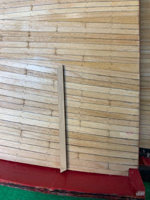

The work on upper deck continue and few mistakes were corrected. Also supporting beams were put in place. Make sure you turn the numbered side of those towards the rudder as the numbers were impeded into the wood, not sure why, otherwise you will be able to see plan number 13-I all the time.
In front of the deck I put a layer of tiny veneer to cover bad looking plywood.
Peak under the deck..
Happy modelling..

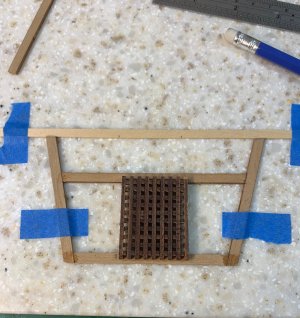

Then on the old piece of countertop, as a perfect flat surface, I glued two parts together..
The gratings was done before so this will be used here..

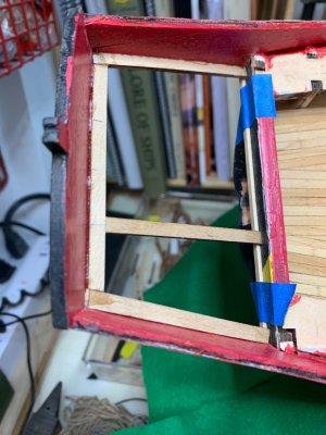

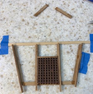

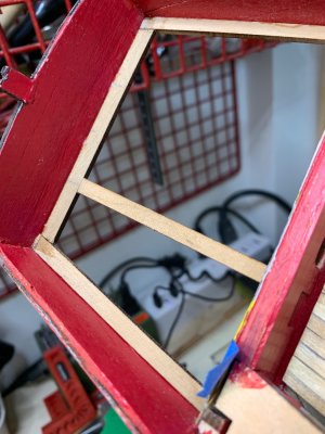

Unfortunately some of the gratings structure work has to be redone, again, due to lack of drawings and measurement... OK enough whining ...
With assistance of a friendly acetone, I was able to salvage the most wood parts I used in the first attempt..

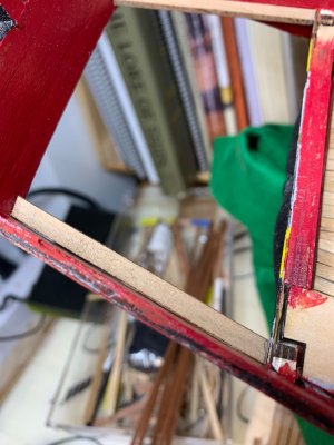

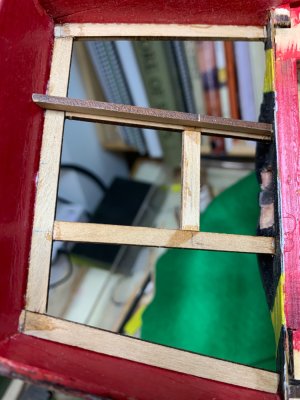

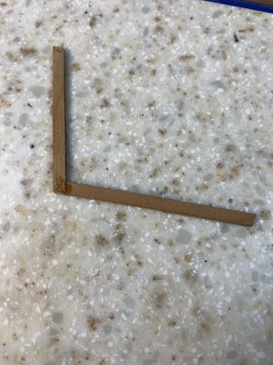

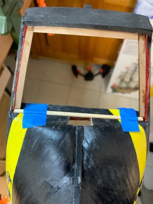

First the frame was cut, sanded and shaped to fit in the opening. The bottom plank is there just for support and levelling.
Then one of the middle parts were cut and sanded. Checking with angle to make sure it is straight...
Ok, looking good..
The second middle piece was added in the same way.
Important part is to make sure there is no glue on the supporting plank otherwise more cleanup work will be needed.

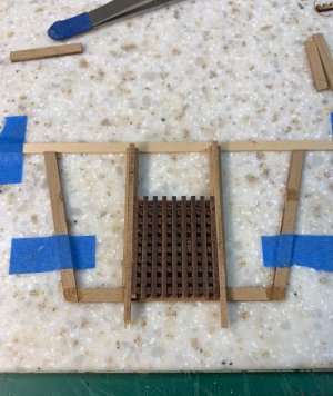

Checking gratings fitment and marking the middle of two recently installed parts. Shorter plank will go here to support gratings on both ends..

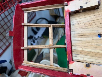

The cross beam was also put in place and the gratings support as well.

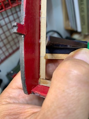

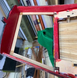

When you do these gratings support beams, make sure you check the angles on both ends of the plank so it will fit into hull curvature nicely.

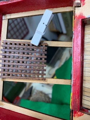

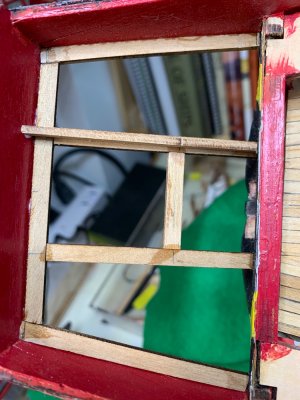

Second support beam done.. and gratings fitting test..

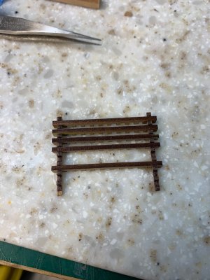

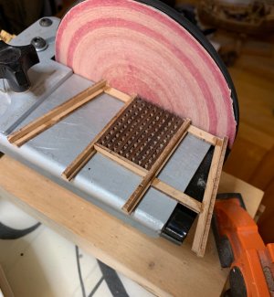

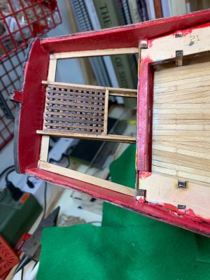

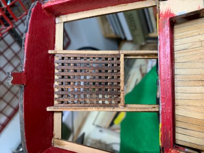

Now, let's make gratings for other two sides, left and right from the middle one. This one is special beacuse it will be cut on the angle once gratings are assembled, hence the reason for less grating combs needed.

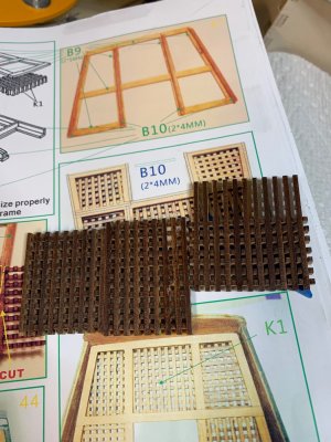

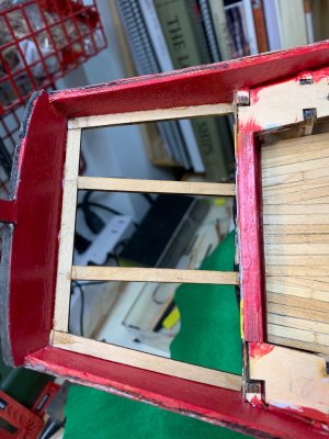

And now, the HMMM moment!

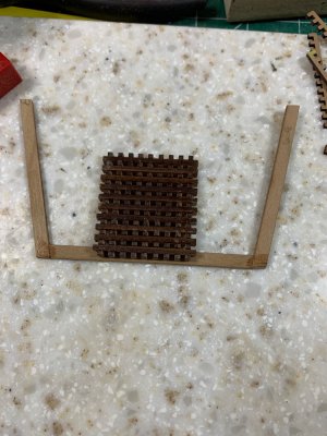

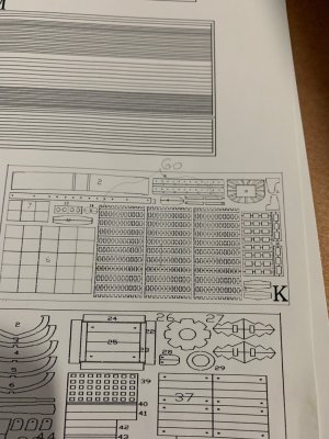

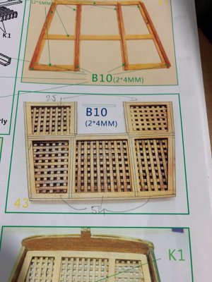

I built gratings structure for right and left side, but for two on the bottom I do not have enough combs. Let me check the number of gratings needed from the plan and actually provided in the kit..
So counting from the plan I need minimum 80 combs and this does not count extras you need to put in that will be removed by cutting grating by the angle.
The plan actually shows 60 combs available, and this includes the bottom and top one from each column frame which are not actual combs and are higher than needed but in "emergency" they can be used with few modifications.
So here is my situation now.. 54 combs in use, 3 left but not enough for enough for two openings - those are two openings, shown on bottom picture, left and right to the B10 marking on the kit manual..
Well, HMMM again... unless I am missing something here.
Do I bother complaining to the ZHL with attempt to maybe get some extra combs within the next three months OR just do another scratch build and wrap up this part of a build?
Pretty sure I will not get any response from ZHL soon enough (or maybe too late response) so might as well see what I can do.
Am I disappointed - absolutely..
Happy modelling..
