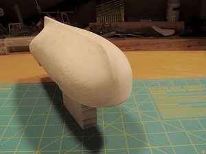

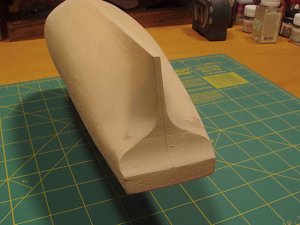

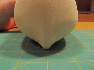

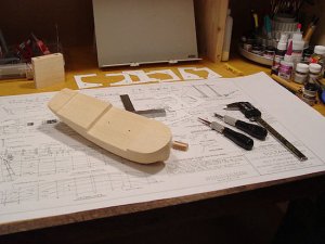

Well, I haven#180;t heard from anyone lately, so I don´t know if that is a good sign or if everybody is scratching their heads! For me, I am sanding and staring at the plans trying to decide whats next. I have only "profiled" the hull and marked the center lines. thats it! I made a small error and sanded just a tad too much on the transom, but that was easily repaired. I am now on to trying to mark the other templates onto the side of the hull. I personally have stopped myself several times with almost making several mistakes. As they say - measure twice, cut once. But with me, I am measuring 3 to 5 times and cutting. Unless someone else is different, it is so easy to make a mistake on the hull carving.

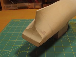

Go slowly as it is easy to carve too much before you realize it. I hope to start carving on the hull this evening. I decided to go ahead and remove my bulwarks and I am glad that I did - it does seem to make things easier, however, everyone should feel free to express their modeling taste. Also, marking the center lines can be tricky too. I bought me a center ruler or a zero center ruler. Very nifty item I must say.

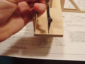

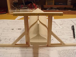

I make jigs not so much that I enjoy doing so, but I do it because it helps me figure things out better. It is not for everyone, and also, you can be welcome to copy any ideas that I come up with. I am sure that this goes way beyond anyone that cares to get this involved in trying to find the "center" on anything. Actually, I am not being perfectionist about this. I am engineering minded so my heart follows with the gadgets and jigs to help me do things better. At any rate, I do not want to become long winded as there are people that have other ideas that would suffice them. I made for lack of better description, a trellis as you see here to help facilitate many things. It has helped me so far in a lot of measuring. The trellis are glued with regular Titebond - no nails. I used a machinist square to make sure they are square. The other stick across the top is a feabled attempt to make a "center" ruler before I actually found one in a store. I used this jig to help me find center across the whole keel.

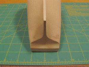

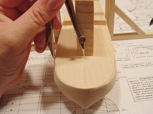

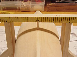

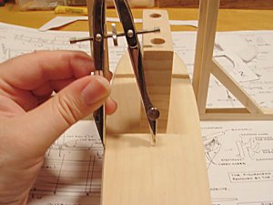

As far as the deck or top of the ship, I used plain dividers as the photo describes in itself. Ok, now, I found that my hull out of the box was not centered. I found that the Keel Center Line was (ok at the stern keel but off about 3/32¨ or a little more at the bow of the keel). sorry about my lack of nautical terms. (forward Keel "off" aft Keel "ok")
How did I find this out - I am trying to remember !
It seems that I had the ship in vise with deck up as I was looking down on the deck. I took the pair of dividers and I measured the "center" at 3 places. The 3 places were the 3 deck steps. Aft Step, Midship Step and fore Step. Again, I plead forgiveness of my lack of nautique. I marked the Center Line with a mechanical pencil. I then turned the ship over with the Keel facing upwards. It seems to me that I took some sanding paper wrapped around a 3/8¨ square stick and I started to lightly sand along the whole keel until I started to notice a good visible flatness of the keel. I think I measured a 4mm width and maintained that while allowing for the sanding to find the "natural" center by sanding. This worked for me, but I did have that 3/32¨ offset at the bow. However, let me say that after I drew my line down the center of the Keel , I noticed that the Center Line of the Top of the Deck LINED up with the Center Line of the Keel. So with that, I figured that by sanding the keel edge first, it sorta found its natural center. I am not sure if I am explaining myself here or not. Maybe I got lucky, who knows. Let me say it this way. Straight out of the box, I measured the Center Line on the deck. I turned the Ship over, and did not measure anything, but started sanding the keels edge. By sanding the Keels edge, the center of the Keel became more prominent and exposed enough. Then I could mark and measure the center line of the Keel from aft to fore.

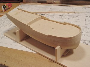

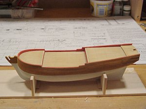

Well, this is as far as I have gotten. For those that notice, no, at this time, I do not have provisions for my upper planking-on-hull "yet". I want to be fully satisfied of how the templates work as per out-of-the-box. When I am happy with the hull shaping, then I can turn my full attention to how I want to complete the sanding process to "allow" for the upper planking above the wales. I still have some areas on the overall hull that still need some shaping. I am looking for the correct hull-keel- to the top-of-deck relationship to be correct. At this point, I am entertaining the thought of using 1/64¨ basswood to do the upper planking. I have some 1/64¨ and 1/32¨ birch that I will look into for the deck. It is interesting as I mentioned in an earlier post that the birch color looks so close to the actual deck color that I am after. The discoloration that you see (one is gray and the other is dark patching), is a grey primer and wood filler. I know that the wood filler is not the same color, but this was replaced by a trip to the lowes to get a matched filler. The gray areas that you see is a simple deal of painting the transom gray so that I can actually see how smooth the transom will look and the second reason, I wanted to remark with a pencil a nice clean scribes to see where I am with the sanding process. By painting this area gray and letting it dry, I was able to see imperfections in my work. No problem about the primer as it sanded away anyway while I was removing those rough areas. The primer really helps in advertising those areas that are lackluster in shaping.

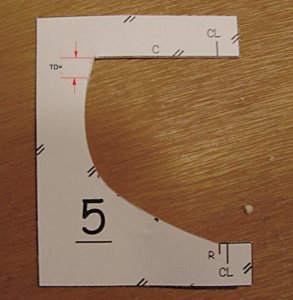

I am having problems with Station #5 alignment. I need to know what TD= _______.
It does not matter if it is in mm or inches. I think I have a measurement of 5/32¨ or about 4 mm. Something is wrong here. This is the only station that I am having problems with the Top of Deck (TD). I wish I had more time to describe what is wrong folks, but maybe later. I have included a picture below.
June 25, 2006
Station 5 is exactly in line with where the volute will be positioned. There is a small step up from the waste. I would measure the distance to the underside of the cap rail just before the volute starts to curve around. The measurement I have there is 6mm. That is from the top of the deck to the underside of the cap rail. To be safe I would calculate and use 7 or 8 mm so you have some room to adjust that height after you finish building the bulwarks. It is a lot easier to sand away excess wood than add it later.

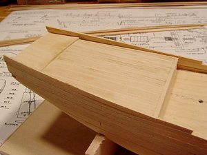

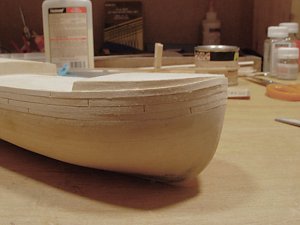

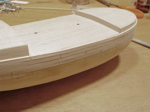

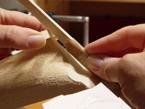

Ok, all can laugh at this one, but it works for me. I ran my plank under hot water for about 15 seconds, and slowly bent the wood a little at a time, and a little more hot water for about 10 seconds enough then to wrap around this small can. After about 30 minutes or so I remove the wood strip and apply to boat. The reason that it looks that way is that I form the arch to cup around the bow of ship.
July 12, 2006

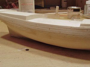

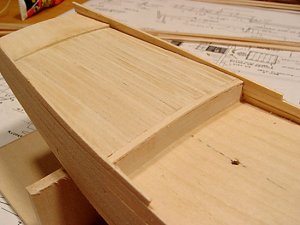

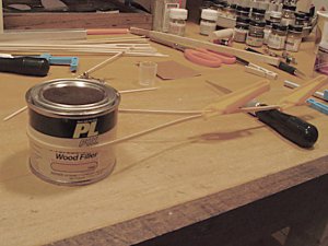

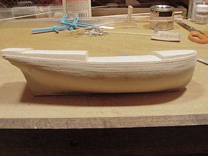

Some progress - had to do some major carving sanding again after I started laying the planks down. The planks don´t lie - gotta have a trued hull.

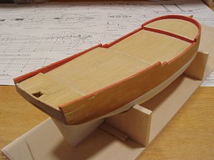

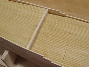

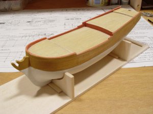

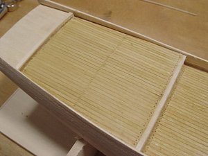

I plan to do my decking and then lay my inside bulwarks. Again, I stripped my own decking. from a sheet of basswood 1/32¨ thick. Width is about 5/64¨ for each deck strip. Not at all finished with the upper planking, but got my own reasons / desires to start some on the deck.
July 31, 2006

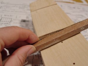

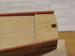

Decided to go ahead and layout the decking using my 1/32¨ x 5/64¨ basswood that I stripped myself - wasn´t fun doing it that way, but I am happy with it. I then could not rest on the stain as I looked and found something I liked but could not find it locally. I settled on using some Danish Oil that I had laying around. I guess I am not too picky huh !
I used a dremel to drill out the nail holes in the deck. I can subdue then simply by sanding over them. I chose a random point kinda - not choosy on the selection of the deck nails (faux)
Now, I can move on to laying the "inside" bulwarks.
July 22, 2006
Now, I will say in honestly, I was wondering about the true spacing of all of the fastenings. Ignorance of decking is obvious here on my ship, but, I am happy to note that you chimed in so that I can investigate. No, it doesn´t take long at all to do this on the deck. Now, that I have thought about it right now, I am wondering if I should have taken a pencil and instead of making a hole, make a simulated plug using the pencil tip to make (not a hole) but a "dot" to represent the plug. However, I have found with a little extra sanding, the holes are filling up leaving or revealing a mocked up "plug" !

Ok, here are some pics of the latest. I am ready to start on the brass pieces for the Rudder and start building the Transom today. I want to say that if you see some marks and some dings that is just due to accidentally breaking something or whatever that I plan to go back and touch up more as I go along. I wanted to show the detail of the rudder opening area. I got that off of a website and I will be glad to share that site, but I need to go back and look it up.
