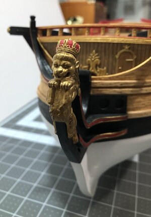

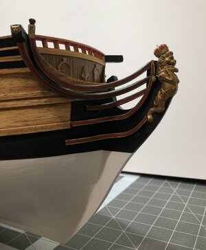

I decided to add red to the rails on the beaks head. The vertical supports will be gold with red squares inside. All gold just looked too plain IMO.
I still have work to do. I am going to trim away some of the black vertical support behind where the rails end, and finish shaping the top. I will address that when I finish the rails on the other side.
Meanwhile the Lion is feeling his oats! ROTF
Well with that lion in sight, there will be not sleeping tonight in the jungle!
Had you thought of a dab of black or red in center of eyes to make the glare stand out just a bit?
If you look closely there is a tiny hole in the center of the eye, that is black. ;)
If you remember, he used to be a laughing Lion! ROTF
