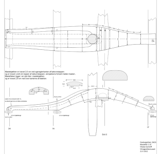

The more I looked at biti #0, you know, the one I already moved :rolleyes:, the less I liked the way it looked. The profile is wrong, the shape is wrong - I just didn't like it. I decided to scale the drawings from Dr. Bischoff's paper and make a new one. First I had to remove the old one. I didn't have room to get the Fein tool in like last time, so I started by chipping out portions with a utility knife.
I picked up a set of miniature planes at Harbor Freight. I wasn't expecting much for $15 US, but they turned out to be surprisingly useful. There is a conventional plane, a bullnose plane and a scraper. I was able to smooth the frame pretty well straight out of the package. With a little tuning and sharpening, they will be a nice addition to my ever-growing collection of tools.
I attached the side view pattern to a piece of cherry with a glue stick, cut it out on a scroll saw and then glued the top view on and did the same.
I drew some guidelines for the deck ledge on the sides and using those and the ones still on the pattern, I cut rabbets on each side with a utility knife and small chisel.
A little sanding and fitting and I glued it on where the old one was, holding it down with some rubber bands.
I plan on sloping the deck boards up as they were in the original, but since the distance is now greater, I can't use the provided ones. Also, they must transition from flat on one end to angled at the other. I have an idea for that, so once I get a proper piece of cherry, I'll post my method.

That's another incredible change that you have made.I noticed there is no ident for the mast on your new biti.
Thank you Jan. You are correct, there is no cutout in the biti for the mast. You can see from Dr. Bischoff's drawings that the forward side of the mast, which was left flat as I have duplicated earlier, simply rests against the aft side of the biti. The mast partner keeps it in place. I may have to just slightly adjust the position of the step block aft by trimming it a bit, but fortunately, I haven't glued it in yet. I have scoured the book everywhere the mast or rigging is discussed, trying to find a reference to the rake of the mast. I found the word "rake", but no angle - anywhere. It's possible that they just couldn't determine what it actually was based on the condition of the find. Drawings and photos seem to imply that the mast sat at 90 degrees to the waterline. I'll keep looking and wait until the very last moment to affix the step block.
