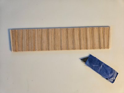

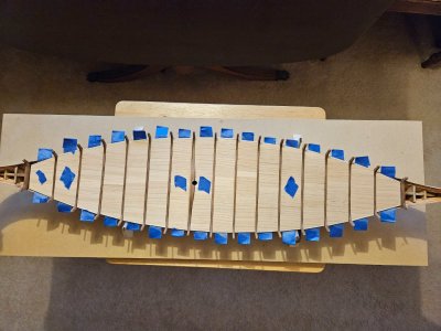

Deck boards (cont'd)
Work continues on preparing the deck boards. Boy, there's a lot of them!

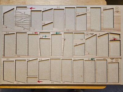

The first step was to get all the "rooms" worth of boards separated, the long edges sanded, pushed together and taped so I could sand the short edges to fit between the bitis. I thought it would be pretty straight forward, but there were a couple of snags I should mention. I put the first room #1 together (the one that I moved forward and turned the ends around) and fit it to the boat, but it came out a little bit short. Oh no, what did I do wrong?
Well, my first mistake was not watching the next installment of Pavel's video. After watching, I had an "a-ha" moment. There's a sheet of parts - little strips - that go right at the ends of each row of boards. This is not documented anywhere in the instructions. Sigh. Moral: WATCH THE VIDEOS!
This is the sheet:
Next I did a row #2, based on the sheet numbers on the instructions and it wasn't even close! I started measuring the parts (there are a few single boards and one with 2 boards that isn't marked) and I couldn't make it work out, so I decided to save those until last. Rows 3 -7 went pretty smoothly. Rows 8 needed some work. They came out significantly too wide, but not by the same amount at the narrow and wide ends of the set. So, I measured the width of each edge of the set, then along the ledges where they sit, subtracted and split the difference. I removed the excess from the first full width board, leaving the edge strips intact.
Now, those two row #2 sets. I kept the groups taped together as they popped out of the sprues and then I felt like I was playing with one of those sliding tile puzzles as I shifted pieces around until I found a combination that produced two sets of the same length and that actually fit properly in the boat. Pavel's drawings are confusing at best and I believe the numbering is off. Below are the combinations that worked for me. Notice that one group of two boards is not even marked. The sets marked in red make one row and the green ones make the other.
I have not yet done rooms #9, as I'm still undecided as to whether I'm keeping them as provided or matching the original ship more. You can see the difference in Dr. Bischoff's dissertation, part 2, page 57.
So here's where I am so far. The rooms with the blue tape in the middle are those that don't get treenails if you desire to match the original. Left is forward, right is aft.
On to the drilling...

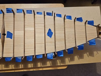

Work continues on the deck boards - this is going to take a while.
The next step was drilling treenail holes. I had the opportunity to use my new toy - the Arrowmax drill. I mounted it on a piece of plywood to make a larger table. I found that even with a fence, there is just enough play in the spindle assembly that the drill bit tended to wander slightly. Plus, the unit would bind when using the handle to lower the spindle (maybe a bit of wax on the rails would help that), so I had to use a different grip on the spindle to minimize bit wandering and keep it from binding. Once I figured out a good method, drilling went fine. Despite the shortcomings of the drill press frame, I still think the Arrowmax will shine when handheld like a pencil for tight locations. I think it would beat a pin vise, especially with the number of rivet holes in the strakes (yet to come).
Once all the holes were drilled, the next step was to get the deck boards sitting at the same level with respect to the bitis. Pavel shows doing this in his videos. There is no standard amount to remove, so each set requires repeated test fittings as you sand. Five minutes on a table saw with a piece of scrap created a sanding block that does the trick rather quickly.
To be continued...

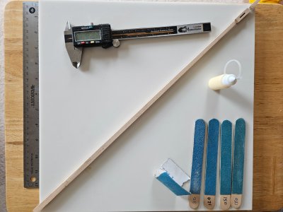

Mast
@JBB , this one's for you! ;)
Our 14 mo. old great grandson came for a sleepover Friday night - yay! I thought I would take a break from deck boards and do something quick and easy while he napped. (To be honest, though, he's just started walking and after chasing that little rascal around all morning, we're the ones who needed a nap! o_OSleep ROTF)
I decided to tackle the mast. It's provide in two pieces because the full length mast wouldn't fit into the box. It's a twice-lasered piece to allow tapering in both dimensions.
First step was to clean up all the char so I could see pencil marks on it.
Next get a good fit for the mortise and tenon on the extension and glue it in place.
According to Dr. Bischoff, the remains of the mast found in the Oseberg (the lower third or so) had a cylindrical cross section except for the forward face which was flat. The mast likely started out as a square beam, was made octagonal and then rounded, leaving the forward face flat. It is presumed this was dong to give a bit more mass to the forward side, making the mast a bit stronger.
Rather than try to "eyeball" it, I decided to draw some guidelines along the shaft, sand the corners to the lines, making an octagon, then finish by rounding of 7 sides. So, first step - take measurements of the thickness at the joint and just below the sheave block (in both dimensions since the shaft is not exactly square, but a little rectangular - not by much, but enough).
Many people think that you can turn a square into a rectangle by dividing each side into thirds and then connecting the diagonal corners. That doesn't work - the diagonal sides will end up wider than the remainder of the original sides. So, you must take the measurement across the face, multiply by 0.707, and mark a line that distance from each corner. If you don't know how I came up with 0.707, let me know and I'll post a little trig 101 lesson. :D
The extension piece at the bottom doesn't taper, so I could use the same measurements at the joint and at the foot. Then, connect the lines ...
... and sand the corners to the lines, forming an octagonal cross section.
After sanding it round, except for the forward face, I sanded the very top portion above the sheave. This I did by eye as it is relative small in diameter. Then I held the flat side of the mast against the table and placed the mast step (glad I hadn't glued it in yet ROTF) on the foot and used it to mark guidelines on the end to make a tenon that would fit into the slot in the step.
Using those marks, I cut a tenon to fit and gave the mast a final sanding. I blended the flat face into a completely round section near the top because I figured it should be round to allow the yard to be easily swung from side to side.
It sounds like a lot of work, but was really only about an hour or so. It took me longer to make this entry into the log than it did to shape the mast! ROTF
So that was my diversion - the baby woke up and it was back to chasing!

His Russ,
That looks great, I've been wondering how to do that.
Steve

Hi Russ,
I like the sanding block idea, it has to be way better than filing it by hand.
Steve

Quality work Russ
Yes, it worked out well. Even though all the decking ledges were placed down against the stringers, there were still a couple that were so high that I would have had to sand more than half way through the deck boards, so I had to get my 1/8" chisel out and pare the ledges down a bit. Worked out well.
Quality work Russ
Thank you Grant!

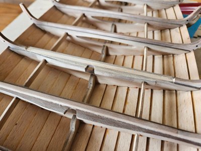

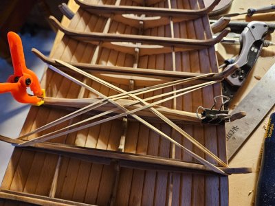

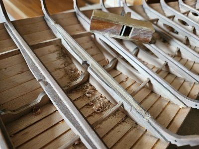

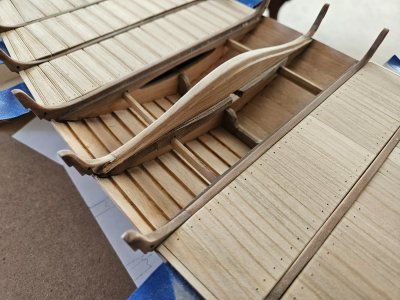

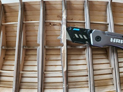

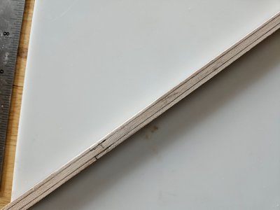

Deck boards (cont'd) and Mast biti
It's been a minute since I posted last. Spring is here and the yard has dried out enough that I could get out and clean up under two enormous willow trees and mow the lawn - all three acres. Whew! If anyone ever tries to convince you to plant willow trees - run away as fast as you can! Willows are absolutely beautiful trees ... in someone else's yard! ROTF Wow, do they make a mess over the winter!
Work continues on putting the double bead profile on all the deck boards and putting a slight round-over on the edges and corners. It's a good thing to do while watching TV, but I can only do one or two rooms worth before my fingers get too sore from holding them in place as I scrape the profile onto them.

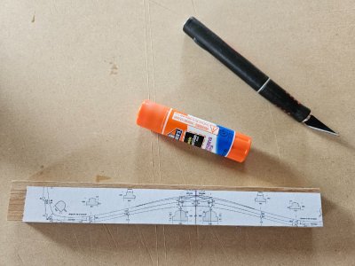

The more I looked at biti #0, you know, the one I already moved :rolleyes:, the less I liked the way it looked. The profile is wrong, the shape is wrong - I just didn't like it. I decided to scale the drawings from Dr. Bischoff's paper and make a new one. First I had to remove the old one. I didn't have room to get the Fein tool in like last time, so I started by chipping out portions with a utility knife.
I picked up a set of miniature planes at Harbor Freight. I wasn't expecting much for $15 US, but they turned out to be surprisingly useful. There is a conventional plane, a bullnose plane and a scraper. I was able to smooth the frame pretty well straight out of the package. With a little tuning and sharpening, they will be a nice addition to my ever-growing collection of tools.

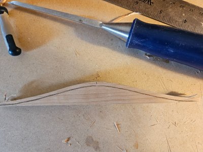

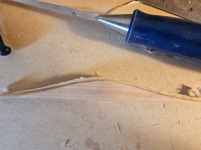

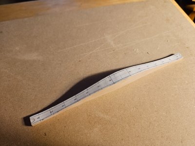

I attached the side view pattern to a piece of cherry with a glue stick, cut it out on a scroll saw and then glued the top view on and did the same.
I drew some guidelines for the deck ledge on the sides and using those and the ones still on the pattern, I cut rabbets on each side with a utility knife and small chisel.
A little sanding and fitting and I glued it on where the old one was, holding it down with some rubber bands.
I plan on sloping the deck boards up as they were in the original, but since the distance is now greater, I can't use the provided ones. Also, they must transition from flat on one end to angled at the other. I have an idea for that, so once I get a proper piece of cherry, I'll post my method.
