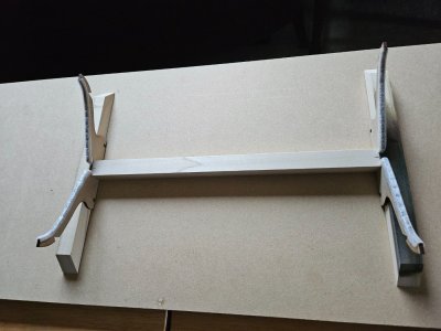

The first thing I did was take the cradle pieces that Pavel provided and made my own work stand. He has you attach them to the building jig, but that requires that you make the keel slots in the jig wider and also elevates the model to an uncomfortable working height. I lined the edges with packing foam to protect the hull and designed it so that I could clamp it in my PanaVise to tilt it for easier access. I also cut notches in the underside for rubber bands to hold the model securely when necessary.

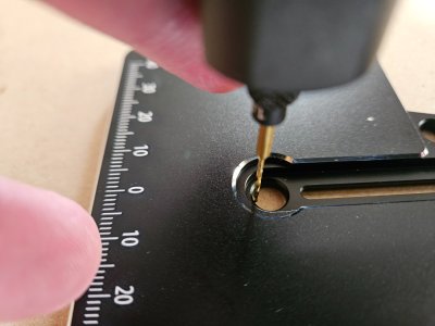

The majority of the provided deck boards are exactly the same size and shape. This becomes important in a moment. The first step will be to mark the faces of those that are different with the identification numbers from the "sprue" (for lack of a better term). I'm marking the faces because I will install them all face down. Pavel has laser-engraved the treenails in all the boards. On the Oseberg, 16mm treenails were used to fasten the boards down. This equates to 0.64mm in scale. The outside of the laser-engraved simulated treenail ring is about 1.6mm, the inside about 1mm. It's just not right.
Using the markings as a guide (while everything is still in the "sprue"), I'll drill 0.8mm holes, staying on the inside (towards the center of the plank) of the markings. This is because the original boards have the same double bead profile along the edges as the strakes do. I plan to put this profile along the long edges of each board and I want to miss the treenails. I'm not going to profile the short grain edges because I fear it will tear out too much. I could drill 0.6 holes, but I want all this work to at least be visible! ROTF
I bought a new toy (don't tell the Admiral) for drilling all these holes - the Arrowmax micro drill press.
