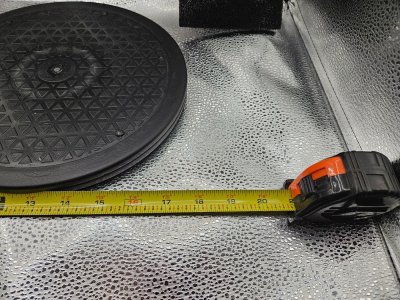

I picked up this spray booth at Ama$on. I chose it primarily because of its size, 24" (610mm) wide x 16" (406mm) high x 16" (406mm) deep. The price when I purchased it was $80 US. It's a little flimsy and I'm neither endorsing it or panning it, but it works for me.

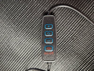

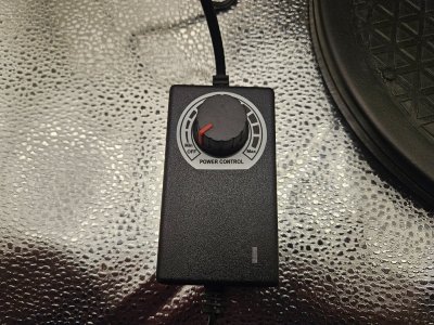

It has two 5" exhaust fans with speed control that plugs directly into the mains (the polarity of the wiring was reversed, so I had to turn the fans around - no biggie), a turntable and 2 LED light rings with a 3 step temperature control and a 10 step brightness control. This is powered by USB. They provide a 1 amp charger and I found that you only get 8 steps of brightness. A 2 amp charger gives you 10. There is a pack of 6 filters (only 2 used at a time. It also has a screen that drops down to cover the front. I'm not sure what it is really for, but it keeps the curious cat out.
Everything is held together with velcro. It's a little wobbly, but it works. I can't obviously fit the Oseberg into it, but the suction of the fans keeps spray headed into the booth if I spray right at the front opening.
Color temperature/brightness control and different effects (as best as my camera can pick up)...
Fan speed control...

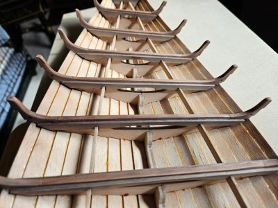

I first sprayed the bitis with black. The nice thing about the airbrush is the amount of control you have with color. The more you apply, the darker it gets, but not so quickly that you lose control.
Then I sanded with P320, slighly rounding the edges and creating highlights.
Finally, I sprayed walnut over the top. Here's the result...
