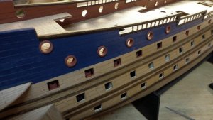

Latest:
False treenails. Made holes with 1mm bit. Sanded 1000 grit. Wipe dust off dry towel. Painted with Polyurethane satin no gloss. Sanded again with 1000 grit. Painted with Polyurethane satin no gloss. The gloss that you see is that I just finished painting. When dry, boards look dull.

Thank you every one for your kind words. I was able to do a lot on the San Felipe this afternoon making the other side treenails and some other touch ups before I move on to the next part.
Donnie

Nothing major, just installing the lower wales. Yes, with treenails this time.

Thanks every one. Well, I learn from here and still learning.... so, heres the latest. Finished one side of the lower wales and stained them. The walnut 2x4 is very brittle and kind of hard to work with.

yep, I have come across similar comments about the ship as well. With little or no documentation it is really difficult to make it as accurate, but I can live with what has been done so far. The latest is installing the round Gun Port Frames.
