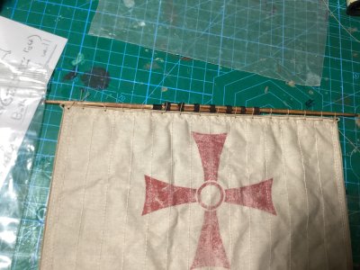

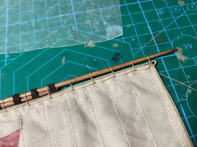

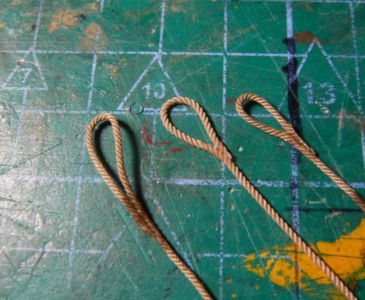

Ok - finished roping the foresail (spar shown for reference) ...

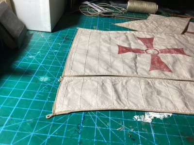

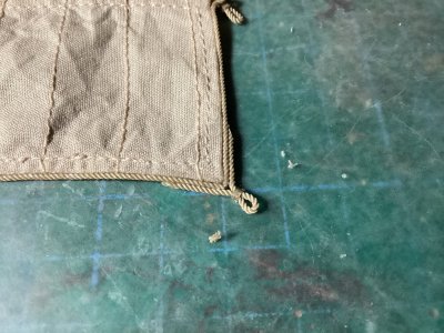

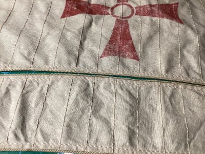

Working out how to make the main sails now - no instructions.
Here's the plan. With no reference to there being 2 mainsails.

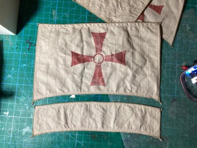

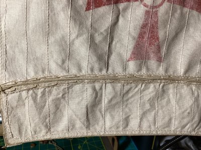

Here's the kit mainsail on the left - showing a line drawn where the 2 mainsails would meet up. And on the right, the 2 new mainsails.
What I need to determine, is how to mate up the 2 pieces of the mainsails?
- Glue the mating edges together.
- Stitch the mating edges together.
- Glue ropes to the mating edges and glue the mating ropes together
- Glue ropes to the mating edges and stitch the mating ropes together
- Glue ropes to the mating edges while also putting thimbles in the mating corners - and stitch the mating edges together while also strapping the thimbles to each other at the 2 mating corners.
