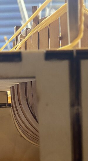

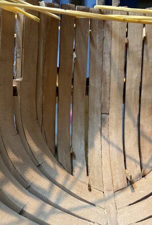

It’s been a while since my last update. Received the wood for the planking of the inside of the hull. First made the limber strake after this it became a real challenge.
It took 2 attempts to come to a acceptable finish. Learned a lot from this and hope that the next time I will do a better job.
