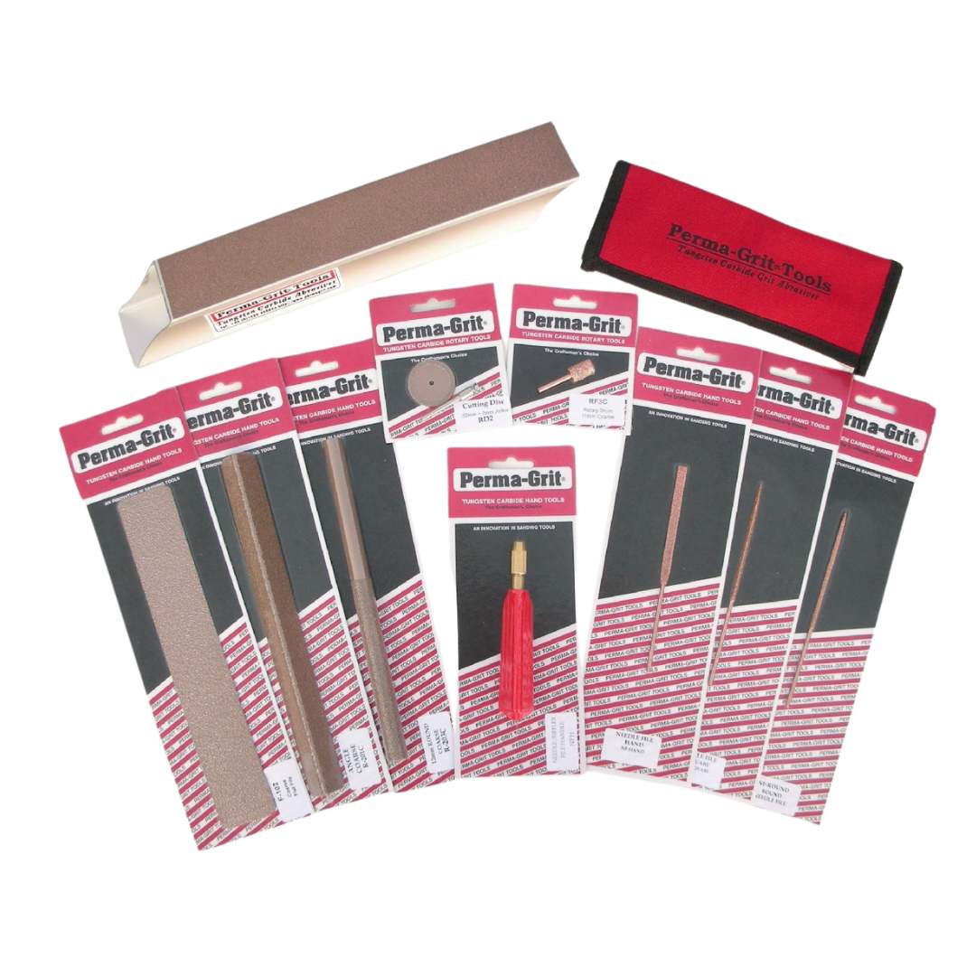

Also my tool order from Micro Mark of new set of Permagrit Files came in today
Very good tools - What I can highly recommend in addition to your Permagrit tools are the small ones
I am using these Riffler and Needle Files -set very often
