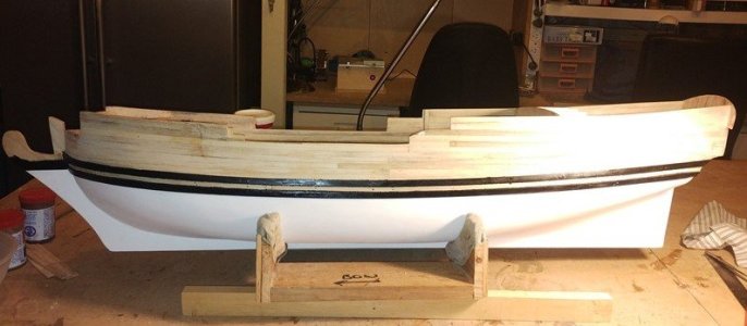

Royal Caroline Box wood edition 1/30 scale modified to fit carvings, build by neptune,
Quite a difference in lenght of the hull John if you see them next to each other.
Regarding repositioning the top wales and frieses it gives the model a much better appearence.
Thank you Maarten, hopefully mine will look as good as yours, I won't be double planking the hull like you did, just painting it off white, and I'm going to leave the carvings as Box Wood with the clear Beeswax finish, thanks for all your help with the info and the help of your build logs,
Best regards John,
If you have not yet installed the gratings, something to consider: Cut the gratings as close to the size indicated on your drawings BEFORE you make the head ledges and coamings in which the gratings sit. Then make the head ledges and coamings to fit the grating, not the other way around. The battens should run fore and aft and there should not be any openings in the gratings next to the head ledges or coamings. Pictures and a 1000 words, &c. follow.

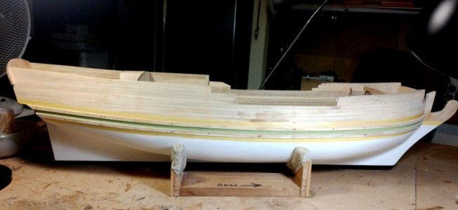

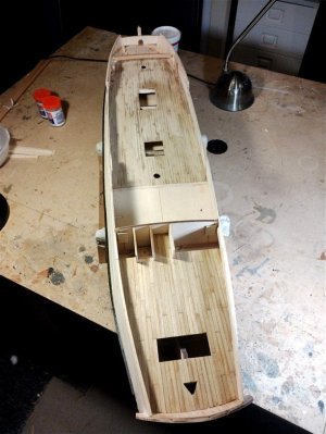

Thank you Allan, I haven't done the fancy corners but I have got the battens the right way around and also a little bit of round up on them,
overhead view,
end view,
after one coat of off white undercoat, The Royal William waiting patiently in the background,
Broadside view,
thanks for looking in,
best regards john,

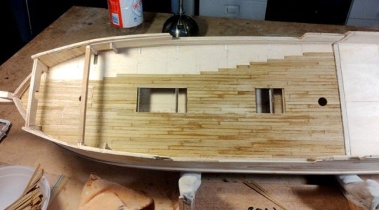

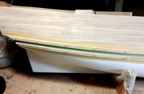

decided to have a break from the Royal William and do a bit more to the Royal Caroline, I decided for quickness to use the planks supplied in the kit, will give it a good sanding when its fully dried,
and finished the after deck as well.
best regards John,

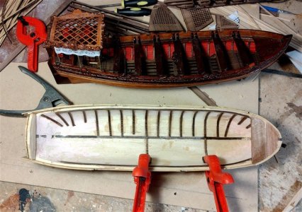

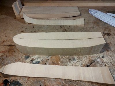

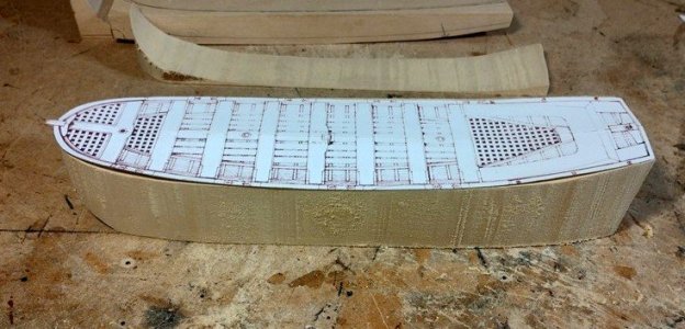

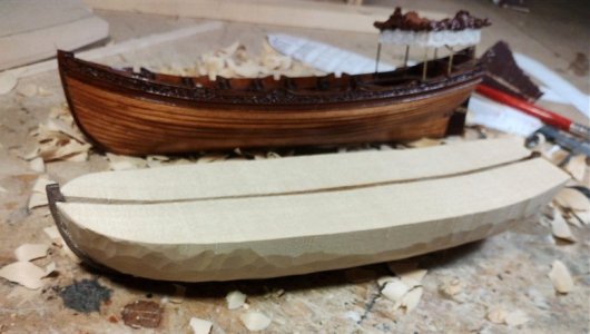

I stuffed up getting the frames off of the mould for the ships boat, so I decided to make another out of a block of Jelutong

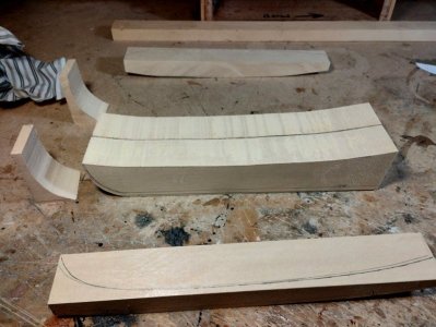

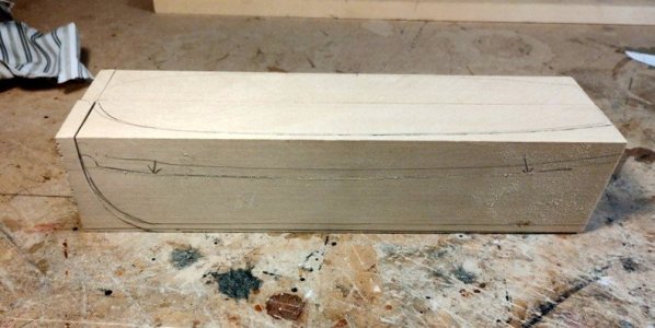

I marked up the block with the lines that I wanted tocut out,
This after cutting the top to shape and also the bow and transom,

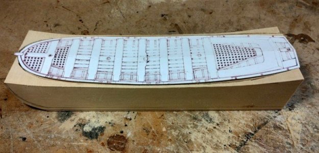

marking out the plan shape,
and after cutting to shape,
just checking for size,

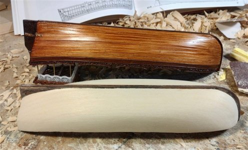

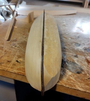

adding the keel stem and stern post I will glue the other side after, this boat will be carvel built, above it you can seethe ckincher one that I made for the other RC I had built,

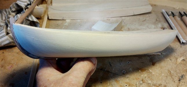

and finally starting to carve the boat,
and another view looking down on the top of the boat,
thank you for looking in,
best regards John.

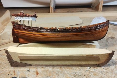

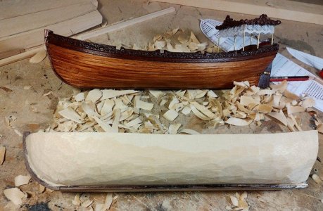

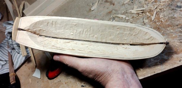

port side just about finished, just have to take some more away from the transom area,
port side,
carving the starboard side,
both sides finished,
a view with the clinker boat behind,

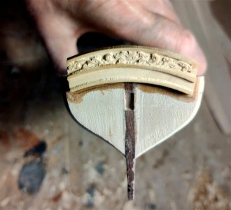

transom decoration board attached,

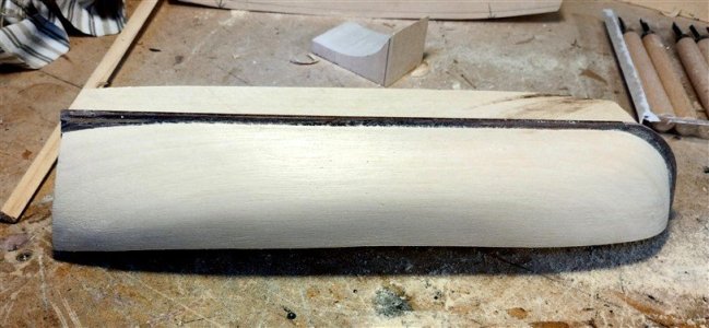

now this is the delicate part, carving out the interior, to be continued,
best regards John,

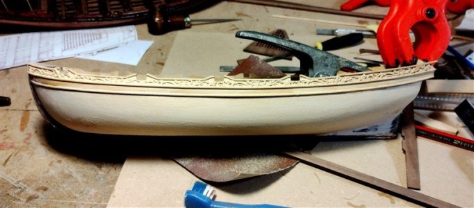

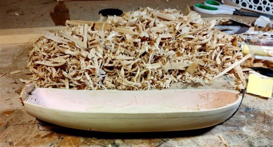

after carving out the interior I applied some filler at the bow and transom just to smooth out the grain at the ends of the boat, behind the boat you can see all the shavings that came from the exterior and interior,
applying the ribs etc,
and attaching the box wood carvings along the topsides,
bit of a clearer view,
and after painting the interior and applying the bottom boards and the gratings,
best regards John,

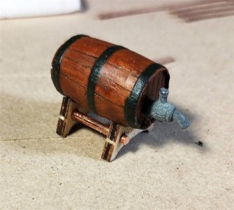

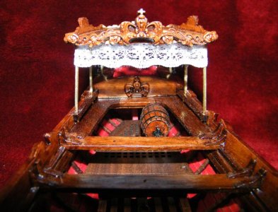

these are the parts for making the keg that goes in the launch,
I have already made a lot of barrels large and small for my cross section models, so I decided to use one of the smaller ones for the launch,
I'm going to shange the tap for a smaller version as it is too large, but this will be the keg on its stand,
best regard John,

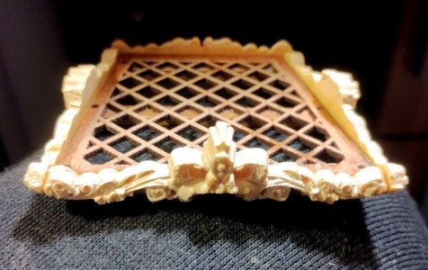

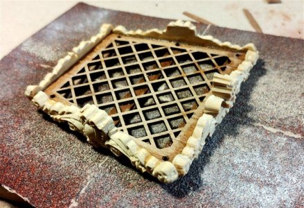

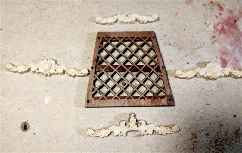

whilst waiting for the glue to dry on other parts I decided to make a start on the canopy for the back of the launch,
the parts above are the basic pieces, I added some reinforcing pieces across the trellis to reinforce it like I did with the previous Royal Caroline that I built, the other four pieces are the Box Wood carvings for around the trellis part,
after attaching the carvings,
a front on view, on the previous Royal Caroline which had Pear Wood carvings, I applied a Rose wood beeswax polish, I am uncertain whether to apply a clear bees wax polish to these ones or to gild them instead,
this is how the canopy is attached, this is the pear wood version that i built,
and a view showing it polished with the Rose wood beeswax polish,
best regards John,
